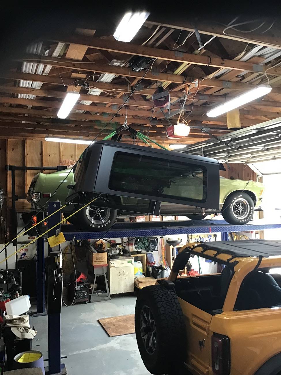

Harbor Freight electric lift, and some nylon straps. The trick is a done!

2 questions:
Do you store your panels up with it?
Have you had any issues deforming the window seal?

I store my panels separate in on the ground in the bags. And I use a small section of a pool noodle to prevent window seal deformation from the nylon strap.

This is exactly what I did, along with the rest of the top panels. Harbor Freight Electric Winch with two 10 foot straps. In the winter I put my soft top on a sheet of plywood and hang that from the hoist. Lemme know if you want a pic?

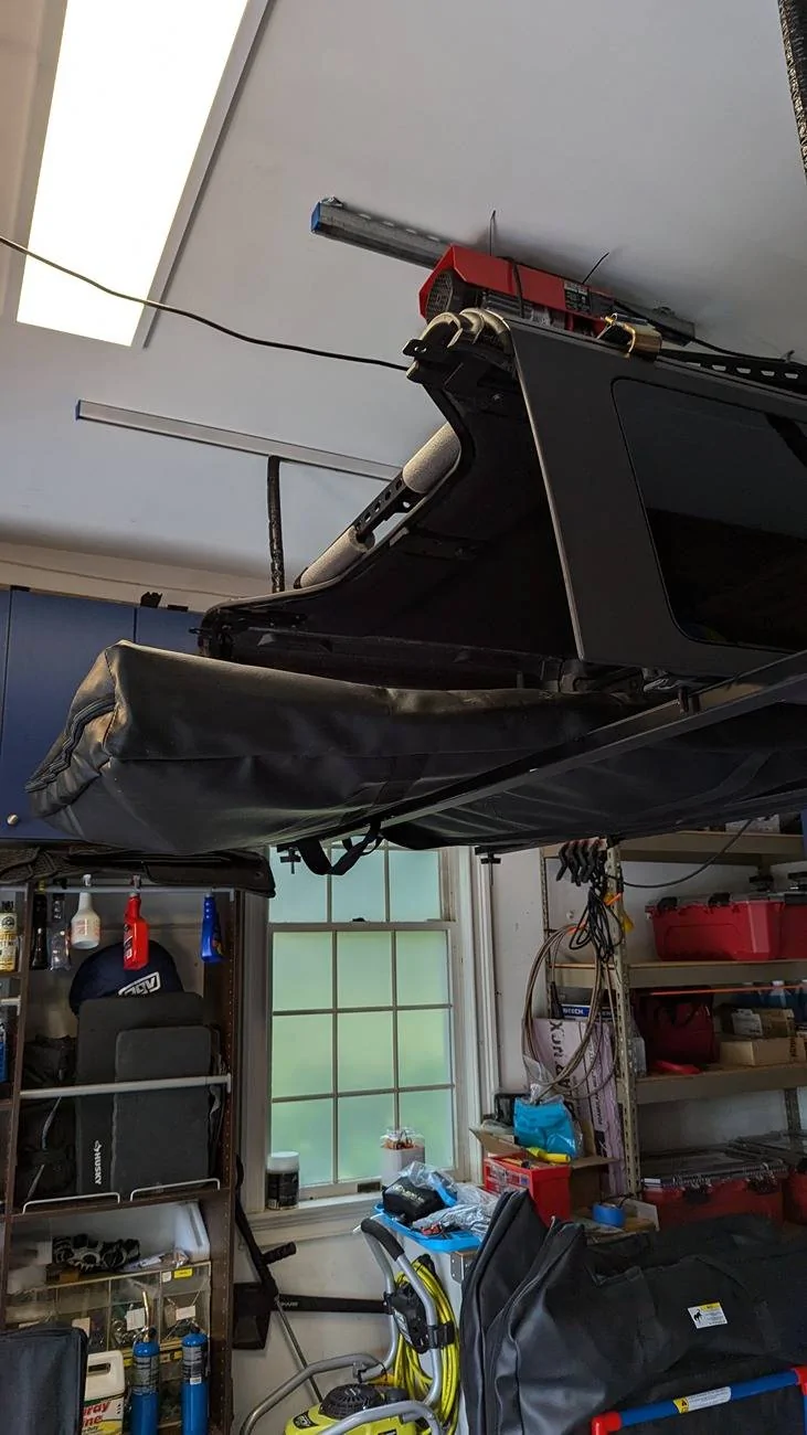

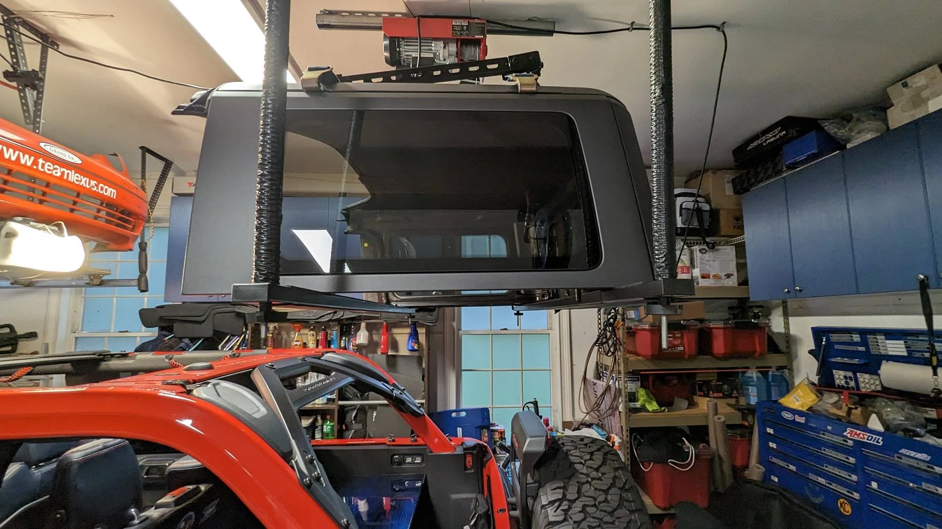

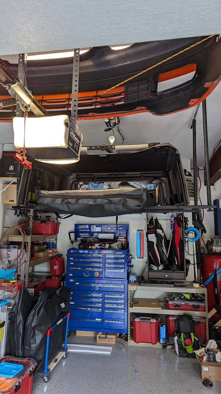

Harbor Freight hoist with a custom lifting basket, then supported by a floating shelf to take weight off the actual hardtop.

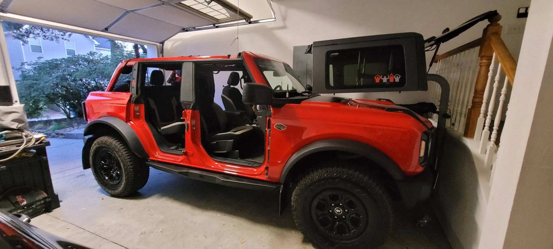

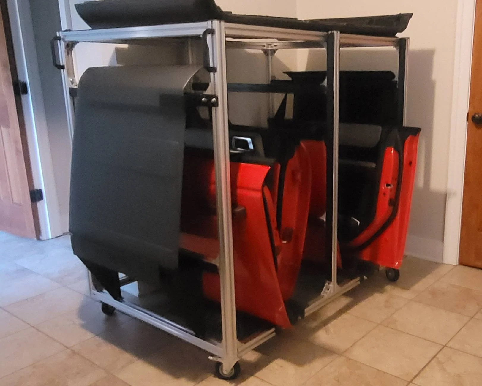

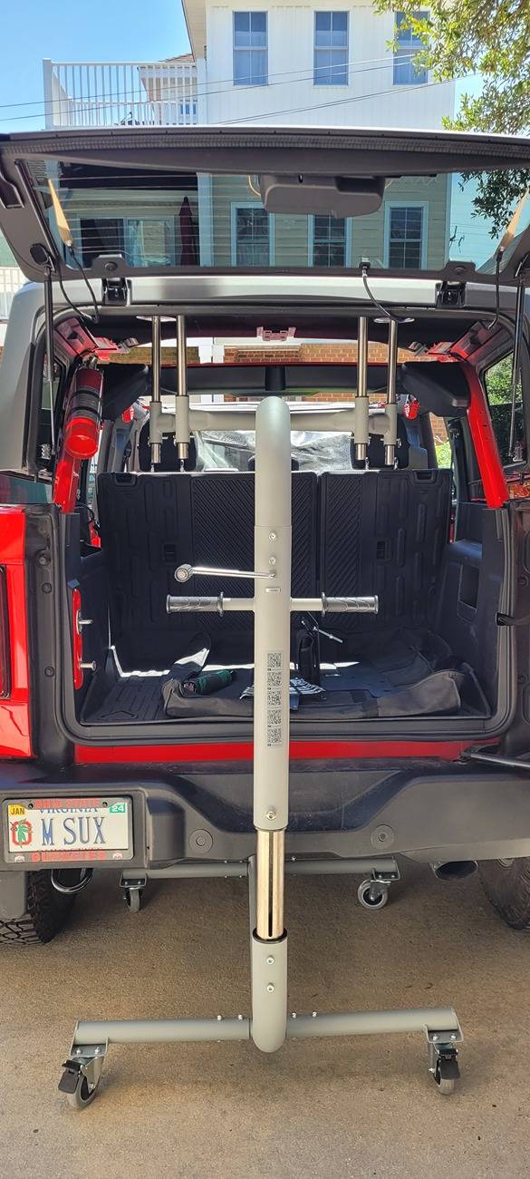

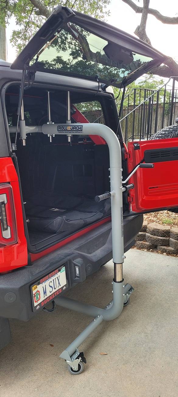

I went this route:
Roll-N-Jack for the back and Hooke Road cart for the rest:
