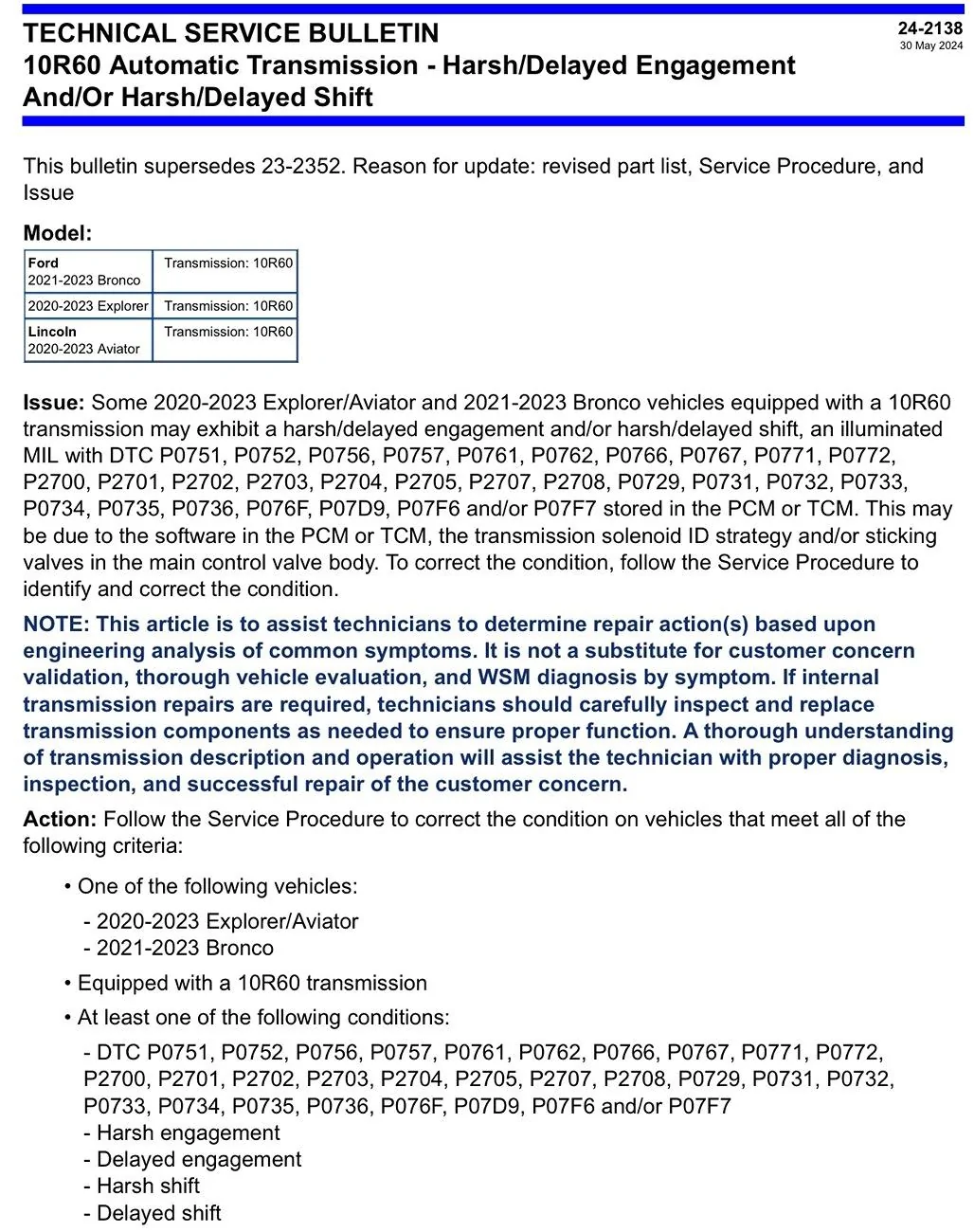

Personally if one of my customers had a similar concern that I was able to duplicate it, I would check to make sure the PCM is up to date and then more than likely perform something called an accelerated main control break-in procedure. In my experience that usually tends to fix a lot of intermittent odd shifting and engagement concerns.
It's basically doing the same thing the TSB outlines, just in this case it would be a normal warranty repair instead of a directed repair.

Update on my hard shifting problem. Turns out I have a bad transmission valve body with only 5K miles on the odometer. Luckily the tech was able to replicate the problem because it doesn’t happen every time the truck shifts. For those with a similar issue but the TSB procedure doesn’t seem to work, I would push them to consider the valve body.

There’s a TSB for various shifting issues that the dealership should’ve done. If they didn’t, I would bring it back and request that they do it. The main control break in procedure does a great job at fixing small shifting issues usually.
