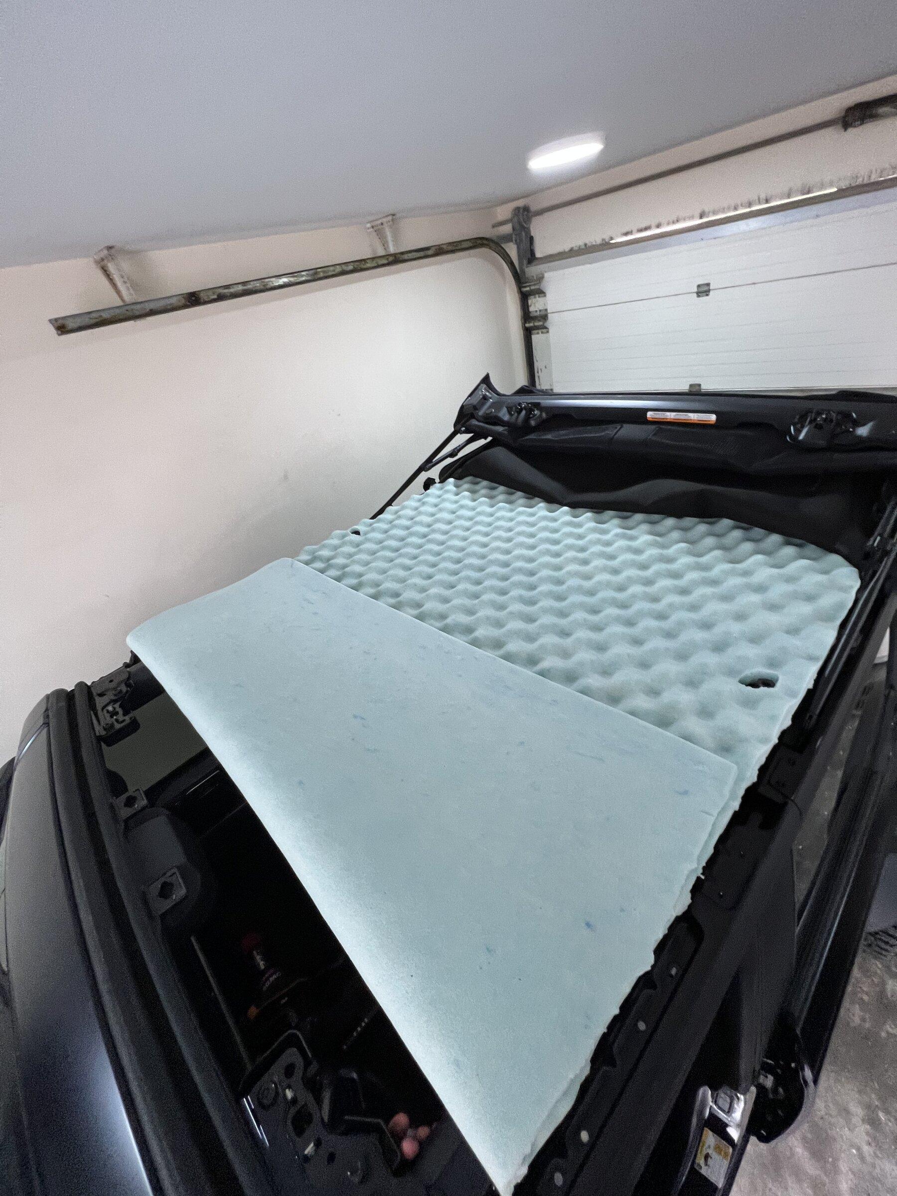

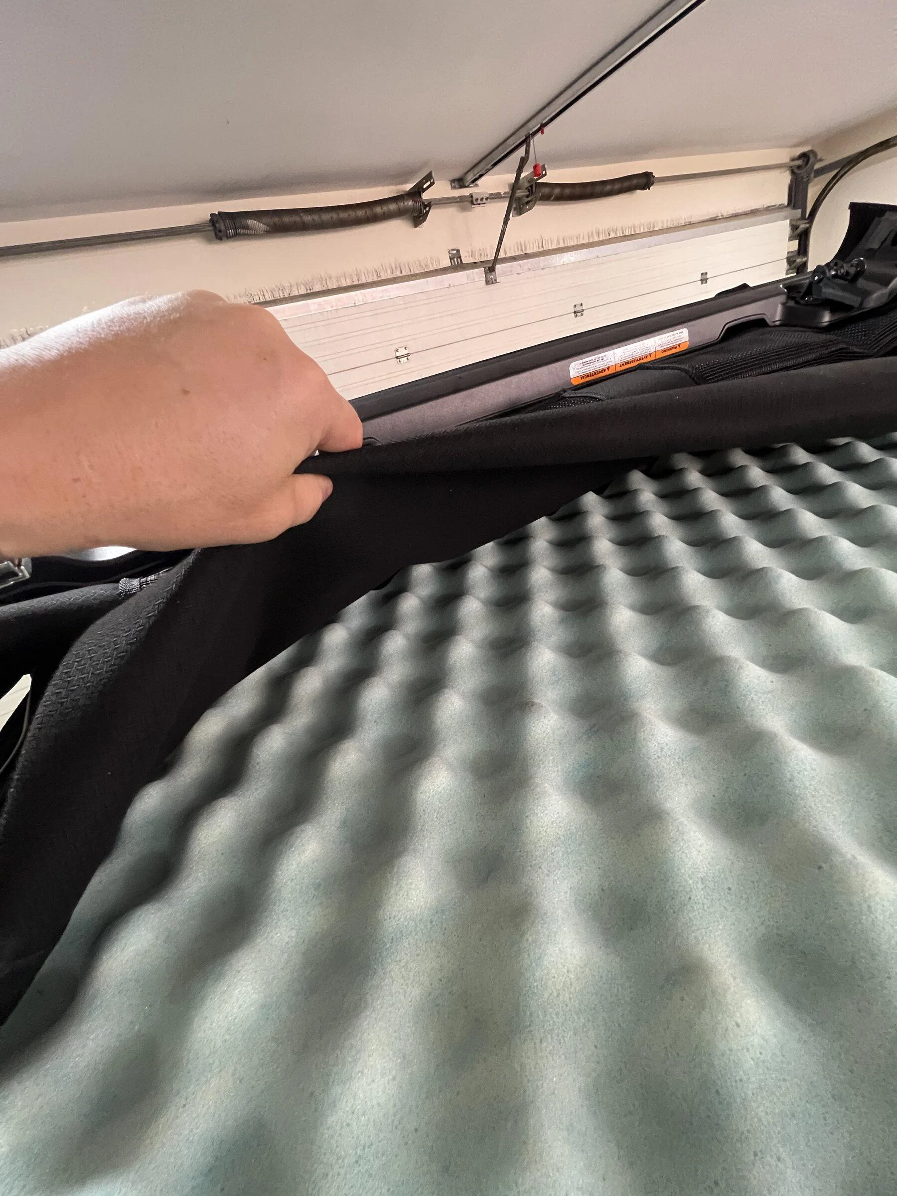

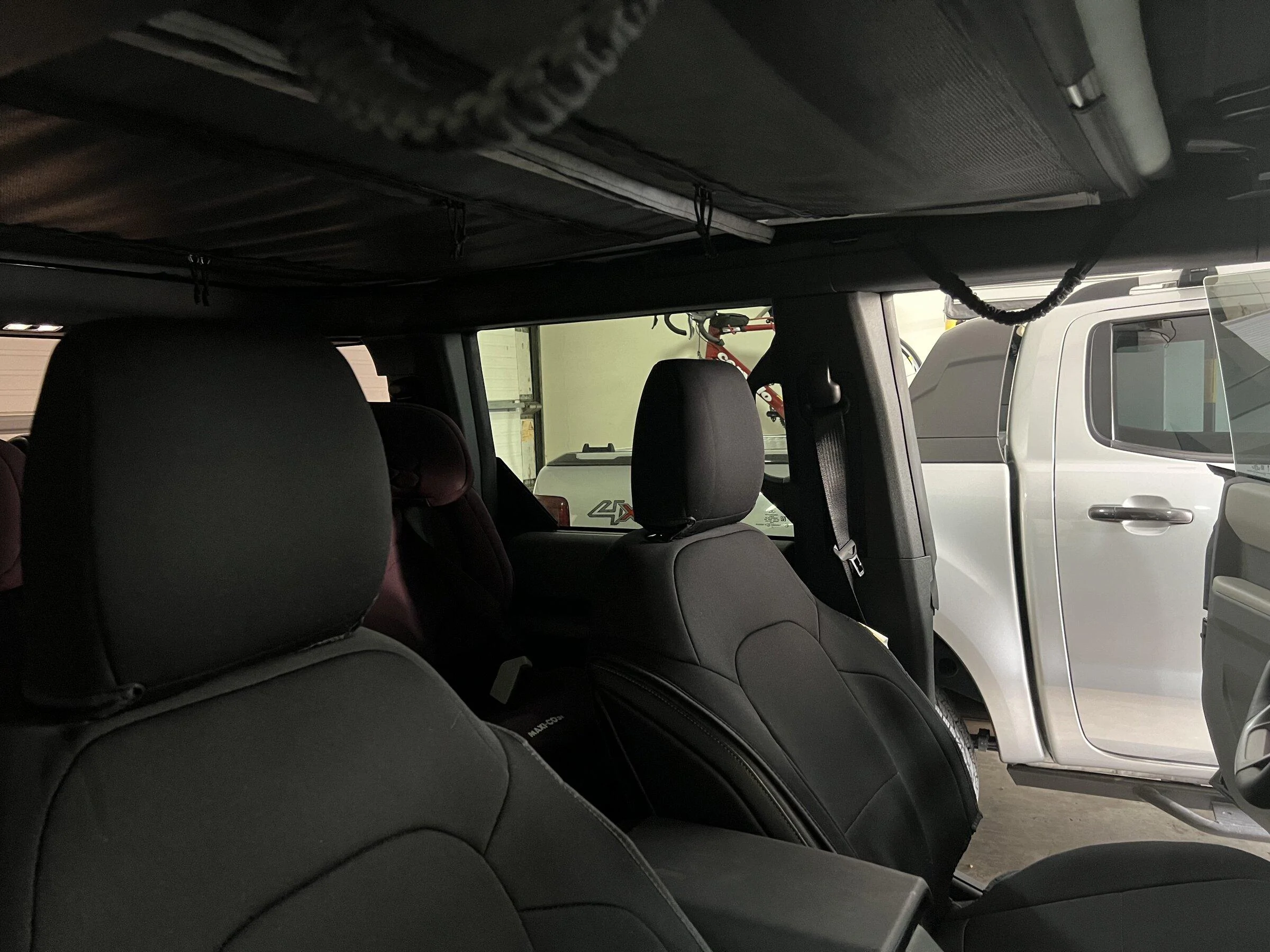

Amazon... https://www.amazon.com/Cooling-Mattress-Airflow-CertiPUR-US-Certified/dp/B073JVPPWF/ref=sr_1_2?crid=5UIGUB23H8&keywords=Zinus+1.5+Inch+Swirl+Gel+Cooling+Memory+Foam+Mattress+Topper&qid=1653901926&sprefix=zinus+1.5+inch+swirl+gel+cooling+memory+foam+mattress+topper,aps,1219&sr=8-2
Opted for one with bumps on one side for sound dampening - not sure if it makes any difference as compared to a flat topper but it definitely works really well (bumps facing up). Just made sure it was cut as wide as possible to be snug against the trektop's hardware and sit on top of the roll bars (sides and c pillar) - had to cut out a small hole on each side for the rubber stopper on the trektop's center bracket, but otherwise just straight cuts. Obviously not possible for the foam to extend all the way to the front, so cut it flush with the bimini when the front bit is clipped back (didn't have any wind noise from the header section anyway so this is fine).
The difference at 87mph (the speed limit on a lot of the highways here) is huge, and well worth the little bit of effort each time. Haven't tested over a long period though, so not sure about durability - hopefully fine.
Is it possible to see a photo of the setup?

Plus I folded back the excess at the front rather than trim it… no reason other than it was hot out and I ran out of steam…. Still works great. Genuinely a massive difference in wind noise.
