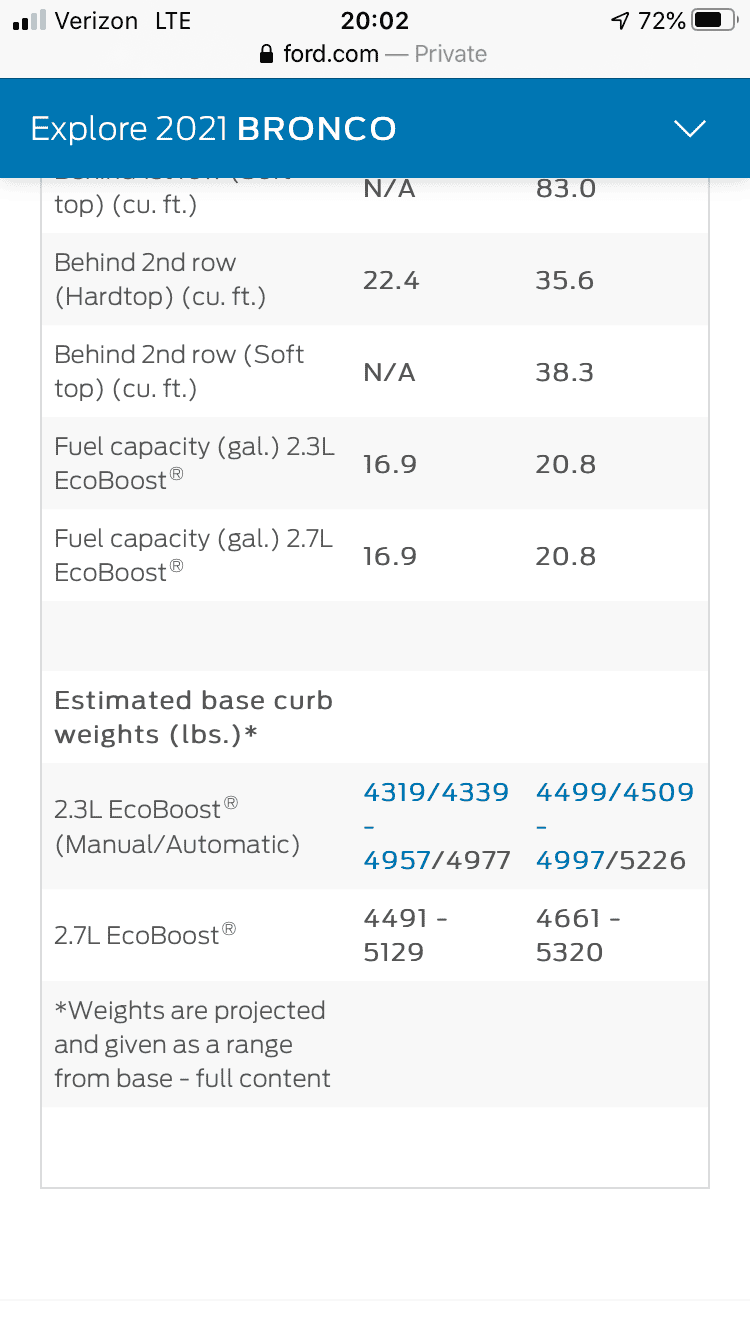

All I really have to go by is this
Ford Bronco GVWR and general weight concerns 3CAF1C2C-6612-4635-A3B2-F5C47D5B58FA
so assuming that is a Sasquatch Bad Lands it’s going to be right around 5129 because I can’t think of a heavier configuration. So if 6 it is yeah a BL SQ and FE 680ish Wild tack not far behind. But who knows it’s all up to ford maybe it’s 5800 for 2 door and 6000 for 4 door.
Yeah, I hear ya. I think that spec listing is all any of us have to go off atm. It's definitely a concern for me. I'm definitely all in on getting a Bronco, and I can look past a lot of the stuff other people have raised concerns about. This weight issue, though, could be a big issue for me.
