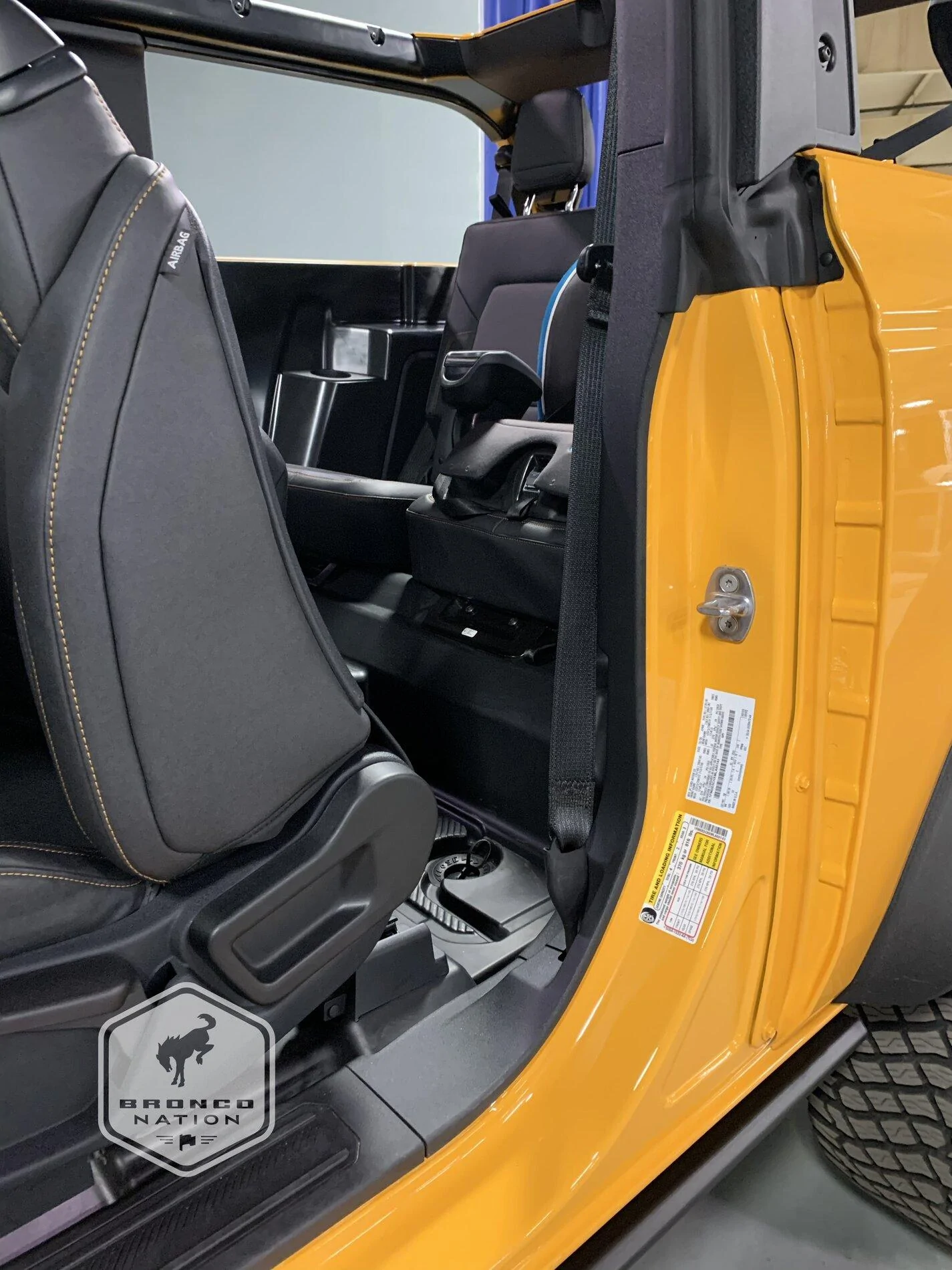

Posted this over in the towing thread but thought it might fit here for those interested door sticker says 816 for payload.
From the car seat thread https://www.bronco6g.com/forum/threads/child-seat-installed-in-a-2021-bronco-2-door-photos.8967/
It’s a 2 door badlands looks Sasquatch payload 816. I know it’s not the exact configuration but if GVWR is in fact maxed out at 6k to stay in class it looks like 5300 curb for a 4 door is a pretty safe bet. Just wish I could read the other sticker.
Wow, That's pathetically low. Good catch. So 4 door with the same suspension would be similar or less correct? That really could be the reason the roof rack isn't offered.
Honestly I have no idea. I personally think that it will be a little less as I think the GVWR is artificially capped at 6K by Ford to keep it in the same class as a Wrangler and not a representation of its true capabilities. I really wish I could read the white sticker or I could find a 4 door one. Maybe someone with some skills can enhance the white one?
Someone posted a spec sheet in another thread that listed the payload for the 4dr at about 200lbs more than the 2 dr.
If the payload for the 4 dr 2.7 BL, that would decent. The payload sticker on my Edge says 950, and I've never experienced a catastrophic failure with it. Yet.
