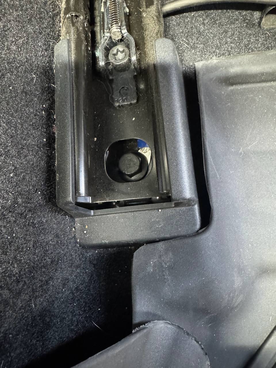

I placed a small powered sub under my drivers seat on my 2D BB. I removed the trim just inside the door jams, and drilled a self tapper through the floor. (It appears to be boxed in, so no sign of the elements reaching it from the underside). Used the Dremel to remove the paint for good contact. Replace the trim, tuck the wires as necessary. Amp and speakers work flawlessly. Love the added bass! Good luck!
I’ll try it, thank you!

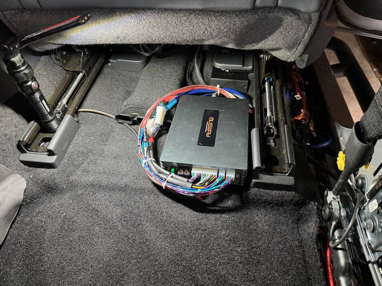

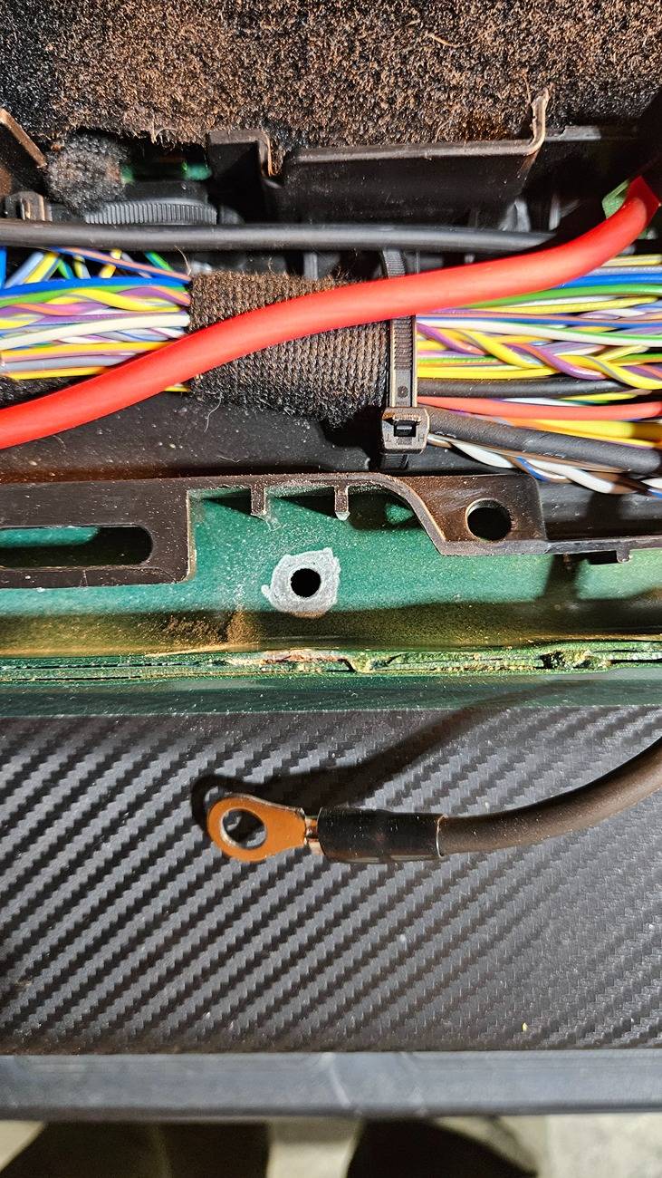

I grounded my DSP under the passenger's seat to the LH rear bolt securing the seat.
I tried grounding it to my driver side front left seat bolt and I’m having issues with the tweeters suddenly not getting enough power ever other time I turn on the car have you had any issues like this?
I have had zero issues.
