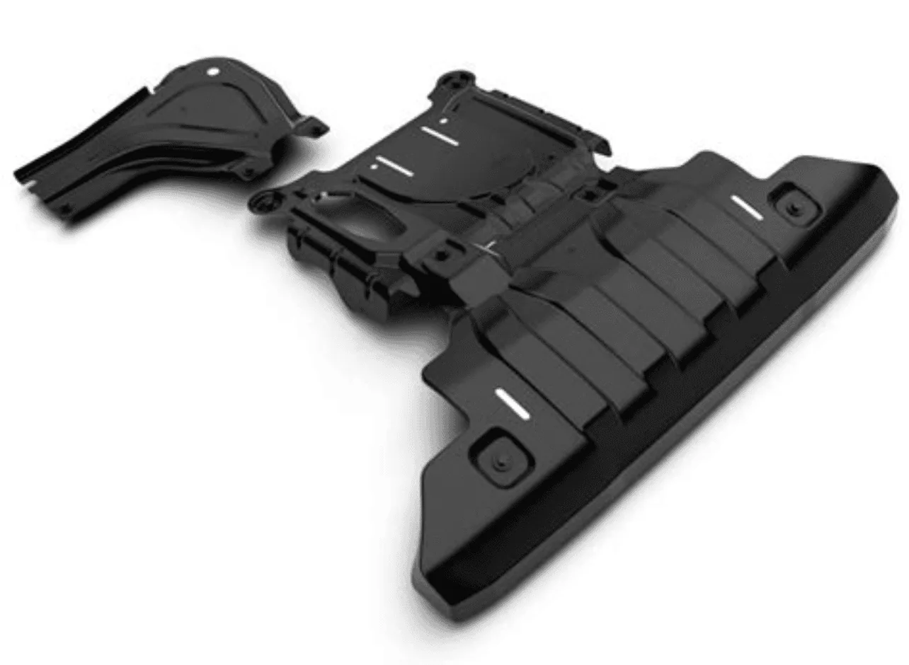

I'm pretty sure you just get this-

Is that just 2 pices?
It's a 3 piece kit. Ford part number MB3Z-5D032-D This is for a two door. (Mine) But you get the idea. Not exactly "full" more, full of weaknesses.

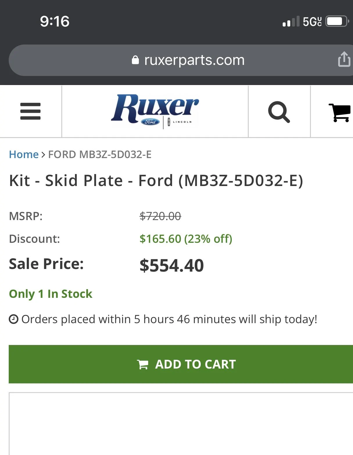

Website said still one in stock so hopefully it updated properly. On sale again I just ordered a set for the four door.

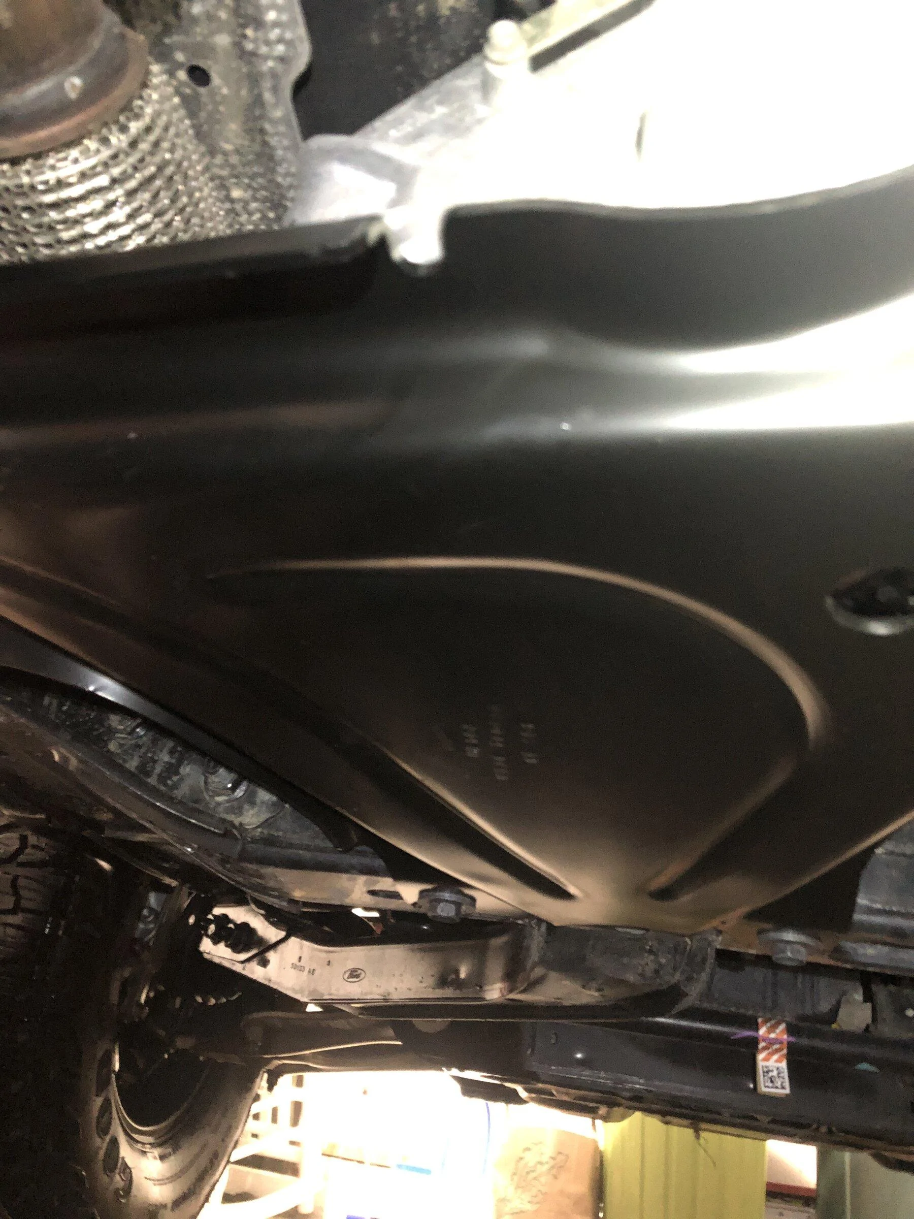

The gas tank skid is no joke it’s very stout. I did what carryon did and tied up the tank. I did do the install with hardly any gas in the tank to make it easier but it probably didn’t even matter because the tank is tied up with wire. If anyone goes to install one here’s another tip. Get the skid plate under the bronco close to where it lines up to bolt on. Grab the front half (which is the lighter half) and raise it up where you can get the two bolts in the front. After you get those two bolts finger tight raise up the rest of the plate and finger thread all the bolts in. Go back and tighten them all down. Super easy even thought it’s really heavy.

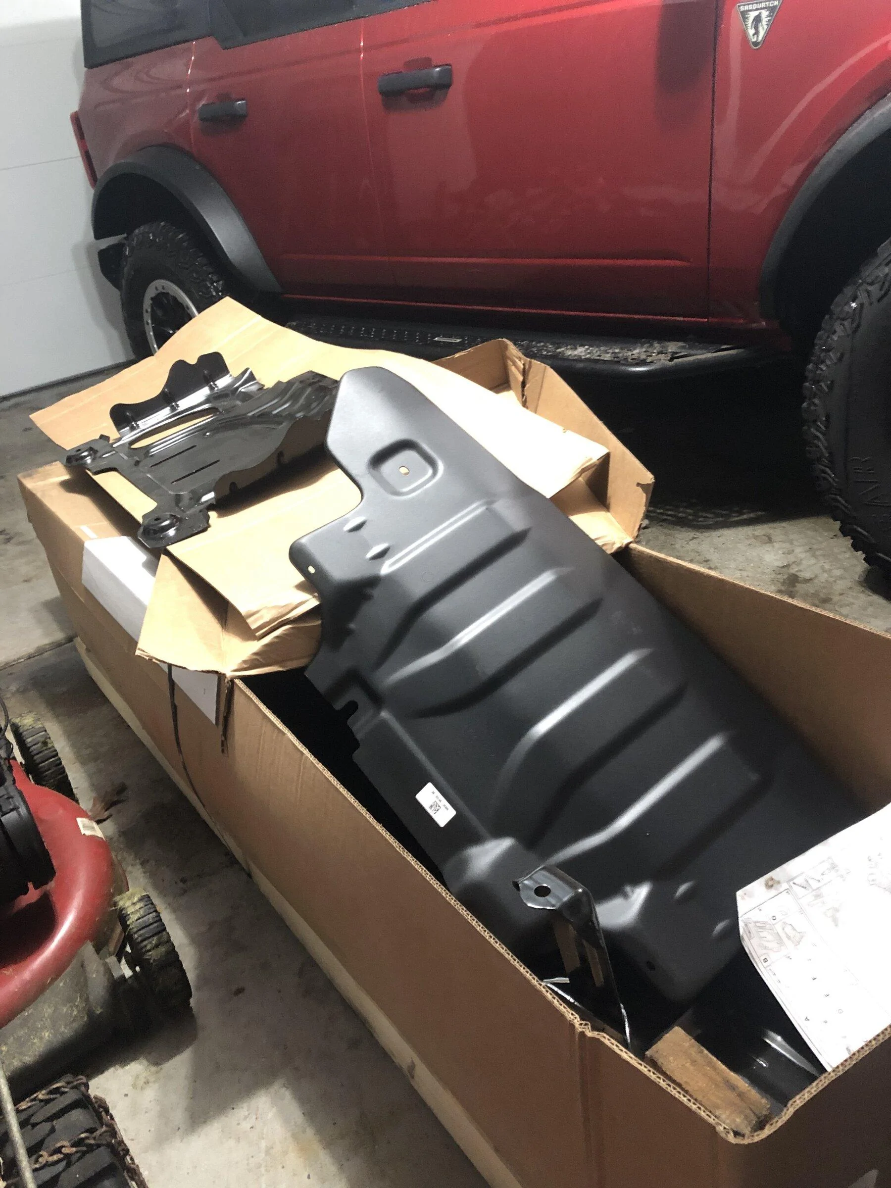

Just seeing this. My Box arrived today with Skids I will install tonight.

Well have all the skids only needed 2 of them. Guess I’ll save the front two as back up. Had fun in the wet and cold dripping snow installing. 😂
Great job! I‘ll bet it was fun with the snow and wet. Pretty tight squeeze for a body under there as well!
I bet you could sell the front skid and the plate behind it pretty easily since so many people will have the plastic stock ones.
