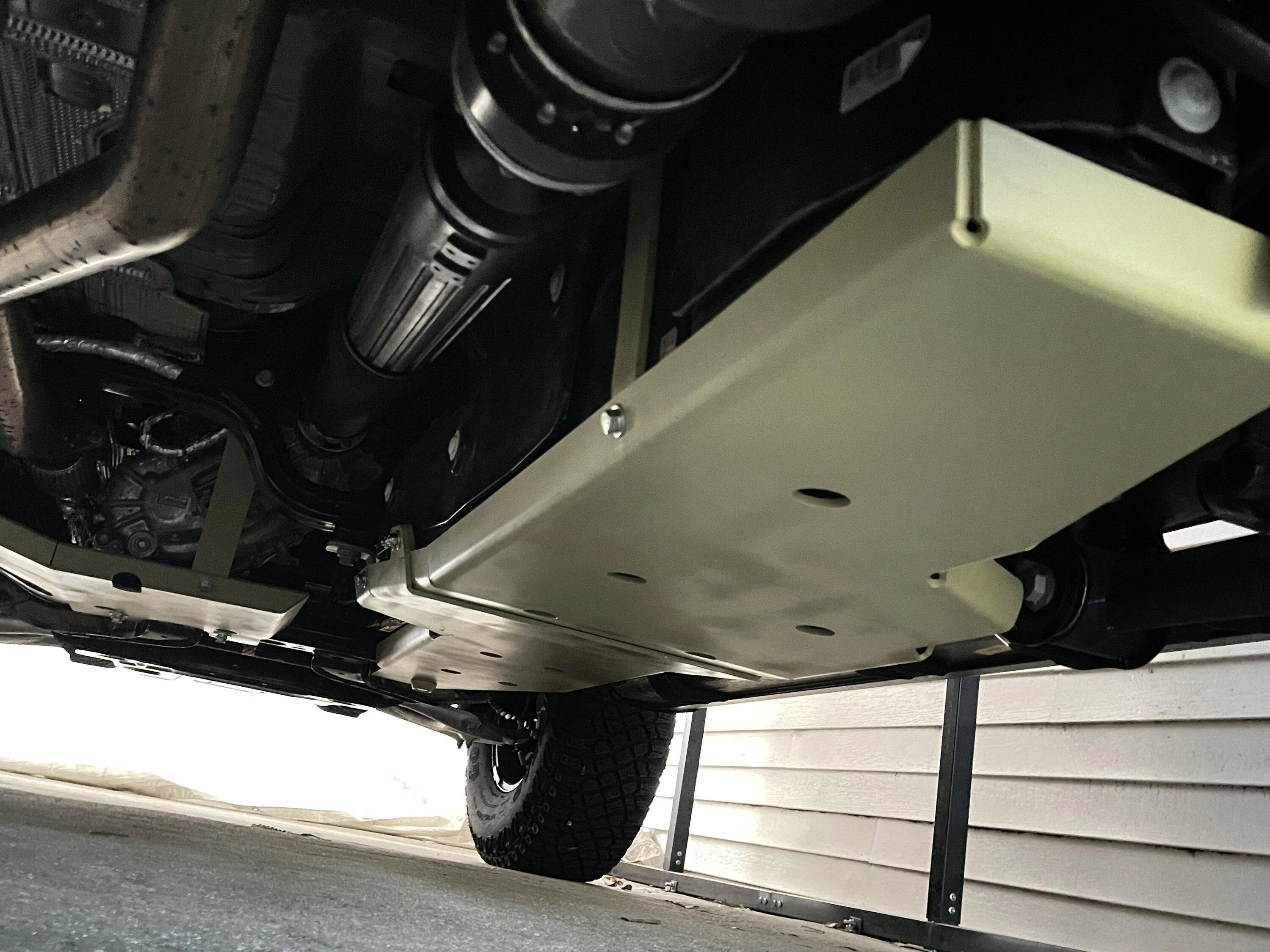

I installed tank skid from ASFIR and it went on over existing tank straps. It was easy. i had only a few gallons of fuel in tank when i installed. You could look at their install video if it helps.
Ford Bronco Gas tank skid 1689774416965
