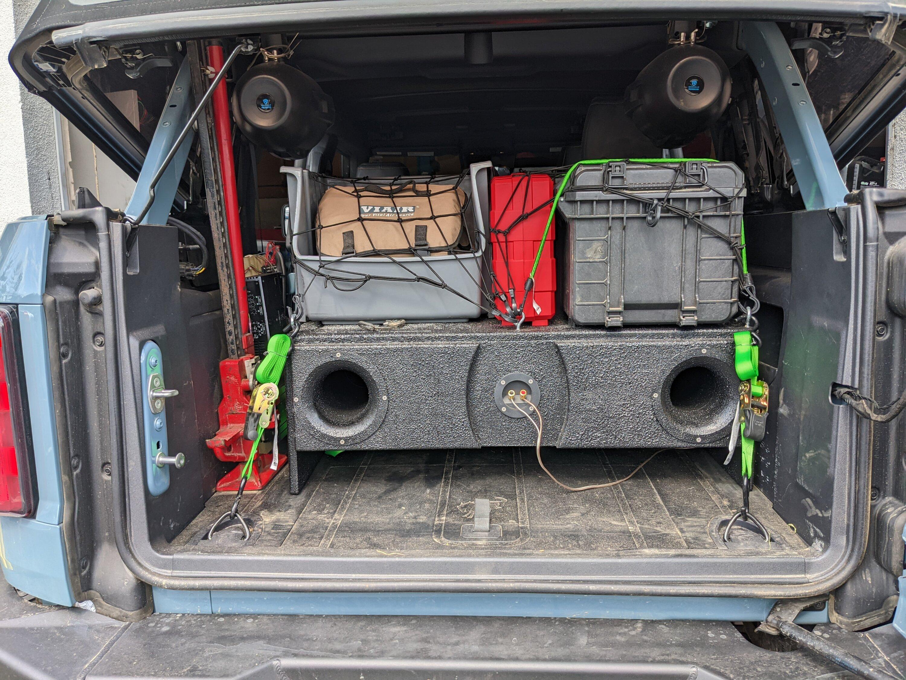

Alrighty, so hopefully this will settle the debate, and provide a repeatable experiment for everyone to use to determine if they have full range to the rear speakers...
My setup is using Rockford Fosgate R14X2 in the dash, Stock Speakers in the kick panels,
In the back I have Rockville RWB65B Wakeboard Speakers being driven by a Kenwood KAC-314
And for Subs I have a custom box made by Elevated Evolutions Custom Enclosures with Dual Skar 10" Subs Driven by a Skar M-5001D Amp. I love this enclosure, Chris made it specifically to my specifications/dimensions, and put in extra bracing so I could carry all my recovery gear and tools on top of it...
Ford Bronco Full Range to rear speakers PXL_20220903_144758764
Check him out and tell him I sent you if you want an awesome enclosure that can shake your bronco.
Both amps are set to where I normally have them, with no filters turned on on the Kenwood, and the Skar is set with a Low Pass Filter at roughly 160 Hertz.
The videos were made using a 40Hz test tone downloaded from Demolandia and played via Bluetooth from my Pixel5a. All ACM Settings except 727-01-02 are at default, and the factory head unit is set to default tone settings with the volume at 18.
This first video is with 727-01-02 at the default 0901
Not full range
The second video is with 727-01-02 set to 0900, and it definitely shows that the Bronco now has full range to the rear speakers.
Full Range
While there might still be a difference with different years, anyone can use this same method to repeat the experiment, and find the right setting.
