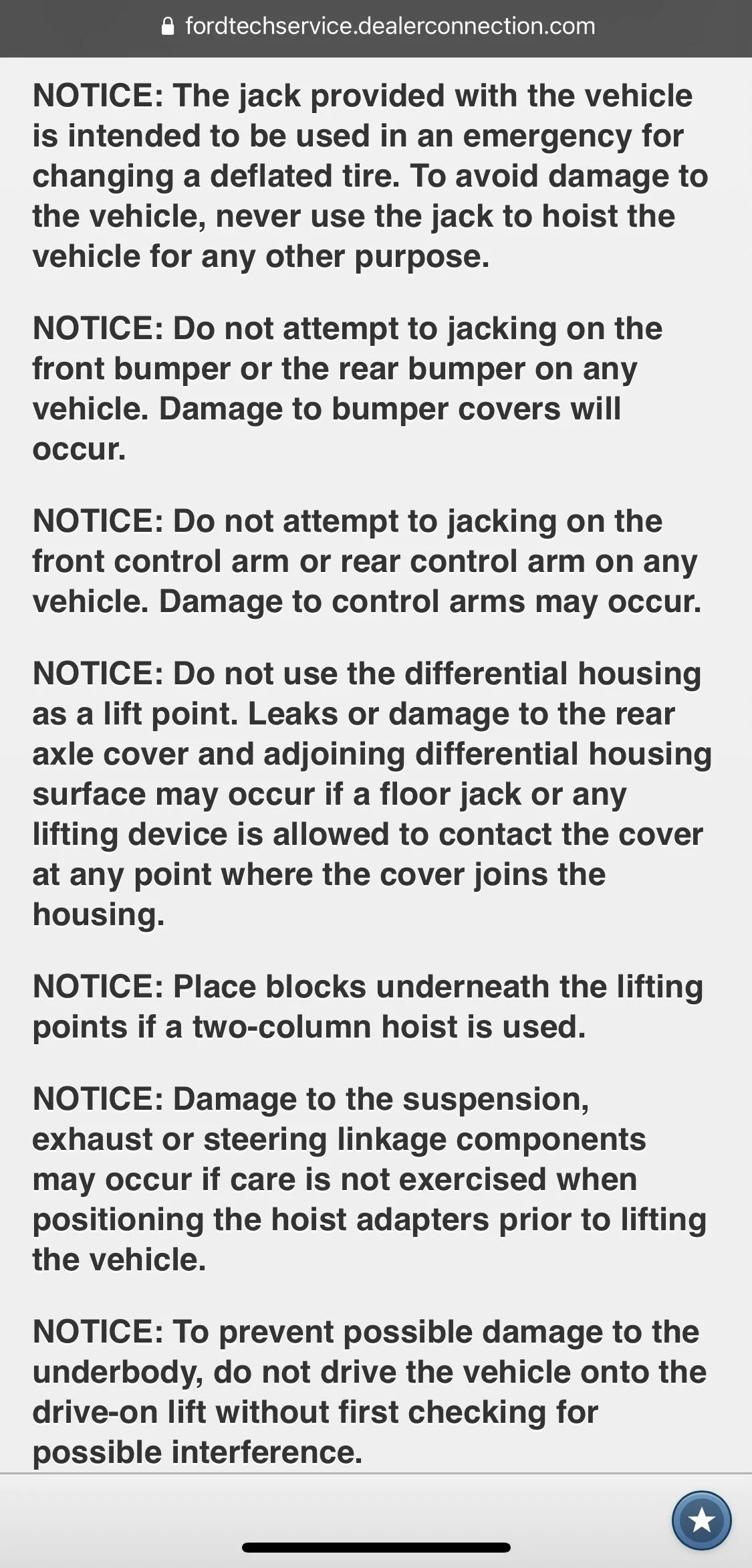

Ford says not to Jack it by the control arms because of potential damage. I’m sure they say this mainly from a liability standpoint, but just throwing it out there.

No problem man. Like I said just throwing the info out there, not saying people NEED to follow it. I’d probably lift it by the LCA in a pinch too 🤷‍♂️ Here it is just for reference.
Ford Bronco Front jack point D8FB03C6-655A-48E1-8D82-7780A649A037
