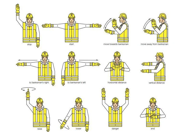

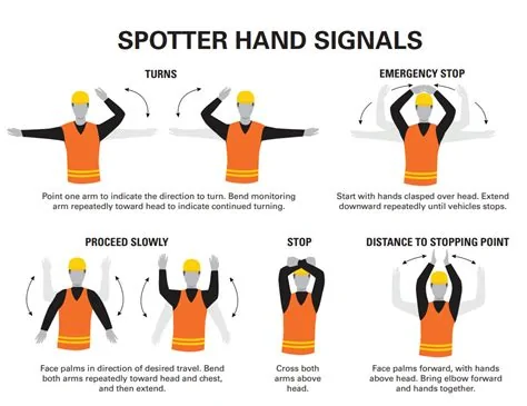

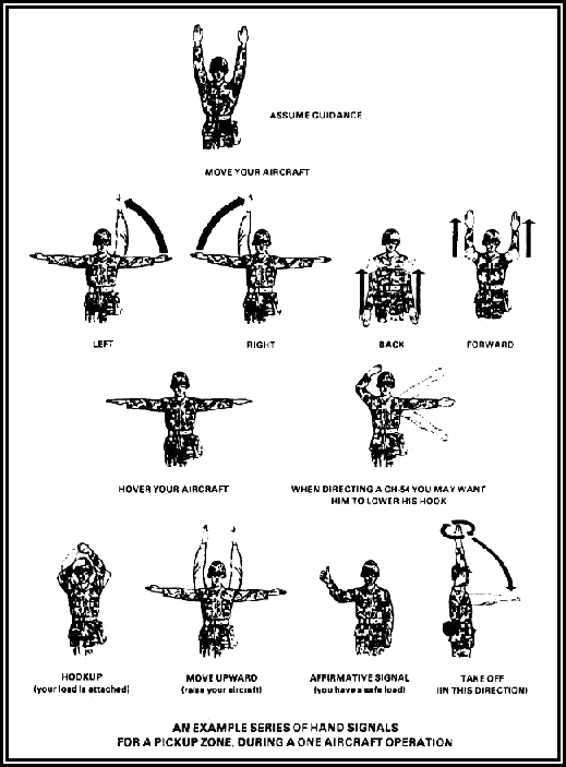

Since we're on the topic, allow me to air one of my grievances pre-Festivus...
If you are acting as a Ground Guide (AKA "Spotter") and you have elbows, you are a complete POS if it looks like you're trying to "tickle" your prom date. The reason you are there is to clearly communicate with the driver of a multi-ton death machine how to avoid life flight, dying, or killing you or other spectators.
Some random online examples:
Ford Bronco Front camera in 2wd? 1000033565
Ford Bronco Front camera in 2wd? 1000033566
Ford Bronco Front camera in 2wd? 1000033567
Yet almost every video I see online has someone practicing for the Sapphic Tech Deck Olympics.
