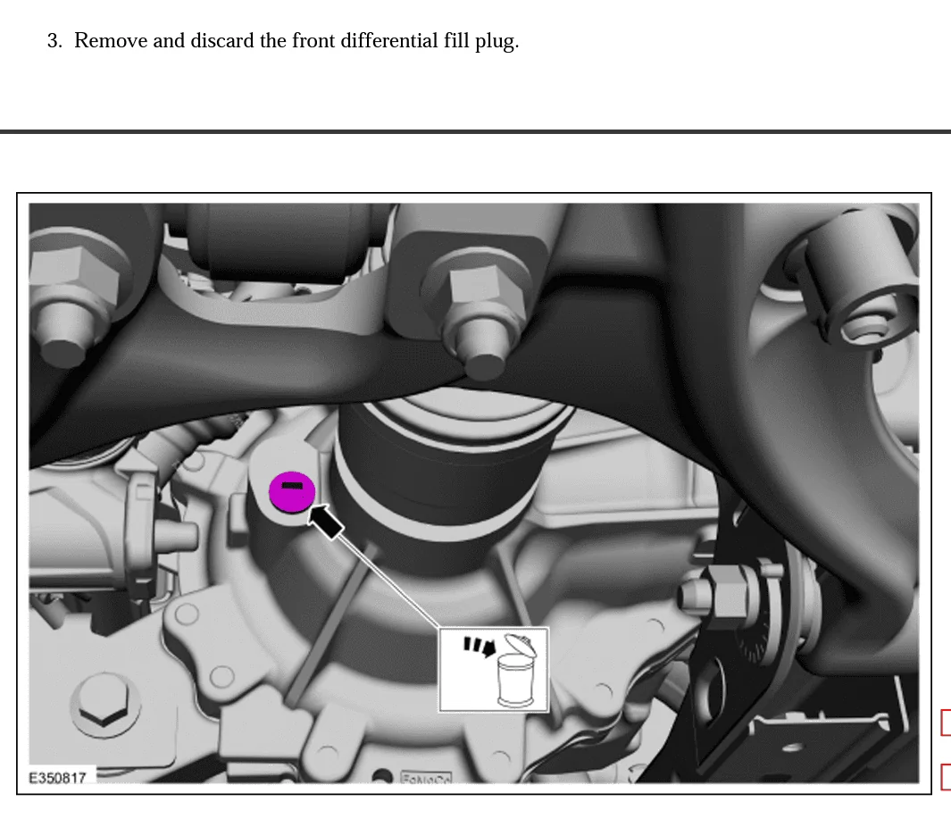

Was browsing the WSM for servicing front and rear diff fluid — it seems as though the fill and drain plugs are single use on the M210/M220 diffs. Does anyone have a lead on where to find those part numbers? My search skills aren’t cutting it.

I’d personally feel comfortable reusing a plug, whereas OEM prefers new fasteners everytime.
Isn’t there a parts list attached to the WSM procedure? From most documents I’ve come across, they tend to have an itemized list
I’ve only seen itemized parts lists on TSBs, not in each chapter of the WSM. They list “Materials” at the beginning of certain procedures but usually it only references the fluid, or special tools needed.

No need to discard the plug. Taken my front out 4 times already. Had a cv axle issue.

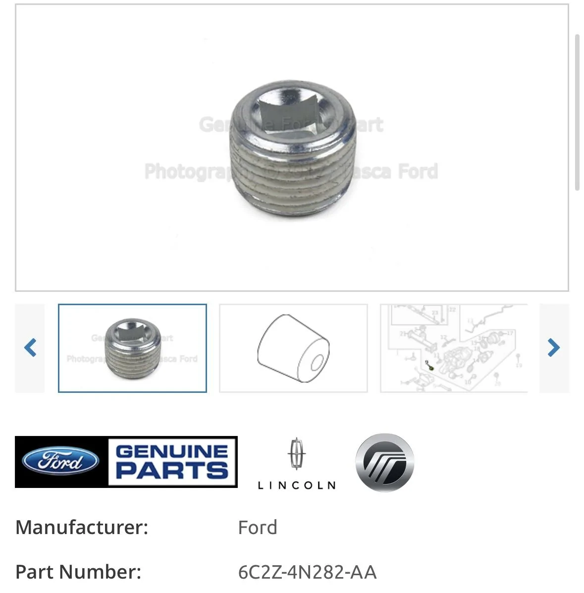

6C2Z-4N282-AA
Double-check me... or ask your dealer's part counter if that is correct. I'm working on a cell phone right now and the dealer parts website is horrific on mobile.

6C2Z-4N282-AA

6C2Z-4N282-AA
Looks correct to me! Even referenced correctly on the parts diagram, it seems.

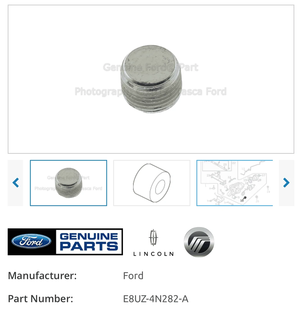

Looks like the drain plug is 6C2Z-4N282-AA but the fill plug is E8UZ-4N282-A as far as I can tell?
