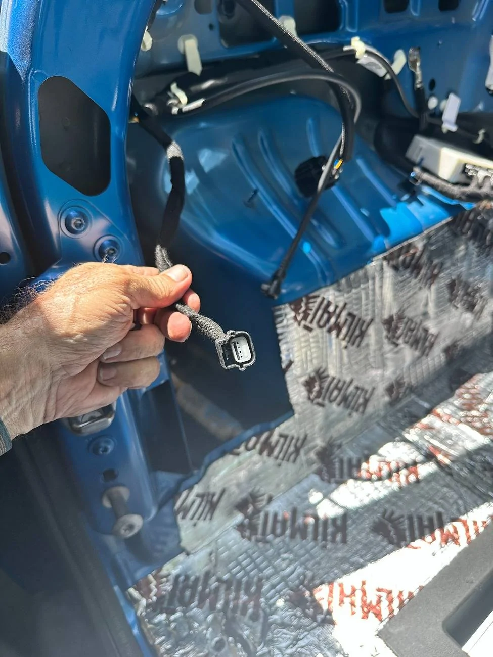

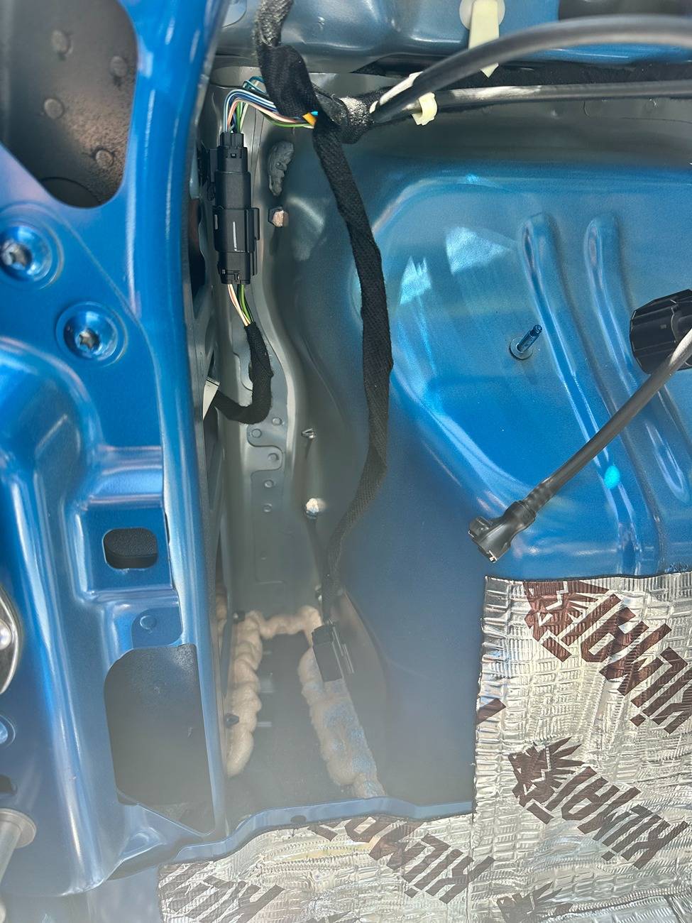

Found an extra wire in rear cargo. Where does this wire go?

I discovered this when I was replacing the drivers side panel in the cargo area. I'm assuming it was not connected to anything. What is this for?

Watching, as I had this wire loose and causing a knocking noise until I found it came loose from the panel it self, the panel has a temporary spot to connect to, so it doesn't rattler around. Also curious what its for.

Probably goes to the PATS antenna. I would need to see the wire colors though

Just saw a similar post in a FB group, guy said his key fob wouldn't work, he found this unplugged after having a tow module installed & when he plugged it back into the module behind the trim panel, his FOB started working again. So I'd say Ducati is correct that it's for the PATS antenna.

Thanks folks. Exactly what I needed.
