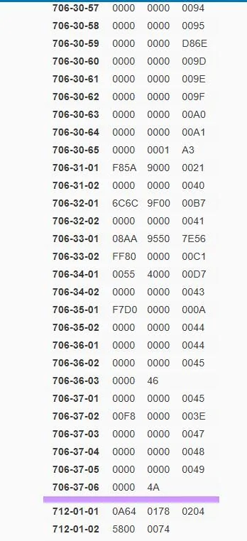

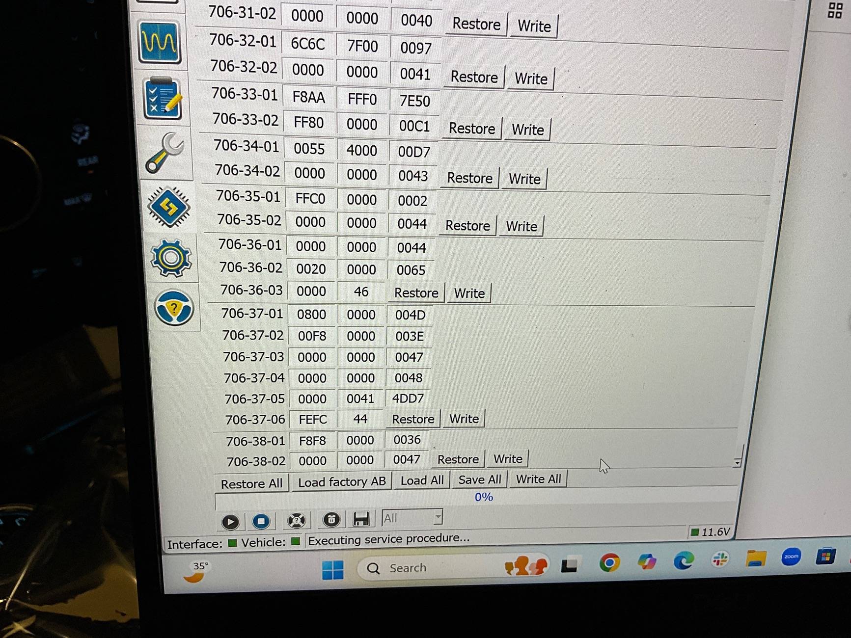

I would try to access info again. It just worked for me.
What he means is this:
Here is the ab data from the IPMA on my truck according to Ford. It ends on line 37-06.
Ford Bronco Forscan question - ABS has DTCs 1741727421201-99
Here is the last few lines from the IPMA from a comparable vehicle in FORScan:
Ford Bronco Forscan question - ABS has DTCs image
Ford does not show lines 38-01 or 38-02 even though they clearly exist. For some reason, this happens with vehicles with the last few lines of ab data on several modules.
Ok, I see what you're saying.
