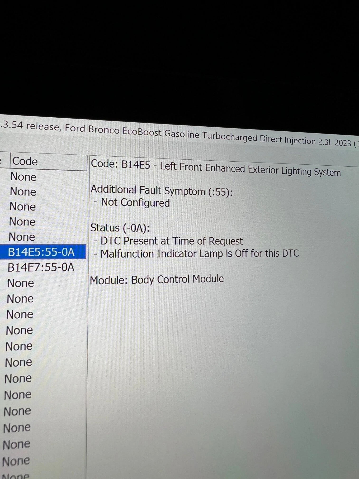

Newbie help needed! After swapping out my standard headlights for the signature headlights, I am getting 2 DTC error codes in Forscan. The first is B14E5:55-0A and B14E7:55-0A. These are for the left and right headlights and are basically stating that I have not configured these modules. Can someone who has the signature lighting tell me what their stock configuration is so that I can change mine and get rid of the error codes? Otherwise, the lights themselves do seem to be working properly with the exception of the ring leds not turning on when opening the door when the car is off ....it is just that the error codes keep popping up in Forscan. Community assistance would be greatly appreciated! I posted this question in a cou[ple of differnt areas wasnt sure where the appropriate section to post was...

Hey did you ever get resolution on this one? I didn't swap my lamps but I have the codes after adding fog lamps, not sure what I accidentally messed up via forscan.

No I didn’t. Actually not one response to my issue. I still show the error codes whenever I hook up forscan
Does anyone who is familiar with error codes have any idea what settings to change to clear the dtc issue?

Headlights have to be configured by the Ford diagnostic tool when replaced. That's the only way to get rid of these codes.

Ok thank you. So that’s a service that can only be performed by the service dept at the dealer? Is there any one out there that switched from the base headlights to the signature headlights taken the car in to have the codes cleared? And I assume everyone who has done this swap encountered the same error code?
Yes. I don't think forscan can do it, only FDRS.

I have the opposite, everything was working fine until I went to the dealer where they tried to clear the codes and actually had my front flashers and amber lights not working.
