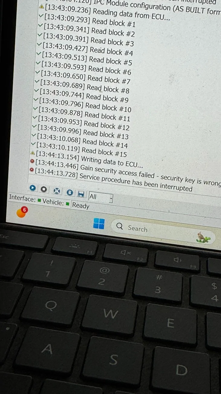

I just wrote all these modules on my 2025 mid heritage. Everything but the Instrument Panel Control Module worked. I got an error when I tried to write that module. Any ideas? its the latest version of forscan v2.3.70.
"Gain security access failed - security key is wrong"

The IPC, did you write all or just the lines that changed?
There's security on that because you know the instrument control panel also has the odometer data.
I do believe you should be able to write the individual lines I mentioned.
Do not write the entire module

Probably did a write all. Makes sense, I’ll try individual changes. Thanks

When writing this
Instrument Panel Control Module720-03-02xxxxx1--additional value for (1) is part of 2025 version for trailer Lighting
I get a Gain Security Access Failed message.
All other writes worked on the BCM, just the IPC won't write. I am pretty sure I am just writing this single line as well. as I wrote the BCM in the same manner, line by line.
Anyone else solve this issue? I have a 2025 Bronco Base 4Dr. Pretty sure If I am able to write this single line, my trailer lights will finally work. Saving me a trip and some $$$ at the dealership.

There is updated version of forscan that's in beta that has updated security key access for 25+ IPC.
This is a known issue
If you have a license you should be able to get it at the beta section.
If not, wait until that version gets published in a new updated version.

Still a no go! I bet it’s due to the new module for the 25/26 year. I had to buy the ford kit specifically for my year.

What is a no-go mean, you don't have access to the IPC?
What version of forscan specifically are you using?
