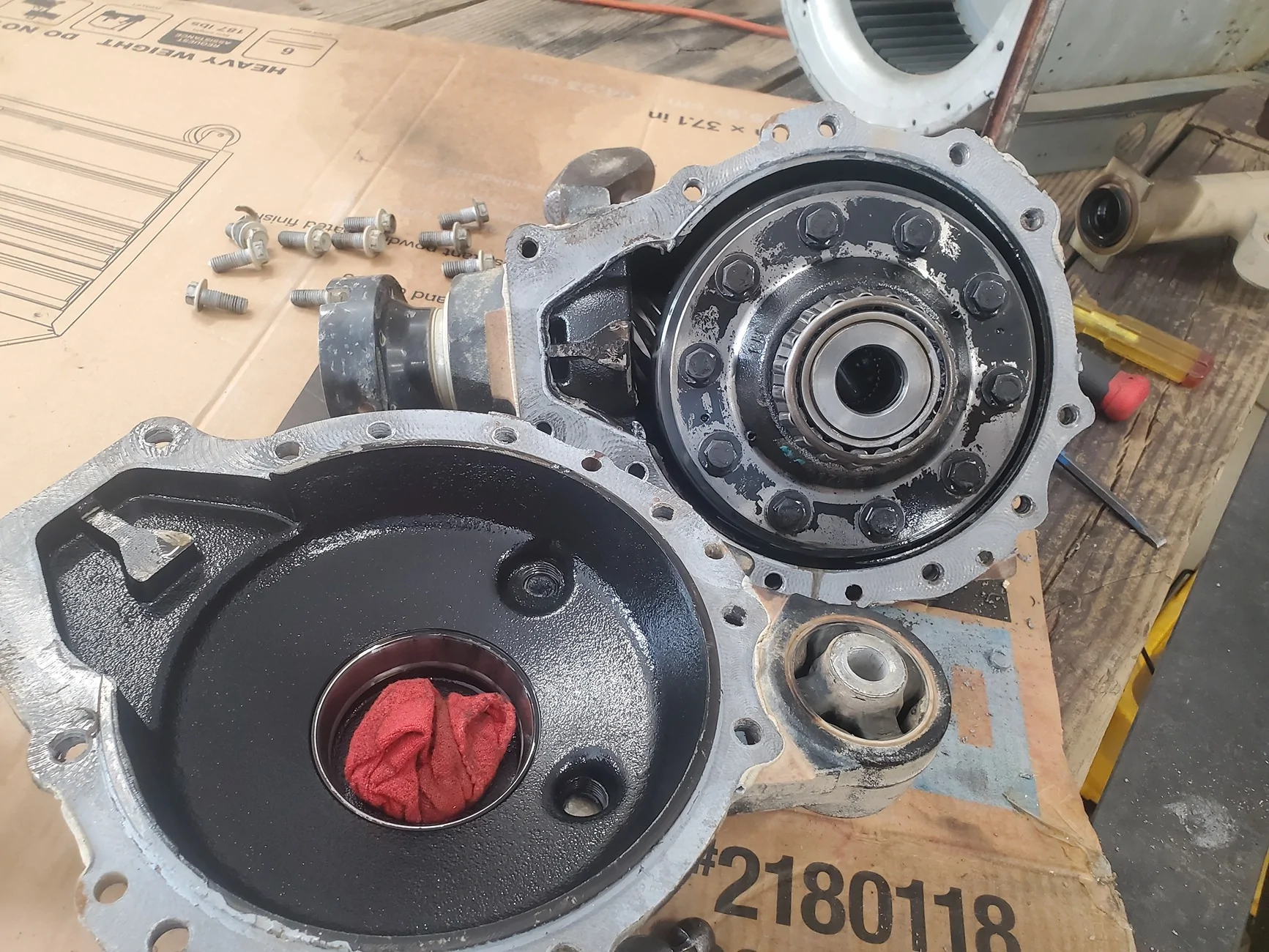

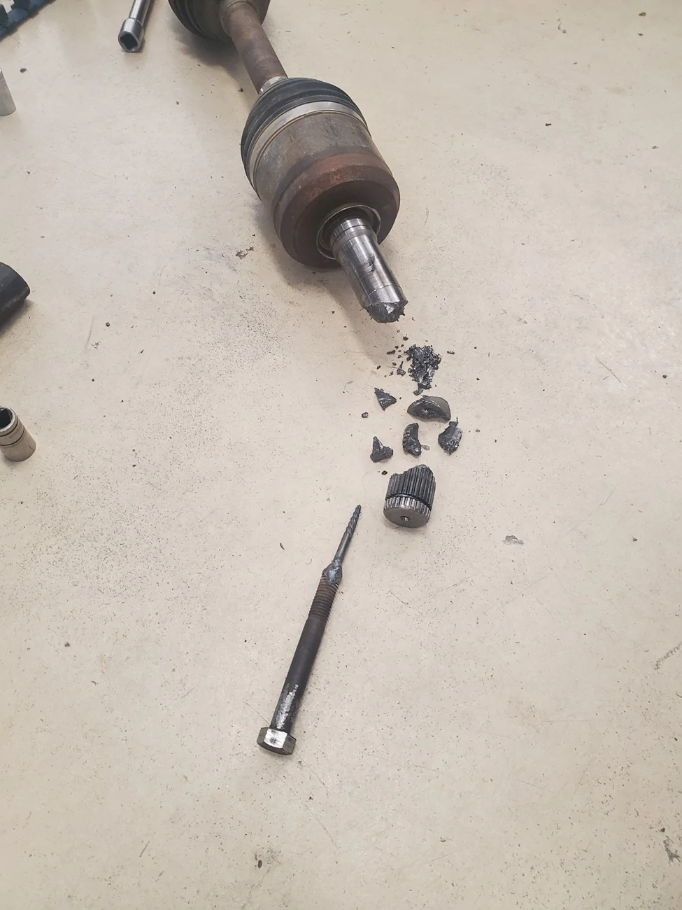

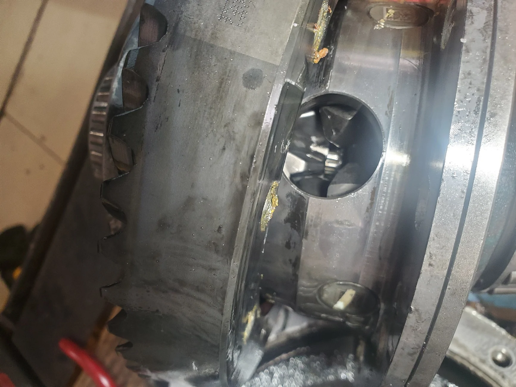

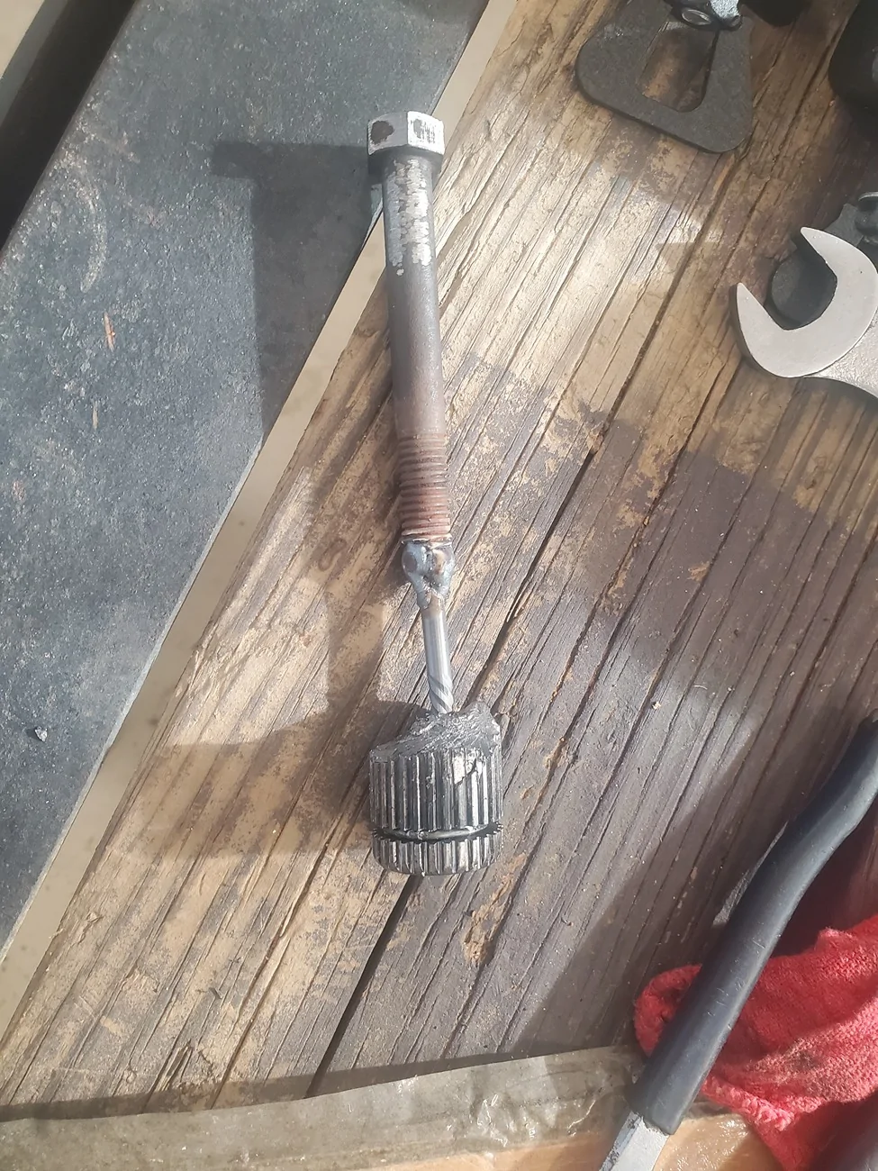

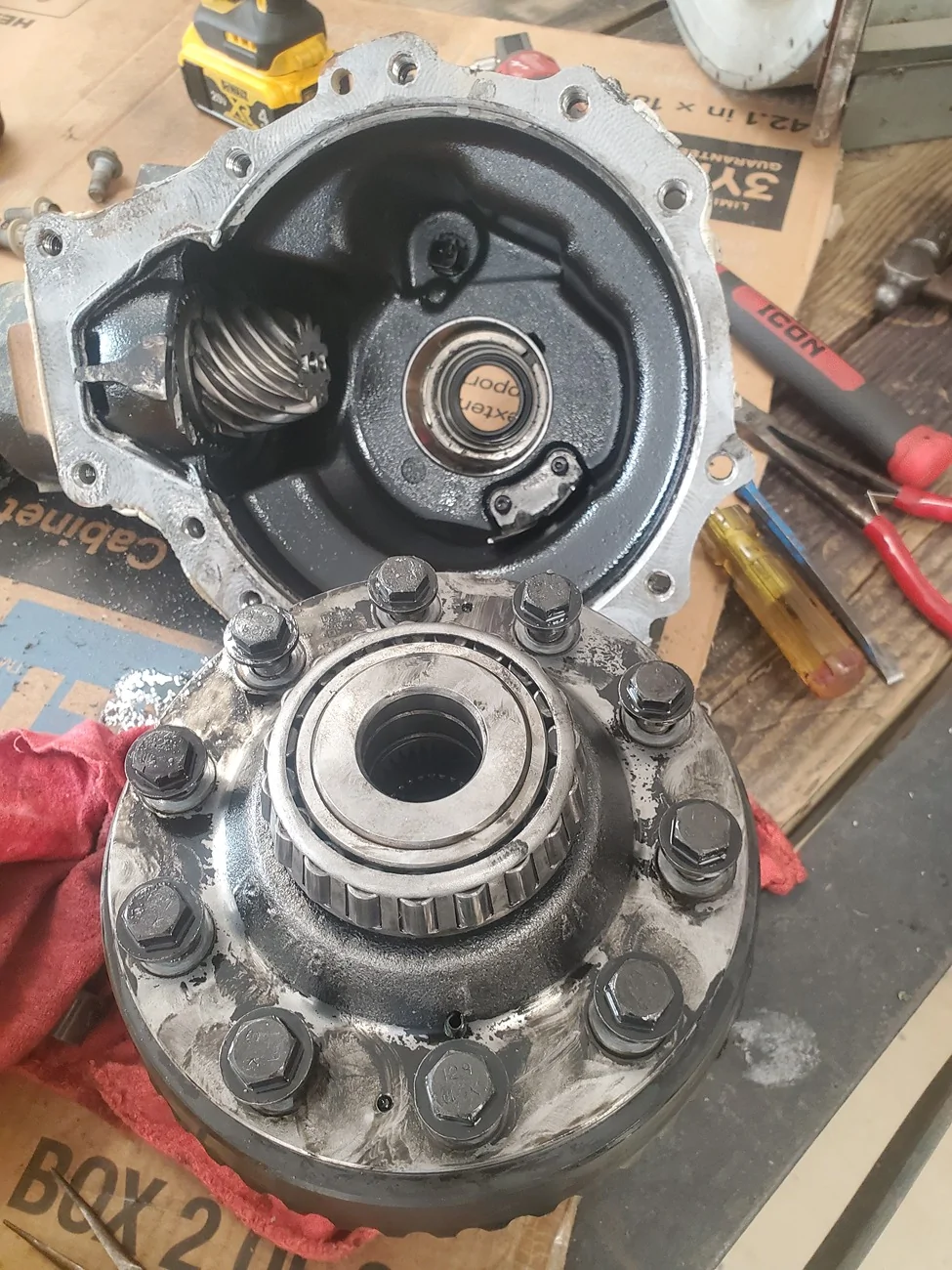

I'm sad now 'cause I break stuff. To the OP, I would say if you pursue this long you will skid
Crossmembers (K member)
frame side control arms
shock mounts
A arms
All of that is great but you lose about 3/4" of clearance, you need 1.5" taller tire just to get back to same clearance. In rocks 37/38 skinnies are great, but you will run out of traction and spin. Go wider and you will stick! and find out where metal gives. Personally, I think we are all fools and should move up to 2.5-ton Rockwell's.

Just curious
Looking at how your axle broke - assuming that's the standard 29-spine, would the 32-spline have been any better?
The RCVs and Dana Ultimate are supposedly made out of a stronger steel
The "Upgraded" Ford Performance axles are supposedly a stronger steel, but they don't say what.
The higher spline count I thought just helped from stripping the teeth, but I admit I'm not certain. A different alloy in the shaft would have certainly helped regardless though. But it's pricey to get there.

Just curious
Higher spline count increases contact area quite a bit, between that and the larger diameter it should be stronger. I want to go to a 40x13.5 so we will see if it can handle that. If I don't repurpose the money I can order next month.
