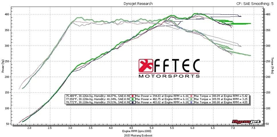

Please please please share your dyno plots. Here's a 2.3 making 400hp, spools by 3000rpm.
Ford Bronco Ford 2.3L ecoboost crate engine 1681235819257

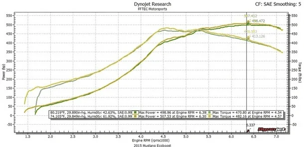

Here's one making 500hp, it's not spooled until 4500rpm:
Ford Bronco Ford 2.3L ecoboost crate engine 1681235805610
You have a 600hp 2.3 that hits torque peak by 2500rpm?? I don't think physics supports that, but I'm open to seeing a dyno plot. 600hp at 7000rpm is 450ft-lb. Making 450+ft-lb by 2500rpm with enough capacity to avoid turbo overspeed at 7000+rpm would be...impressive. Stock EcoBoosts make big torque down low because they have tiny turbos that fall off after 5000rpm. If you optimize for high end flow (max power), you HAVE to lose the low end. You can play with perfecting A/Rs and twin scroll setups and optimizing efficiency but a 600hp setup just straight up can't spool like a 300hp setup.

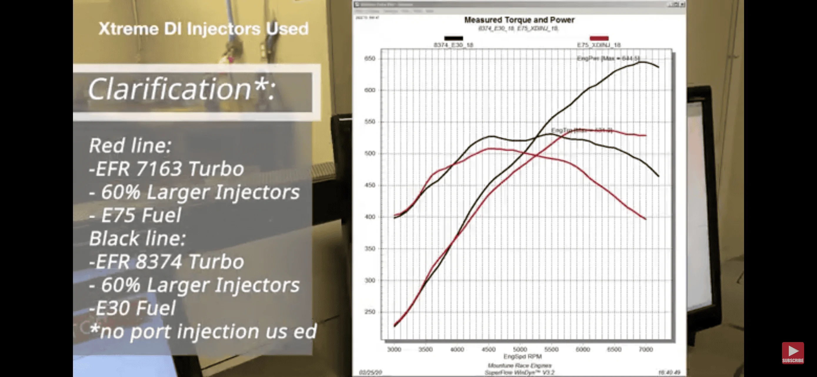

I can build a 2.3 for 4 grand complete.. not buying off the shelf motor I know this cause I’ve done it, and now helping my buddy build his 2.3 mustang.
Ford Bronco Ford 2.3L ecoboost crate engine FD468C64-F809-401A-ABAD-DCBBA7191A64

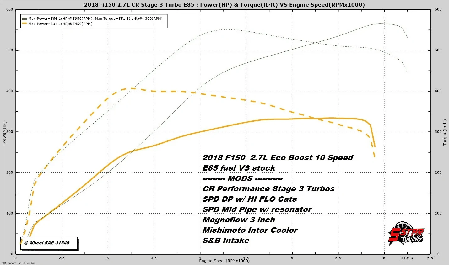

High flow pump? Not with dual injection. Stock fuel system supports plenty of power, and if you need more just throw in some bigger port injectors.
Stage 4 turbos are $2450.
Completely stock fuel system:
Ford Bronco Ford 2.3L ecoboost crate engine 1681391565946
Does the 4 grand include fuel system and turbo? You included those above. The EFR 8374 kit runs $3000+ and new injectors (no fuel pump) are $1300+. Your "4 grand" engine is now $8000+ to actually make the power you're claiming.
Plus, my buddies and I could throw a big ass turbo on a junkyard LS and make 1500hp. That doesn't mean it's done right and designed for longevity. That's why I asked for a vendor (you know, someone that has to take responsibility when something goes wrong) that would put 600hp through an unmodified 2.3 block.
You're really making my point for me here - not spooled until 4500rpm, just like I said. And just like always, people are getting wrapped up in peak number contests. Look at that dyno, then scroll up to the 2.7 dyno. What's more important in a Bronco? Peak power production at 7000rpm or power under the curve?
