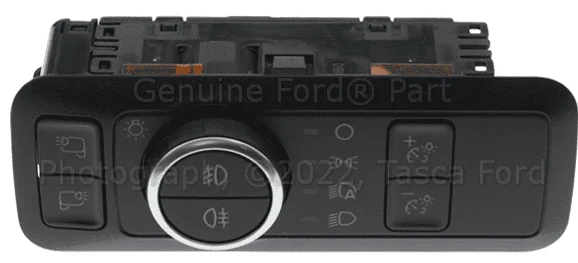

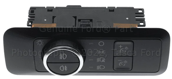

So I know this has been discussed a bit previously, but I am curious about the mirror spotlight buttons next to the headlight and fog light switches. I have a 23 Badlands mid package with the modular bumper. So no fog lights, and no lights under the mirrors. I want to get a new switch with front/rear fog light buttons to be able to wire up to the existing harness. However, there are two headlight switch assemblies that would presumably work:
M2DZ-11654-BC (no mirror buttons)
Ford Bronco Fog Light Switch 1701120235566
M2DZ-11654-CC (with mirror buttons)
Ford Bronco Fog Light Switch 1701120262890
If I were to get the the headlight switch with the mirror buttons, is there wiring in place already, similar to the fog lights? And is there something to activate in FORScan?
Then you could theoretically power ditch lights with the buttons?

No idea if the wiring is there or not. You’d need to check the DDM and PDM to see if the spot light circuits are coming out and going to the exterior mirror connectors. If they are, you can more than likely make the programming changes necessary in forscan.
But regardless, that circuit would still only function the same as the spot lights do. So vehicle speed under 6 mph and the parking lamps on.
