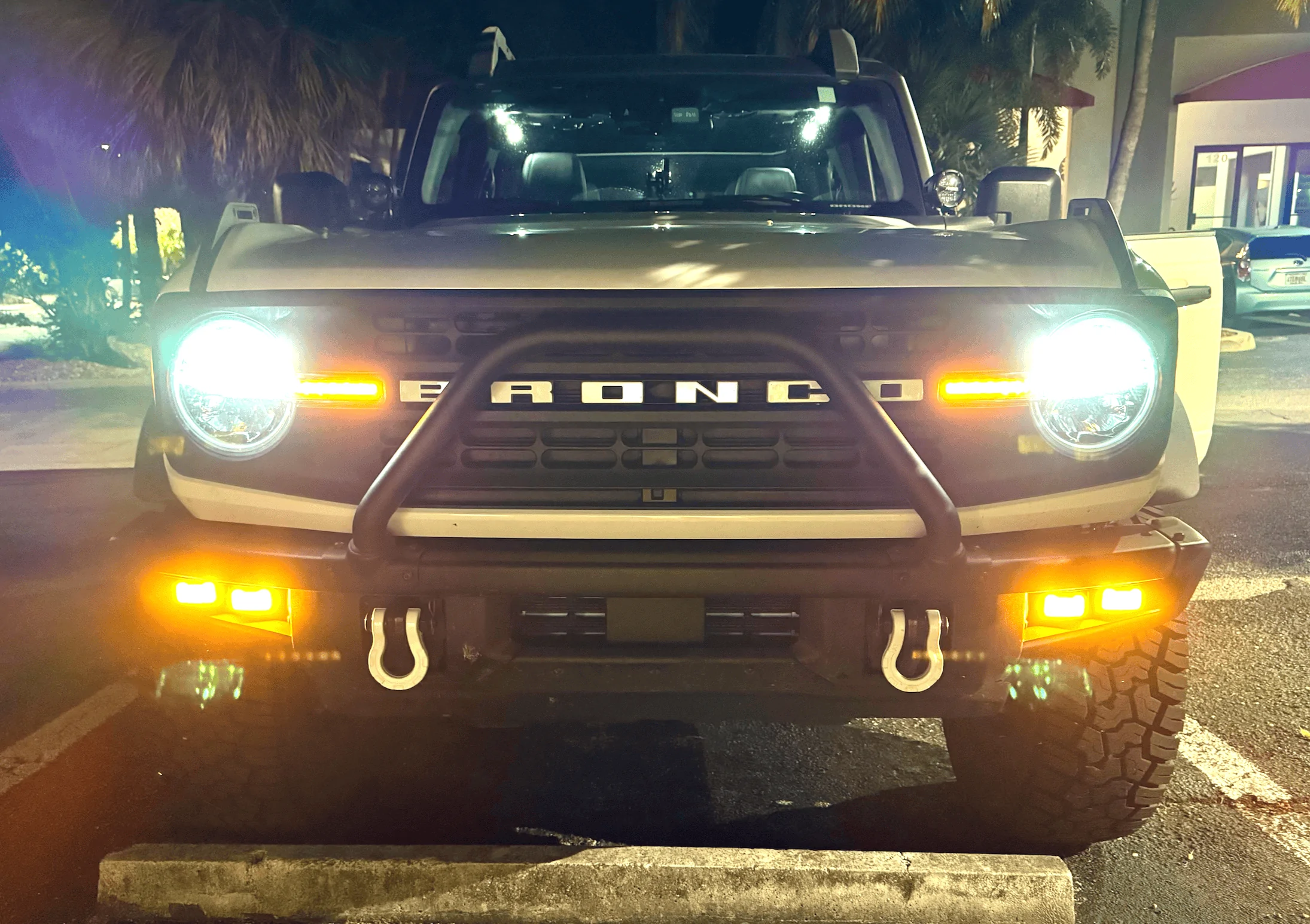

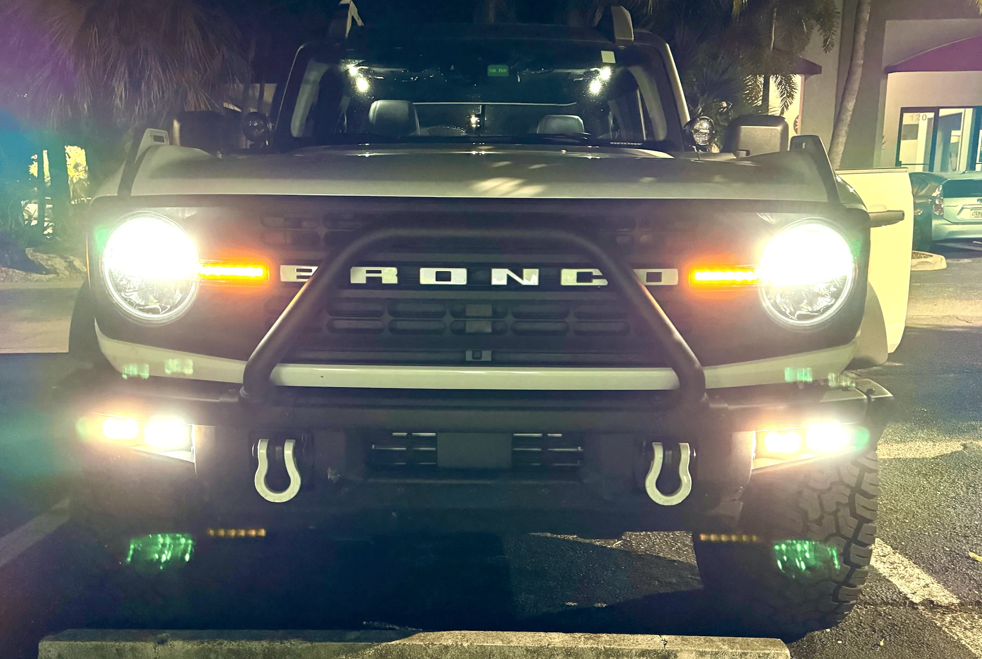

I've had these 21 Offroad lights for a while and they have been awesome until recently. About 10 days ago after some heavy rain, the white lights stopped working. The ambers are perfect.
I contacted the reseller and was asked to check the fuses and connectors. I replaced the fuses and checked all the connections/wires, and all seemed fine. I then removed the lights completely, unplugged all the connectors, let them air out for a few days, then I cleaned them, applied Ancor Dielectric Silicone Compound to the connector pins, wrapped everything with electrical tape, and reinstalled them.
This is what they look like now :confused:
Ford Bronco Fog light issues Screenshot 2023-10-06 at 10.54.50 AM
But amber lights work perfectly.
Ford Bronco Fog light issues Screenshot 2023-10-06 at 10.55.46 AM
I want the white lights to work as they did/should. Any suggestions or advice would be truly appreciated.

Not familiar with the company but those look like the same overseas lights you see that are very inexpensive. And that's why they failed... they are very inexpensive and are not quality. Sorry to tell you there's really nothing YOU did wrong, it's just the quality of the light you got. It's a poorly made/cheap overseas light.
We always try and educate our customers that you really get what you pay for and we hear constantly issues with these cheaper lights failing. Usually the biggest issue is moisture getting inside.
Look closely at the lights, do you see any moisture/condensation/fog inside. Chances are you will. If not, remove a light and shake it. Do you hear water inside?
