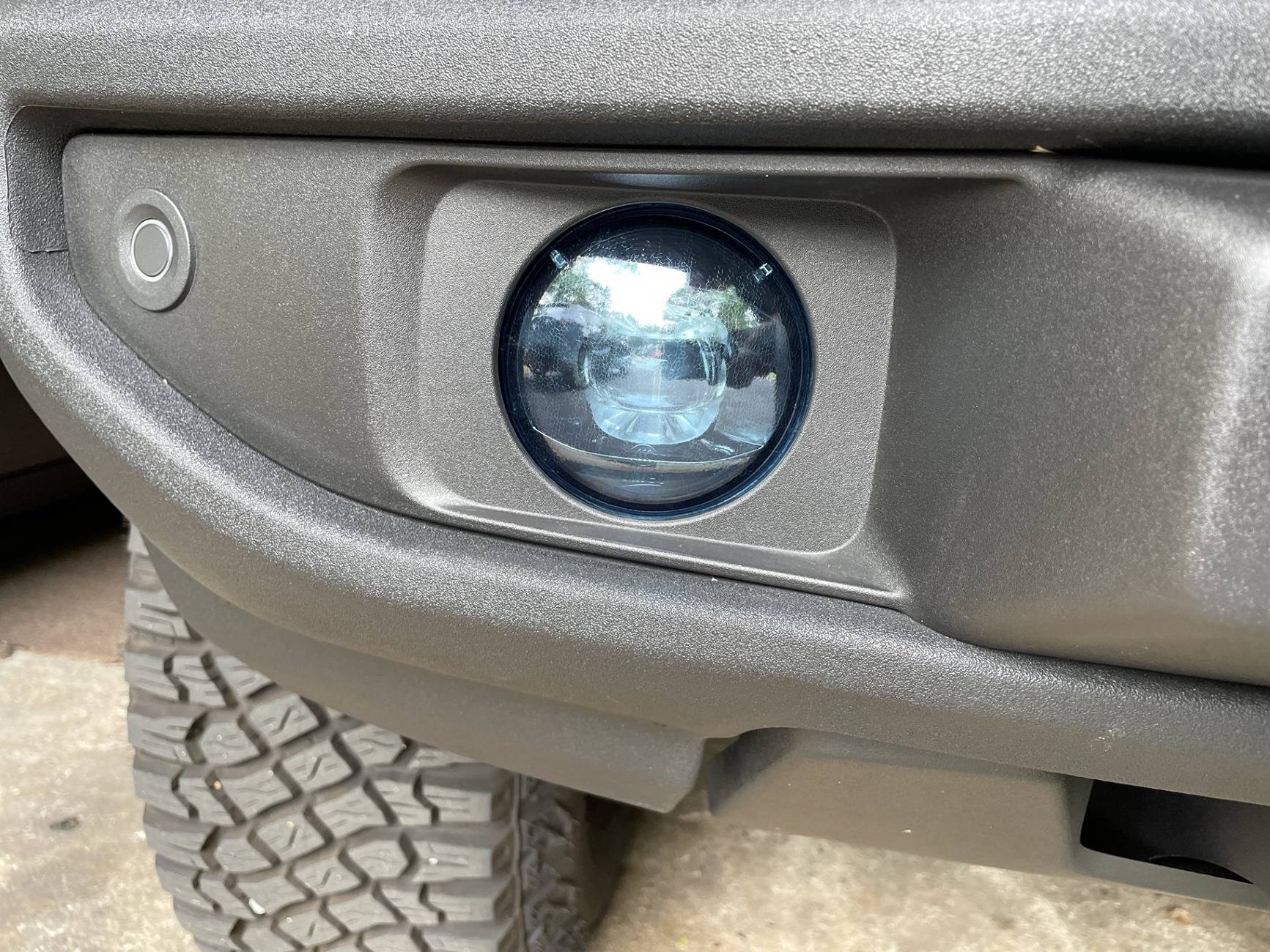

Or you can use amber film and cover them
I put blue film over my Fogs and still through as white. They only appear Blue when off.

I did the same with lamin-x amber film for fogs and 20" light bar and they shine amber. On my interior aftermarket lights, I used left over pieces to make them amber and it worked very well. So, I think the ambience lighting can be done the same way and achieve the desired effect, just got to find where the led's are at.
