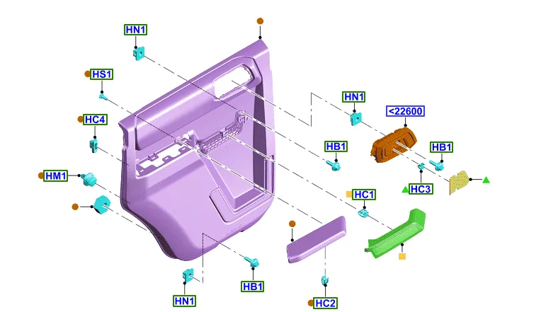

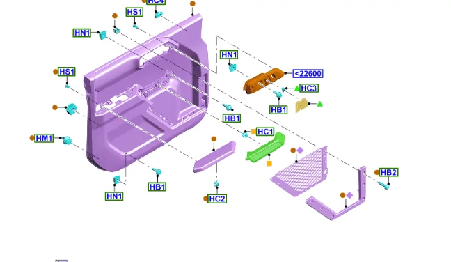

Looks like screws (HB2). Little nugget of 'hog in the part list at the bottom.

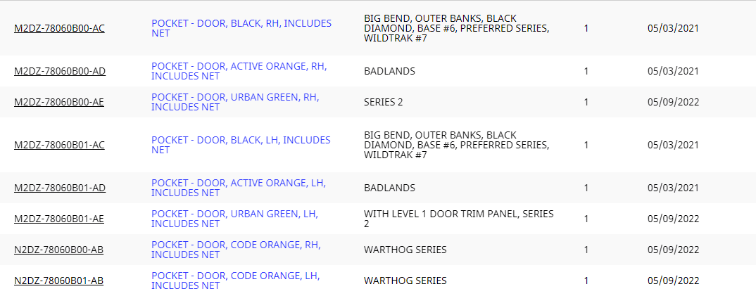

Thanks Phil! For some reason the pocket parts M2DZ-78060B01-AC and M2DZ-78060B00-AC aren't coming up in any searches?
Do you happen to have the diagram for the rear as well?

I searched DOW (Fords part info system) and those are good numbers and there are 3 of the B01-AC and 1 of the B00-AC in the depot but don't have faith it will be there 15 minutes from now. Plus, they're 'spensive. List is $194.68 and $199.44.
Houston, we have a problem....Looks like that net is only serviced with the entire panel.

Ouch, well I guess those aren't getting replaced. As always, thanks for all your help!
