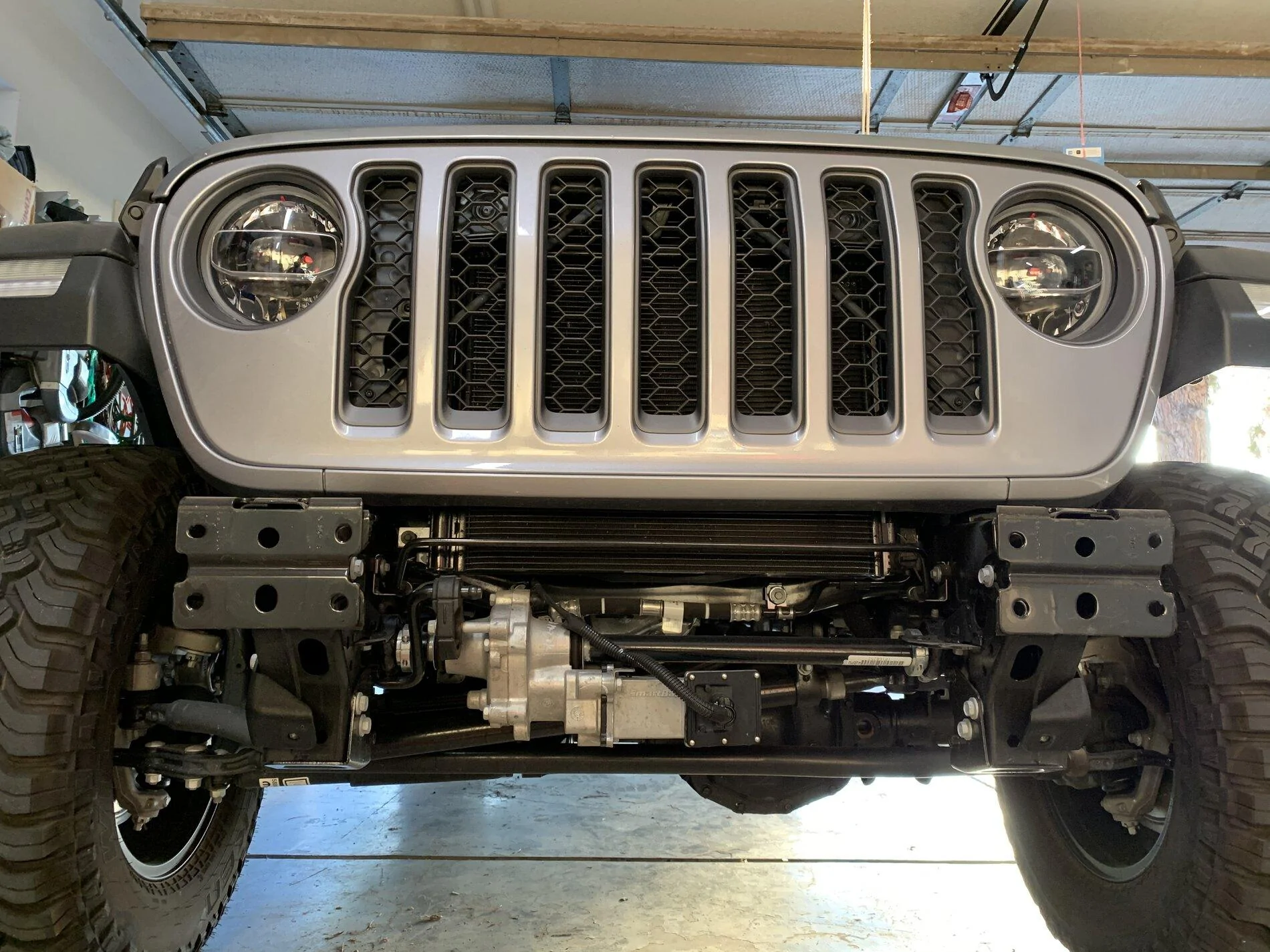

I'd like to see if the frame has good attachment points for a base plate or bumper that's beefy enough to support flat towing. It' looks like the Jeep JL bumpers don't really attach to the frame well. It would be interesting to see if Ford solves this problem elegantly.
rjkmoto
JK
Jul 18, 2020
342
900
Arizona
2017 Dodge Challenger Hemi 392 Scatpack Shaker, 2020 Jeep Gladiator Rubicon
The bumper on a JL and JT bolts directly to the end of each frame rail with 8 bolts, four for each rail.
Don’t know how you’d get much more beefy than that. ?‍♂

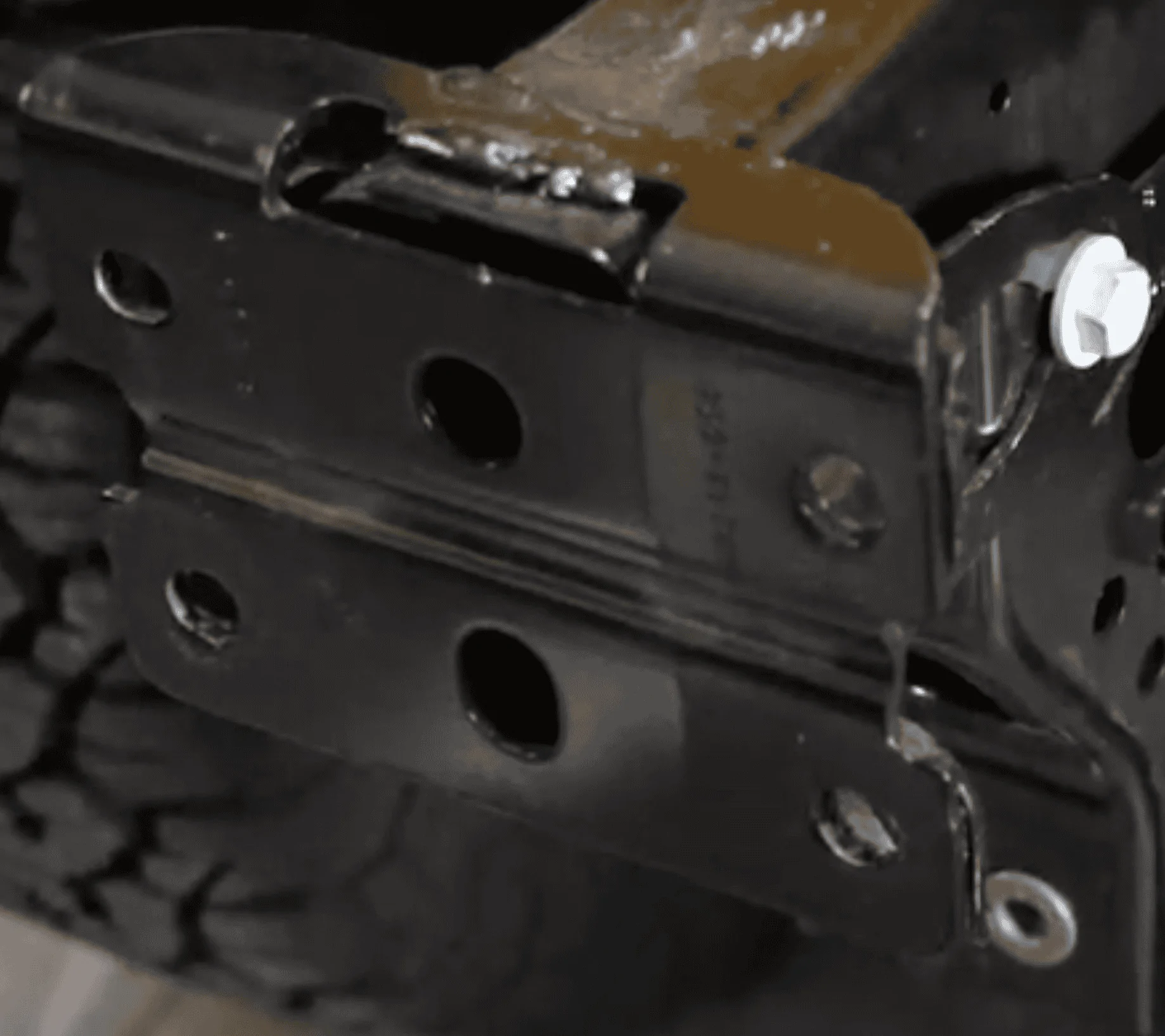

I could be mistaken... My very very very limited understanding is that the bumper mounts (4 bolts per side) are not designed for the loads one might see when flat towing. From what I have found this seems plausible. For example, This seems more like a tack weld vs something structural.
Since writing my original note, I've found that at least one manufacturer has a frame tie in that may make things moe solid.
Ford Bronco Flat Tow New Bronco (Yes, Confirmed) 1597639983111
In any case, my goal is not to disparage Jeep but to see if the Bronco is well thought out in this area.
