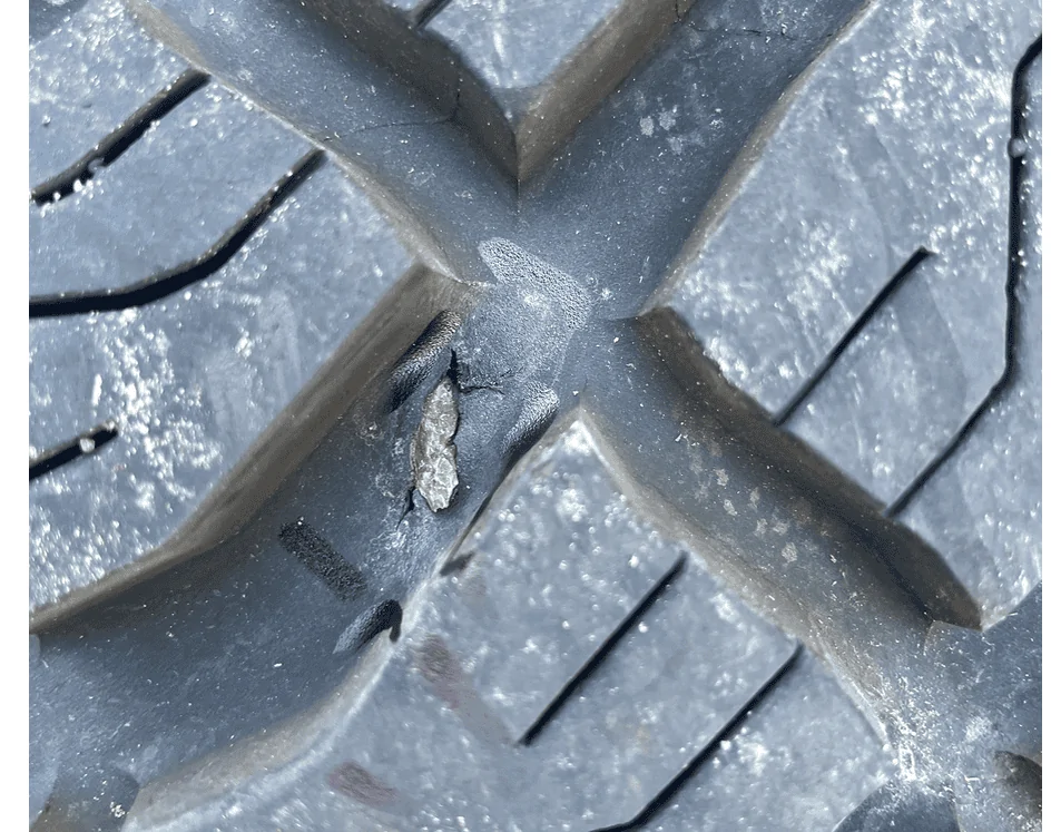

drove around a bit today and explored some campgrounds and picked up a small sharp rock, right in between the threads of my Sashquatch tires, causing a slow leak. Made it back home on 20psi
, now I have to see if that can get fixed or if I'll already need to buy a new tire. The rocks are sharp on the mountain, but this is not really confidence inducing regarding the GoodYear Territory MT tires after some 500 miles. Might have been just a fluke, bad luck, but still. First flat in over 20 years. I'm attaching a photo, I never used a patch kit (as I haven't had a flat in so long), does this look fixable? I'll bring it to America's Tire when they have a moment to check it out.
But good thing there are pressure monitors or I would have not noticed this and gone on exploring.
Oh, and the tires are damn heavy and I'm gonna buy a better jack too.
I sure hope the tires hold up better when actually going off road.
I was planning on doing 5 tire rotations, is a plugged tire safe to use as anything but a spare? I guess the store will tell me.
Not the adventure I had in mind for today...
Like Brentutk said, it's not enormous and you have deep valleys of tire tread, so should be fine. Keeping it as the spare is probably wise.

just a quick update, went to my dealers service dept and they called it fixable, picked it up a while later and only $25 out of pocket instead of over 300, so happy with that. Great service dept too, very big operation. Impressed by my dealer again, I feel quite lucky to have them in town.
I'll skip the 5 tire rotation and use it as a spare.
Oh, after a couple hours the Bronco learned that the former spare is not it's left rear leg and pressure shows up correct again on screen for all 4 tires, also good to know, no input from service/dealer needed. Monitoring via app took even longer, but is also correct now.
Was a bit nerve wracking to come down the mountain and having to hit the freeway for two exits with the pressure slowly going down on my screen, but it all worked out. Interesting too, from the looks you could barely tell a difference between the leaky tire at 19 PSI and the rest at 41 after driving. Sure glad to have these sensors, I'd have continued exploring and would have landed with a full flat somewhere. Or worse.
