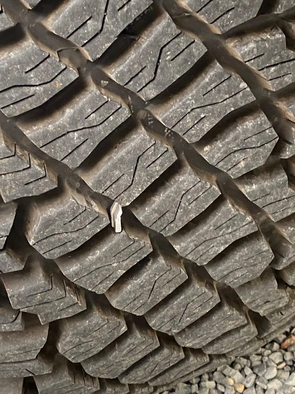

drove around a bit today and explored some campgrounds and picked up a small sharp rock, right in between the threads of my Sashquatch tires, causing a slow leak. Made it back home on 20psi
, now I have to see if that can get fixed or if I'll already need to buy a new tire. The rocks are sharp on the mountain, but this is not really confidence inducing regarding the GoodYear Territory MT tires after some 500 miles. Might have been just a fluke, bad luck, but still. First flat in over 20 years. I'm attaching a photo, I never used a patch kit (as I haven't had a flat in so long), does this look fixable? I'll bring it to America's Tire when they have a moment to check it out.
But good thing there are pressure monitors or I would have not noticed this and gone on exploring.
Oh, and the tires are damn heavy and I'm gonna buy a better jack too.
I sure hope the tires hold up better when actually going off road.
I was planning on doing 5 tire rotations, is a plugged tire safe to use as anything but a spare? I guess the store will tell me.
Not the adventure I had in mind for today...

Looks very patchable and in a spot that any tire will be weak, between tread blocks. I've ran over the con rod that catastrophically left the corvette ahead of me on track before that punched a nice hole in my Pilot Super Sport, Discount tire had it patched the next week and it was fine for the next 8K miles (of non-track duty, I didn't trust it when driven in anger with the patch).
Upon following up with Youtube advice, it looks like you can patch it no problem.

Well, just got back from America's Tire and was told they can't fix it. The slit is too long and even with plugging and patching from the inside it won't be long lasting. They also can't get these tires (yet I guess), so left a message with my sales guy to buy a new one from them.
I just wish I actually had been off roading to need a new tire, LOL.

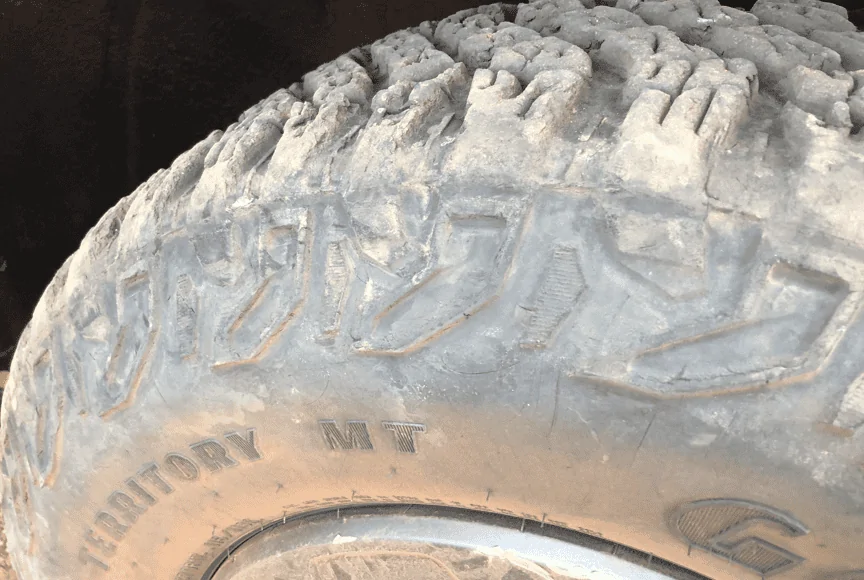

This is the first report of a flat that I've seen. I'd file it in the bad luck category for now.
About 30% of the Broncos at Off-Roadeo in Austin had flat spare tires. I thought the Territory tires showed a lot more wear than the KO2's at Off-Roadeo. I was not impressed with the Goodyears. Here is one with 2200 miles on it.
