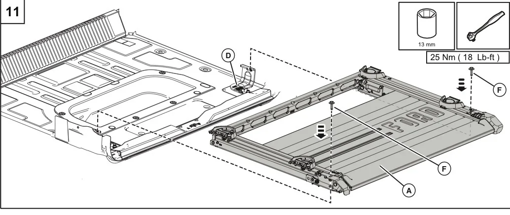

I recently purchased a used slide out tailgate and the front right threads (closest to the tailgate hinges) are cross threaded. What’s the best tool to fix this? Most thread chaser kits only go up to 12 mm and this is a 13mm bolt.

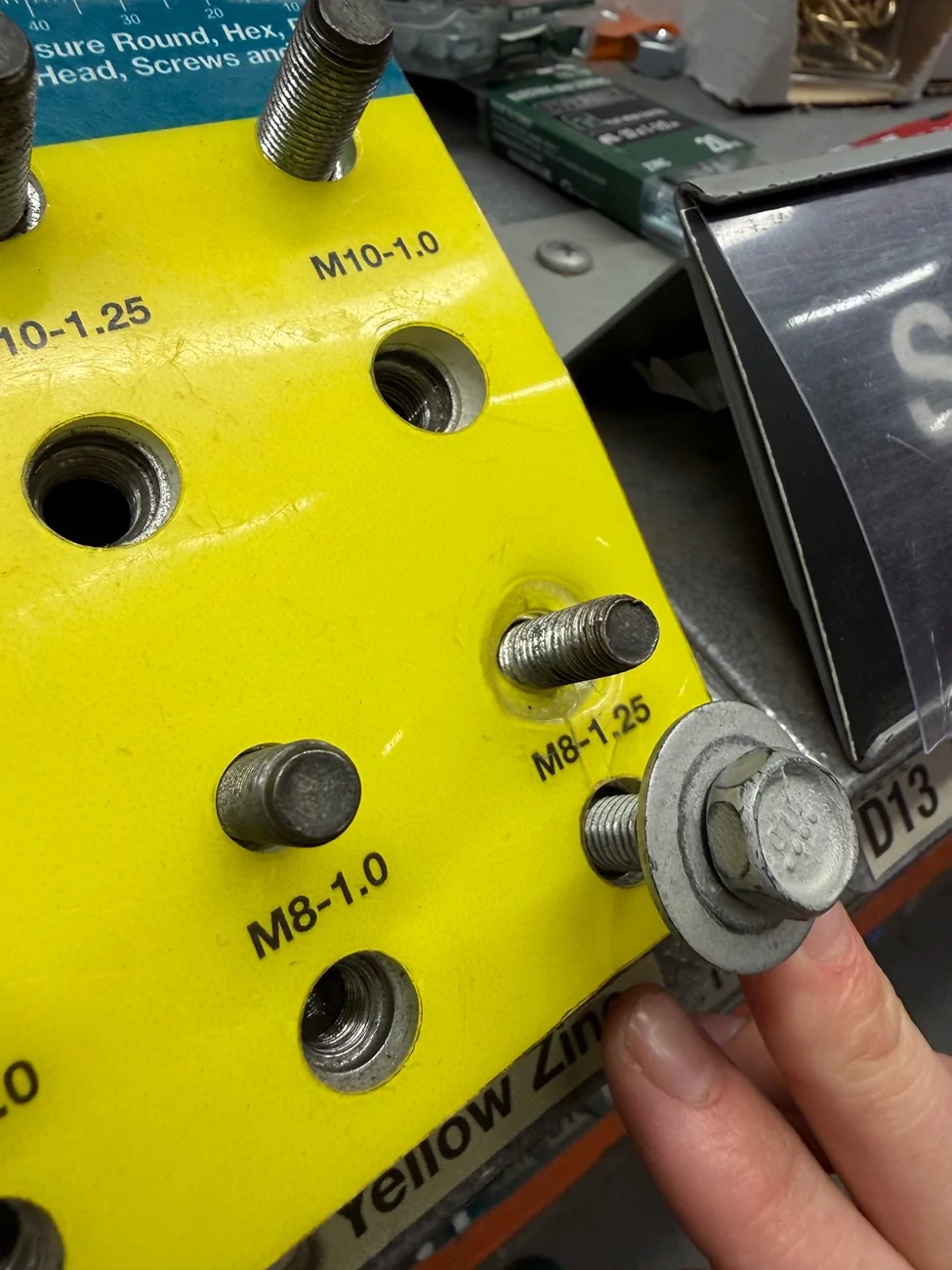

Winner winner, fit perfectly in that slot.
If you have a bolt that fits, take it to Home Depot or most any hardware store and in the aisle with hardware they will have one of these things on the wall, use it to find the right thread size and then buy a tap for just that size for like $5
https://www.homedepot.com/p/Saker-1...d-Nut-Identifier-Gauge-GJ64920-E001/332175461
Thanks for the idea, was helpful in figuring it out.
