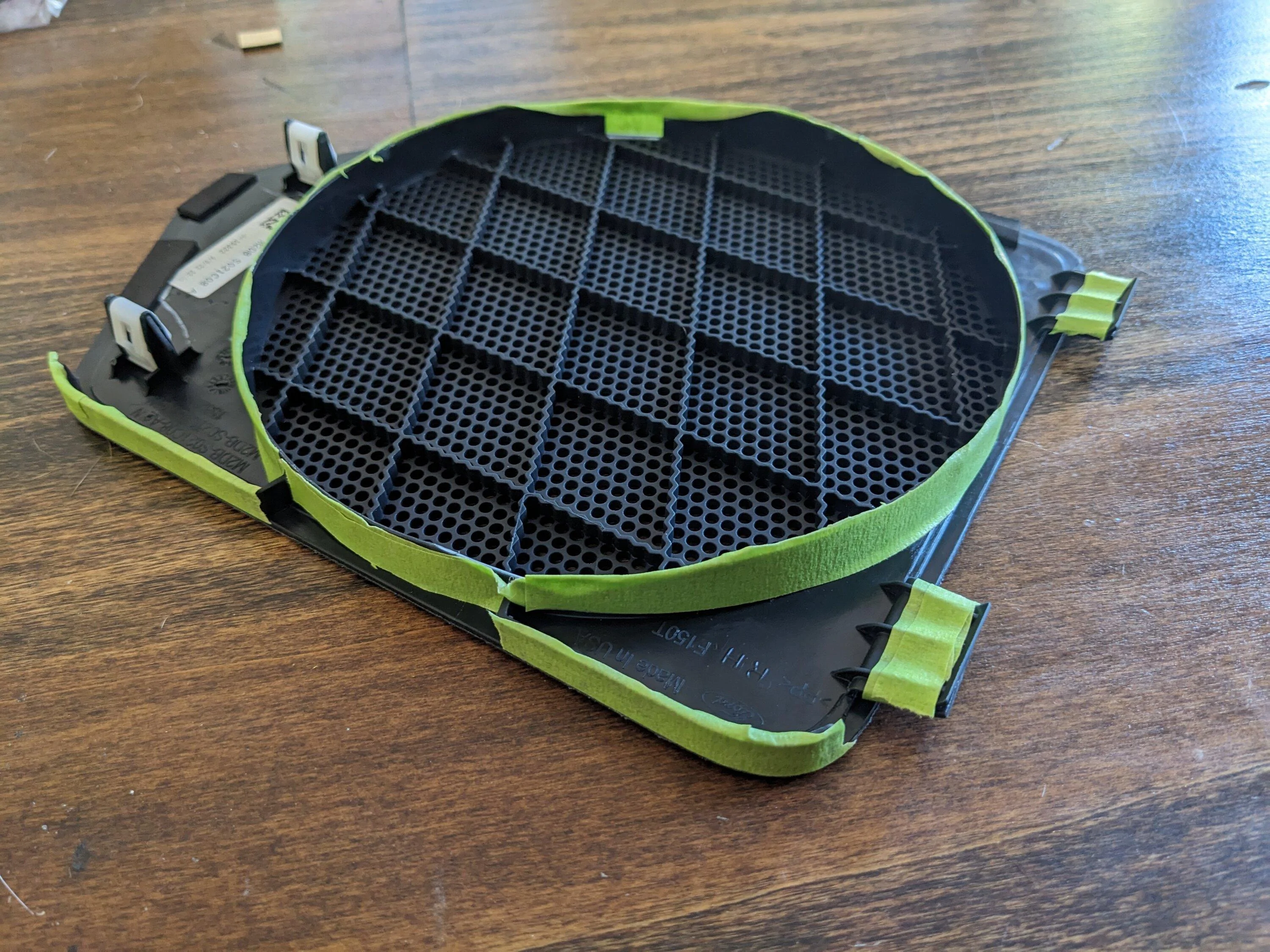

So after installing Kicker KS Series speakers in all 6 positions, I found that the cheap factory kick panels speaker covers had an INCREDIBLY annoying buzz at certain frequencies. I believe a large part of this is due to the fact that the tweeters contact the cover since the KSs are about 3/16" too deep (worse on the passenger side).
After multiple unsuccessful attempts to stop it with stick-on foam on the cover itself, I went all out today. Velcro and masking tape took care of it.

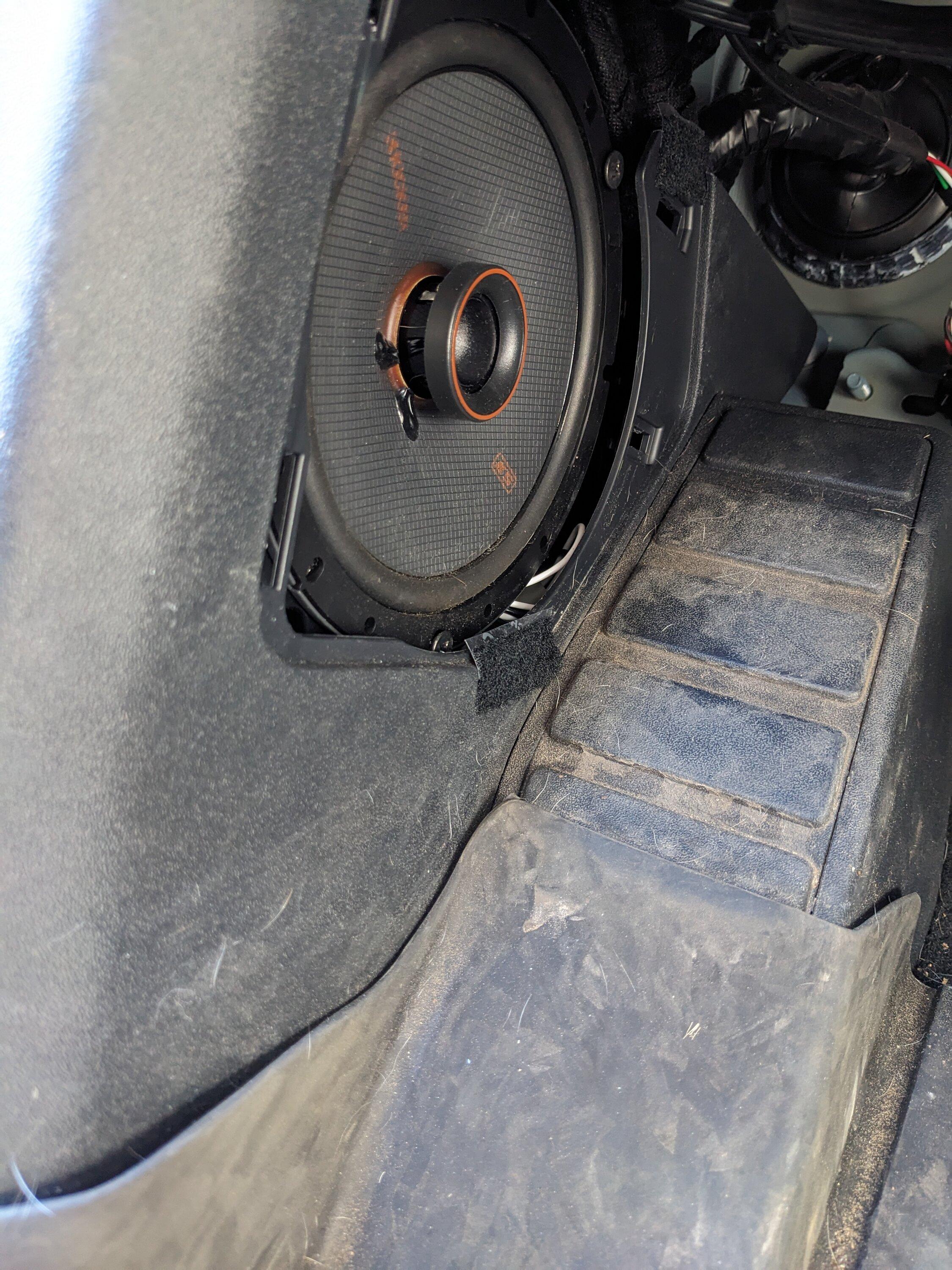

I should add that after I took that picture I also added Velcro between the kick panel and dead pedal. No more buzz!
