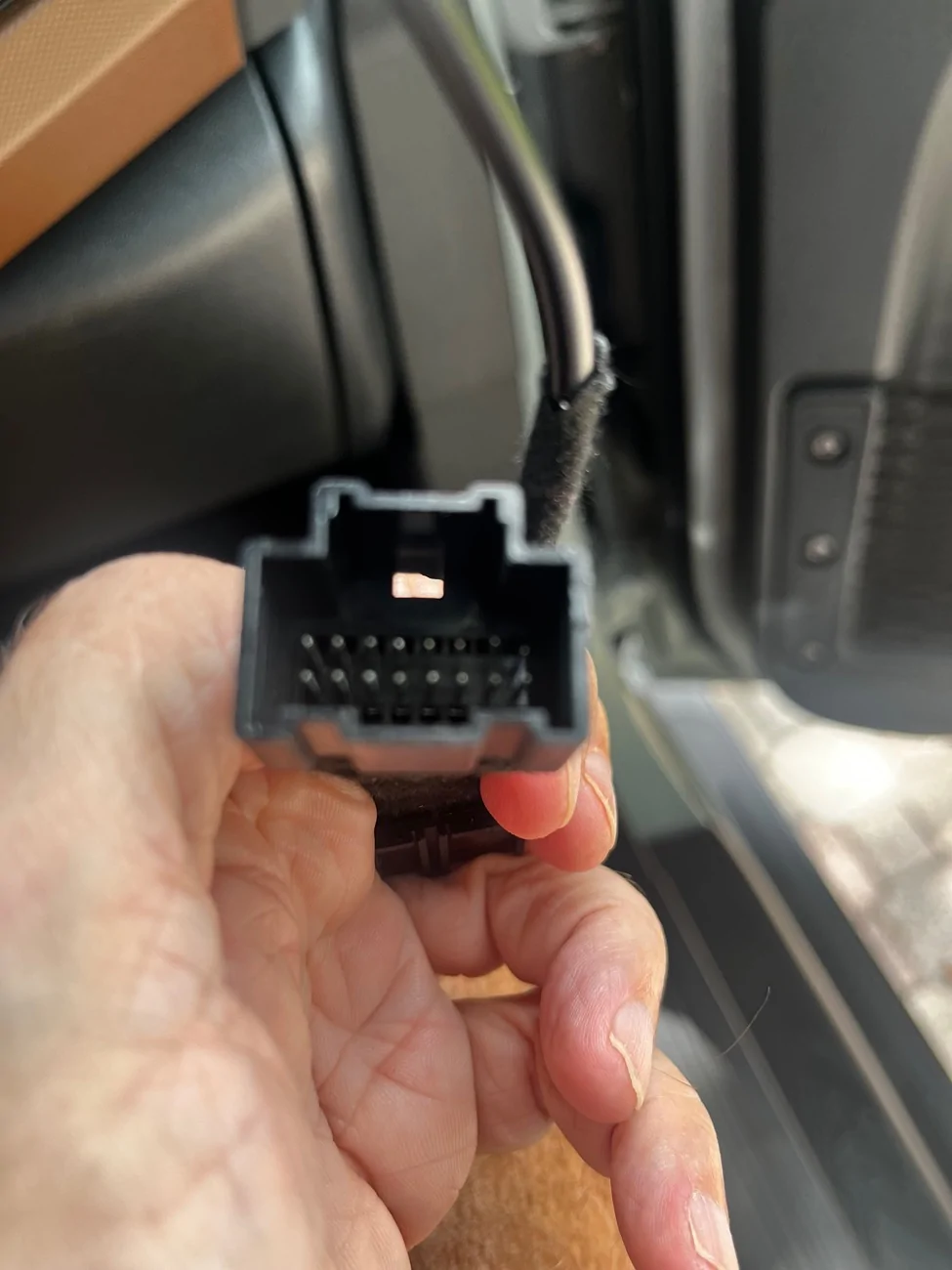

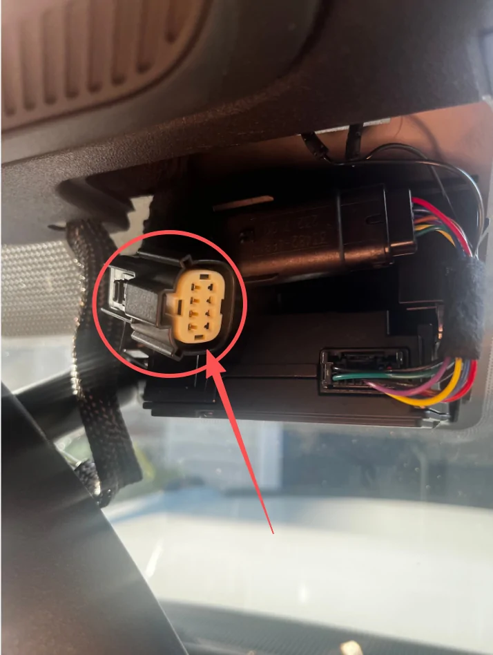

I just got a Fitcamx dash camera , for my 2024 Outerbanks, it appears the connector supplied is wrong for the Bronco . I am enclosing pictures the connectors don’t seem to match . Has anyone else had the same installation problem?

just did mine last week and it fit right in, you have to use the wire that goes into the The mirror, put the jumper wire in between and 1900 The skinny wire into the camera and it works fine for me.

Thanks I see what I was doing wrong I disconnected the connector under the plastic cover, not the mirror

You use the wire that unplugs from the mirror. The giant connector does not go into the oem-look housing. None of the website pictures show the driver's side where the ugly harness remains exposed. I have the fitcam in another car and it looks great because it's all hidden. The fitcam in the Bronco is not a good look.

Absolutely that’s where I got confused thought the Fitcamx connection went under the plastic housing
