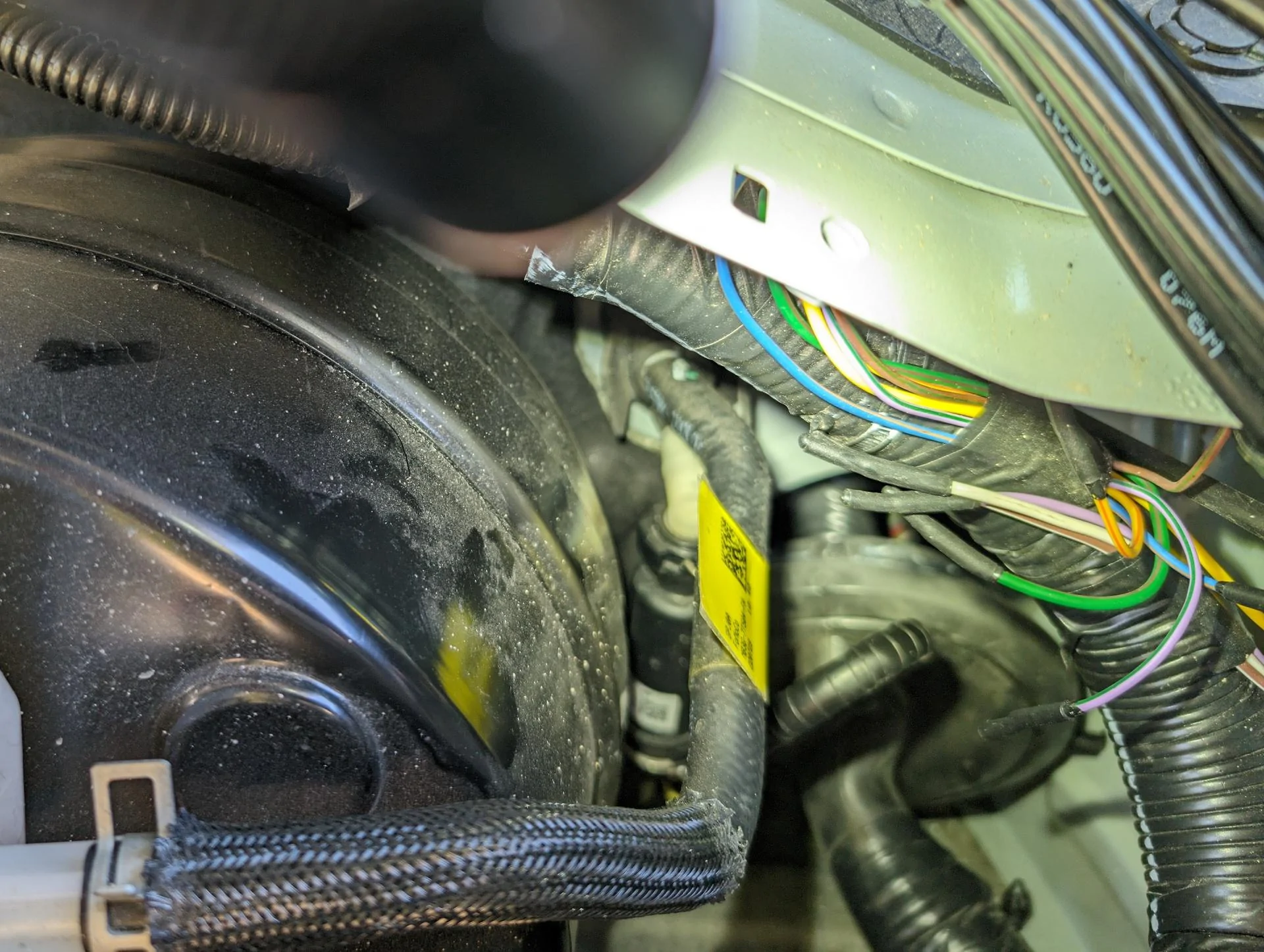

If you cut the nipple on the grommet in the engine bay it's a 1/4 in hole.
What I ended up doing was using an X-acto knife to cut an X on the left side of the grommet in the engine bay, then sliced open the right side of the rubber nipple on the right side of the grommet behind the clutch. From there tied off the 3/4 inch antenna connection to a coat hangar and pulled it through. Hope this helps clarifies things for someone.
Ford Bronco Firewall pass-through for power supply on 7MT. PXL_20230422_231652186
Ford Bronco Firewall pass-through for power supply on 7MT. PXL_20230422_231636828

I did the same, but be careful - I somehow sliced the fuel gauge wire. Cost me a week at the dealer and a massive headache for the tech. I was throwing codes for everything.

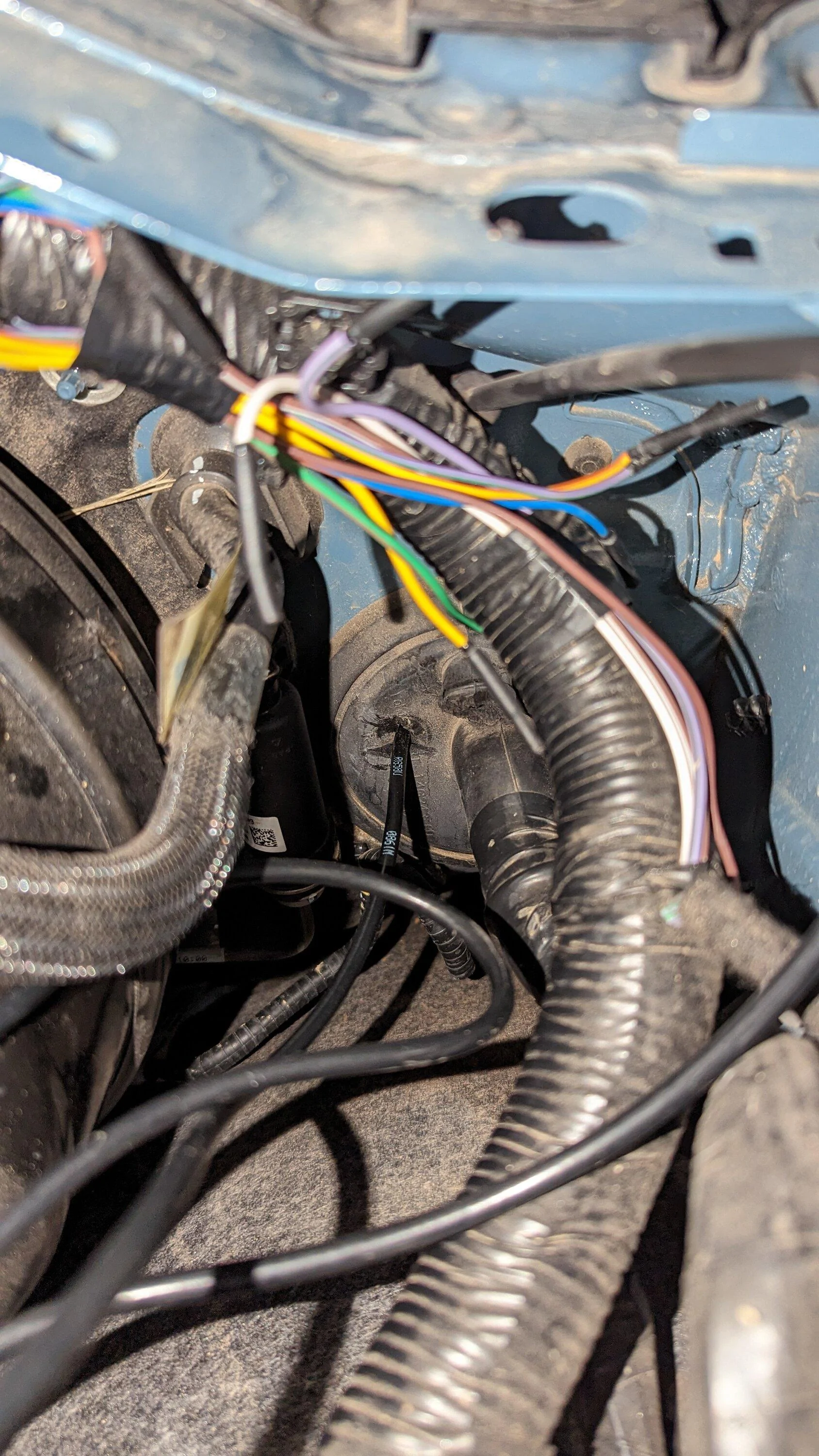

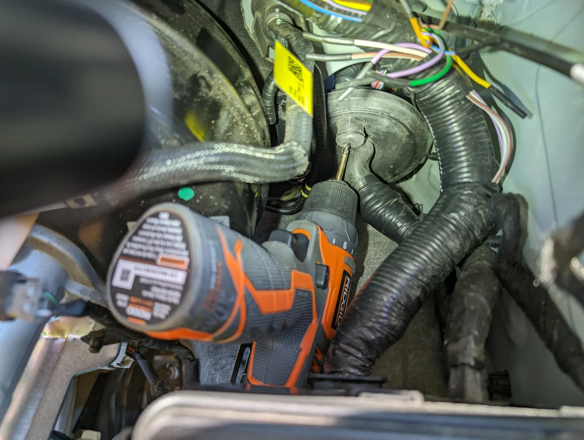

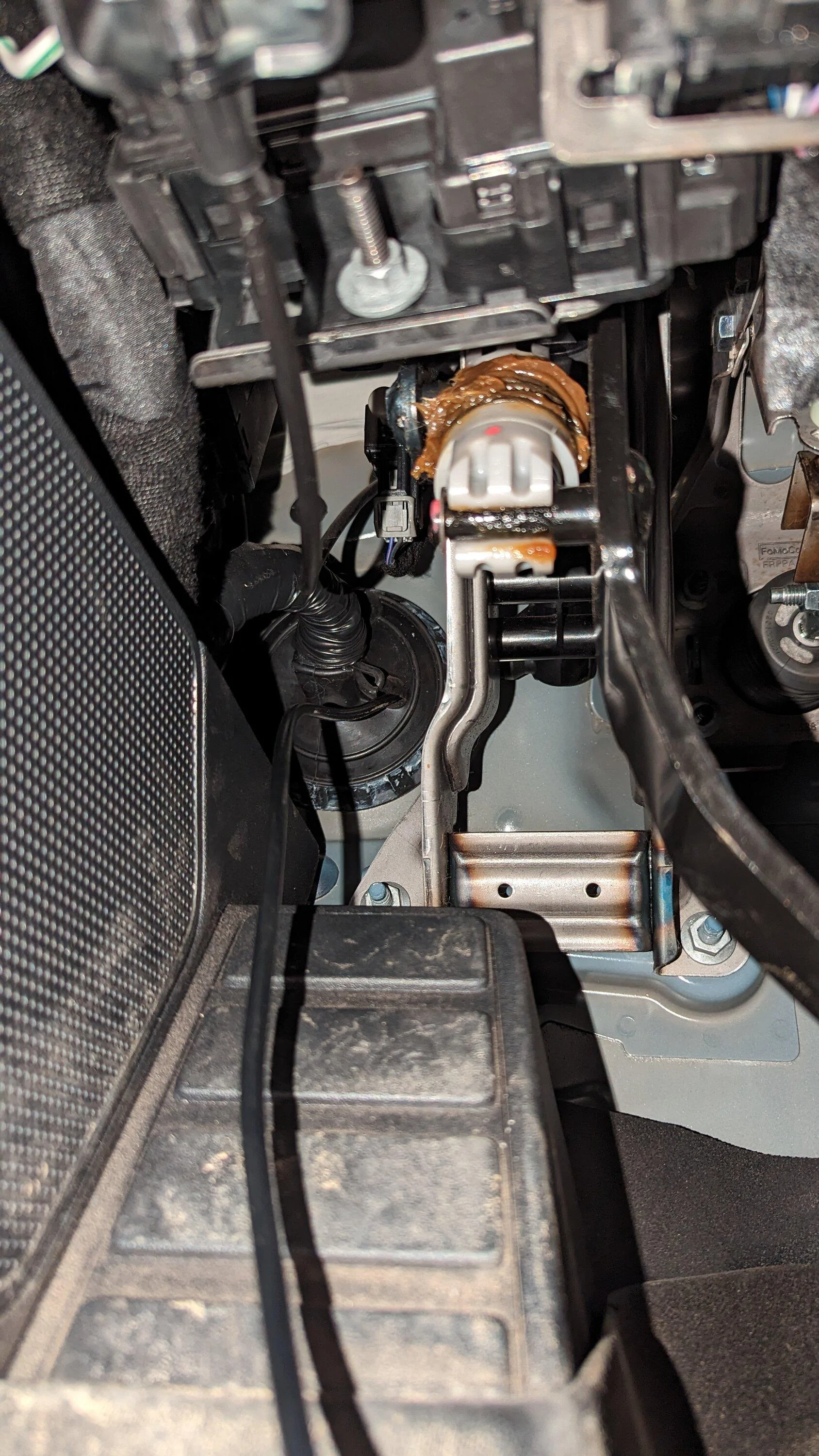

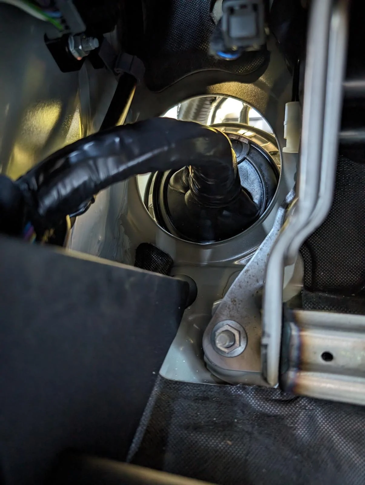

Just successfully installed a Midland GMRS antenna through the ‘nipple’ into the cabin. I did not see it mentioned anywhere in the thread that the grommet can easily be pulled out towards the engine bay. From there you can use an x-acto blade to make a star pattern. Since the antenna was larger than a wire, I also used a drill bit to create more space. If you squeeze the grommet at the top while drilling, you will notice a round ‘protective’ circle on the cabin side - just opposite the ‘nipple’. This should prevent the hole from expanding.
Engine Bay:
Ford Bronco Firewall pass-through for power supply on 7MT. 1000001079-01
From inside the cabin looking up:
Ford Bronco Firewall pass-through for power supply on 7MT. 1000001080-01
Drill in Engine Bay:
Ford Bronco Firewall pass-through for power supply on 7MT. 1000001081-01

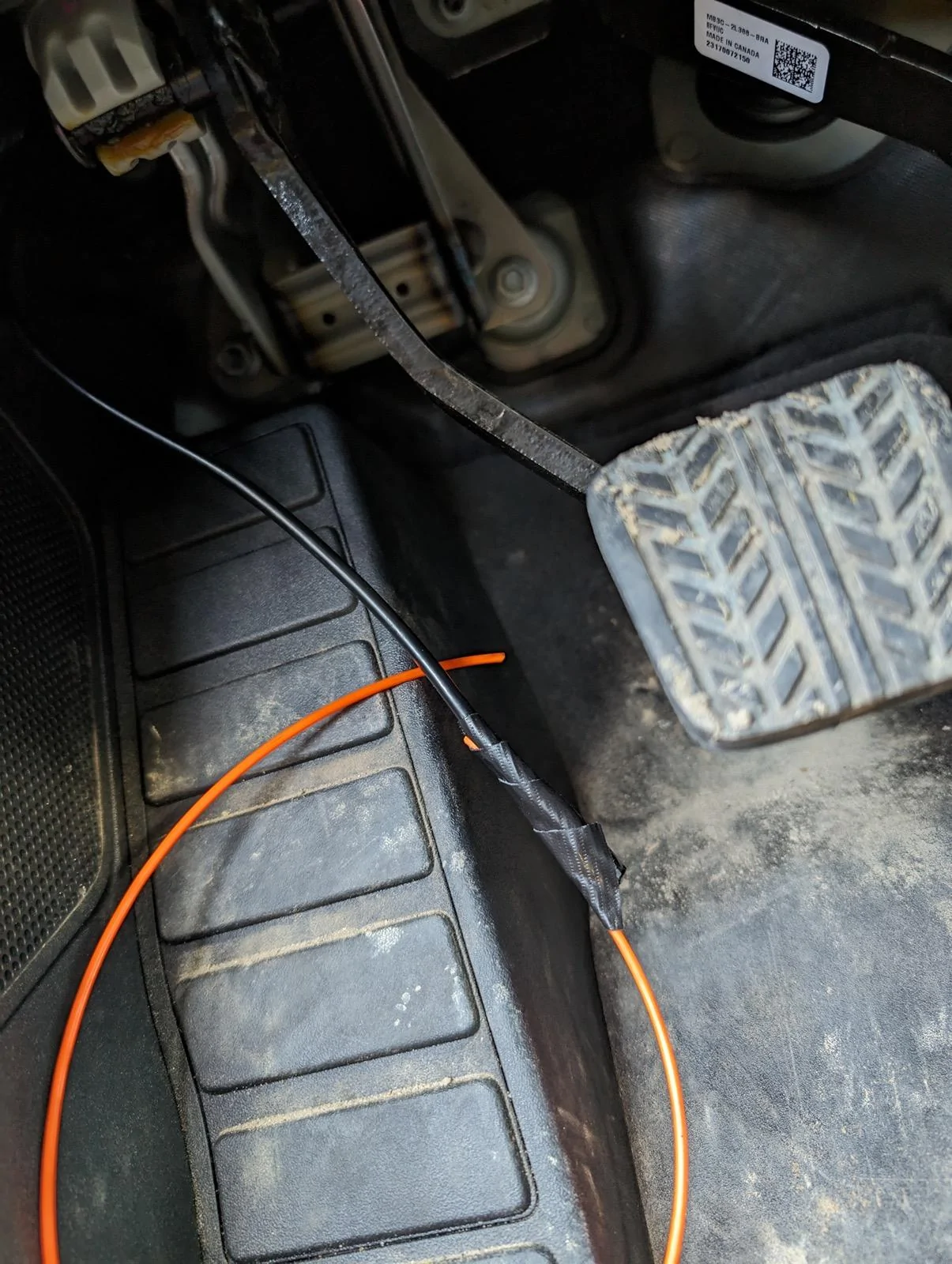

I used some marker grease to help move the wire through the grommet and a piece of weed whacker string to easily see it in the cabin:
Ford Bronco Firewall pass-through for power supply on 7MT. 1000001082-01
