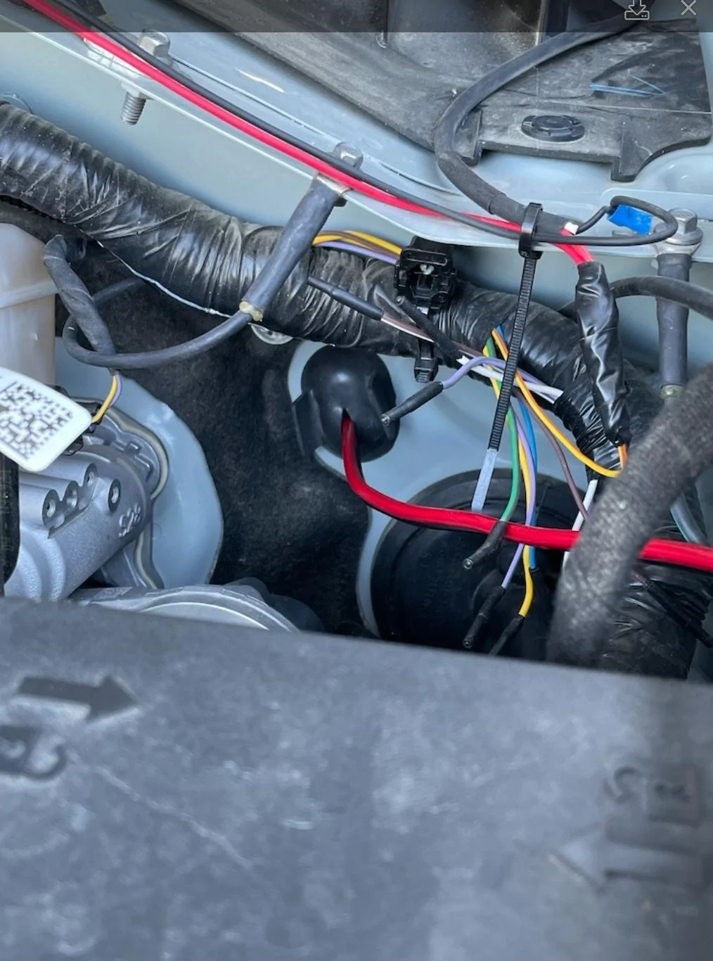

I commented on another post but has anyone cut the head off of this grommet to reveal a hole for passing wiring etc through the firewall cleanly?
Ford Bronco Firewall pass through for ?? test

Are you a 2.3L as well? Was looking for a clean way to pass wires through while installing my ghost antenna. The videos I've seen are all 2.7L and the tab up and to the left for them doesn't have the brake lines going through it.

Yes, Mine is a 2 Door Manual (2.3 of course) Badlands Sasquatch.

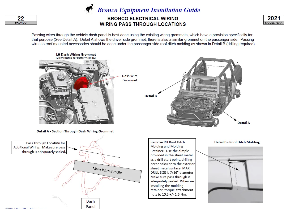

There's an oval shaped plug on the driver's side under the dash. You'll find it under the hood on the firewall opposite the fuse panel.
Ford Bronco Firewall pass through for ?? Screenshot_20221004_184215

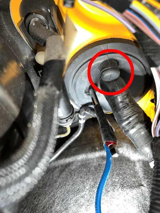

He's got a manual so that grommet has a line going through it.
@jdznutz,
I think your idea would work. I would pull the grommet out and see what lines up on the other side first.

thanks for confirming my theory!!
where’d you find this image?
its from the "bronco equipment installers guide", it was posted on the forum a while ago. super helpful document

Yea that's my point with the 2.3L MT - it looks like this.
Ford Bronco Firewall pass through for ?? 1664973351045
See the line going through the same plug in the top left. Ignore the red circle.
Jacob (@Lilj4425) shared a link to it about a year ago. Page 22 has the info @Mikerider posted. I just confirmed the PDF link still works, so you should be good to go.
