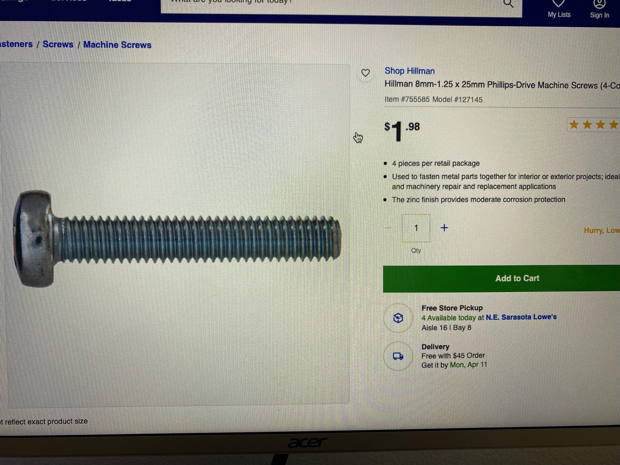

Yes I have mine mounted there. Since this photo I moved it to the other side because I have a battery charging system on that side now. But this is the type of bolt you use.

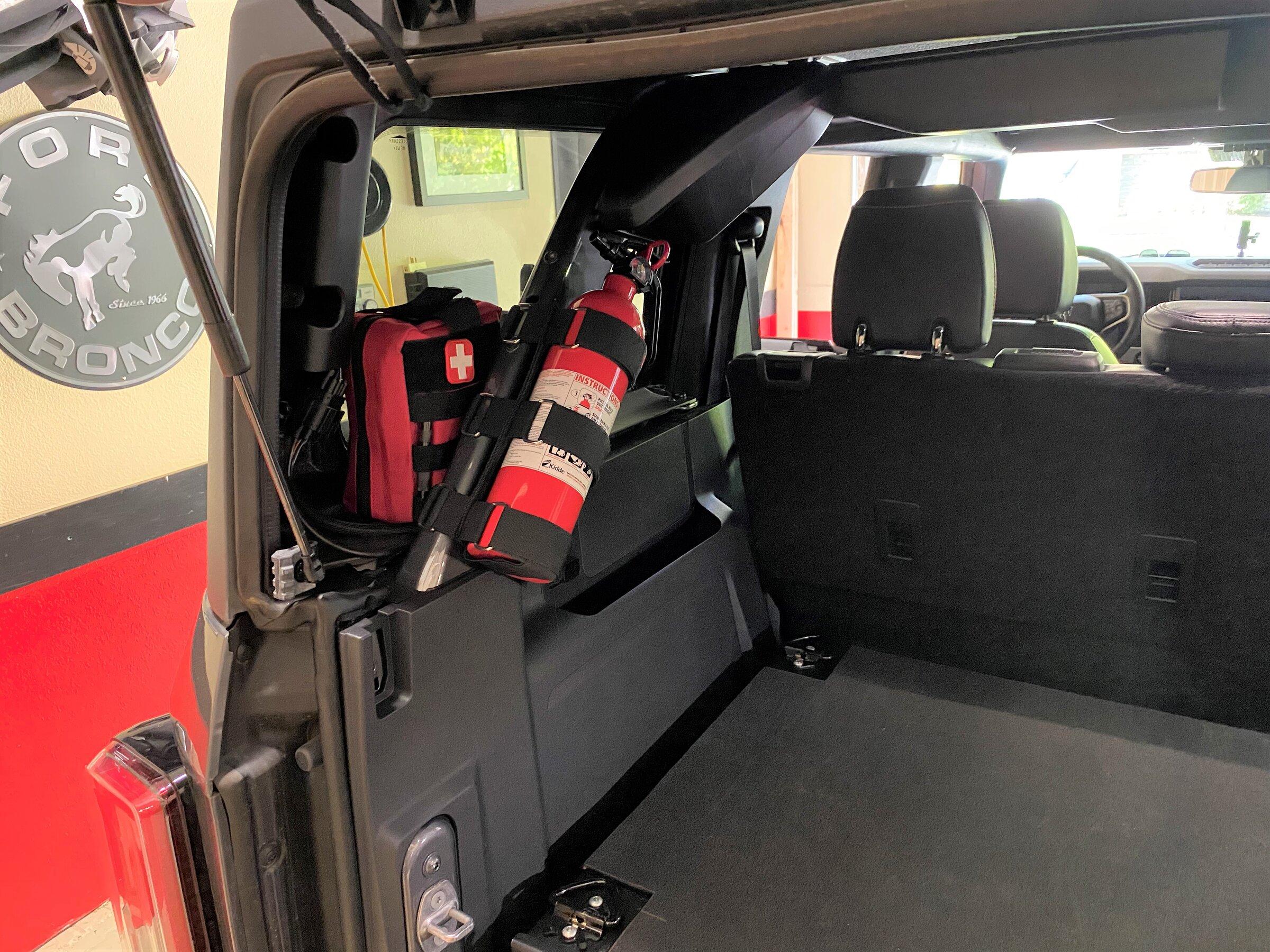

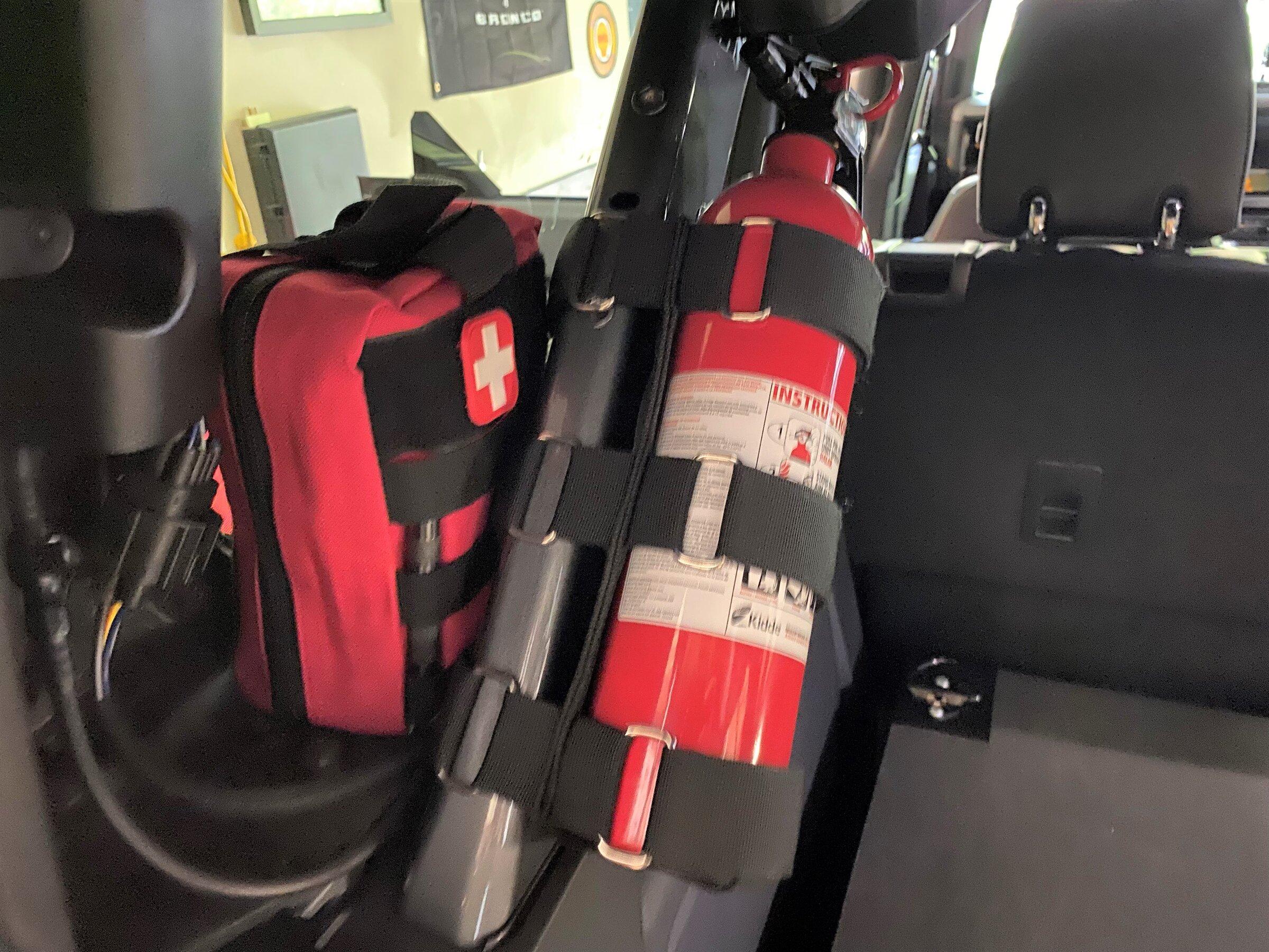

My late 2021 Badlands has them (11/12/21 blend date), so it isn’t just a 2022+ thing. Maybe it was one of the undocumented Job 2 changes implemented in late 2021, when the factory rolled in the Hard Top Prep Kit for the people changing their orders from hard tops to soft tops to get quicker deliveries? 🤷‍♂️
My quick release came in so I started designing an under seat bracket to mount it to. Hope to have it wrapped up today.
Since I saw these posts back to back, I have to ask, @JcrOffroad why are the round holes not lined up with the molle grid? I like my table but this always bugs me.
It’s an every other hole setup. Honestly, it comes down to cost savings. Reducing cut time on the laser.

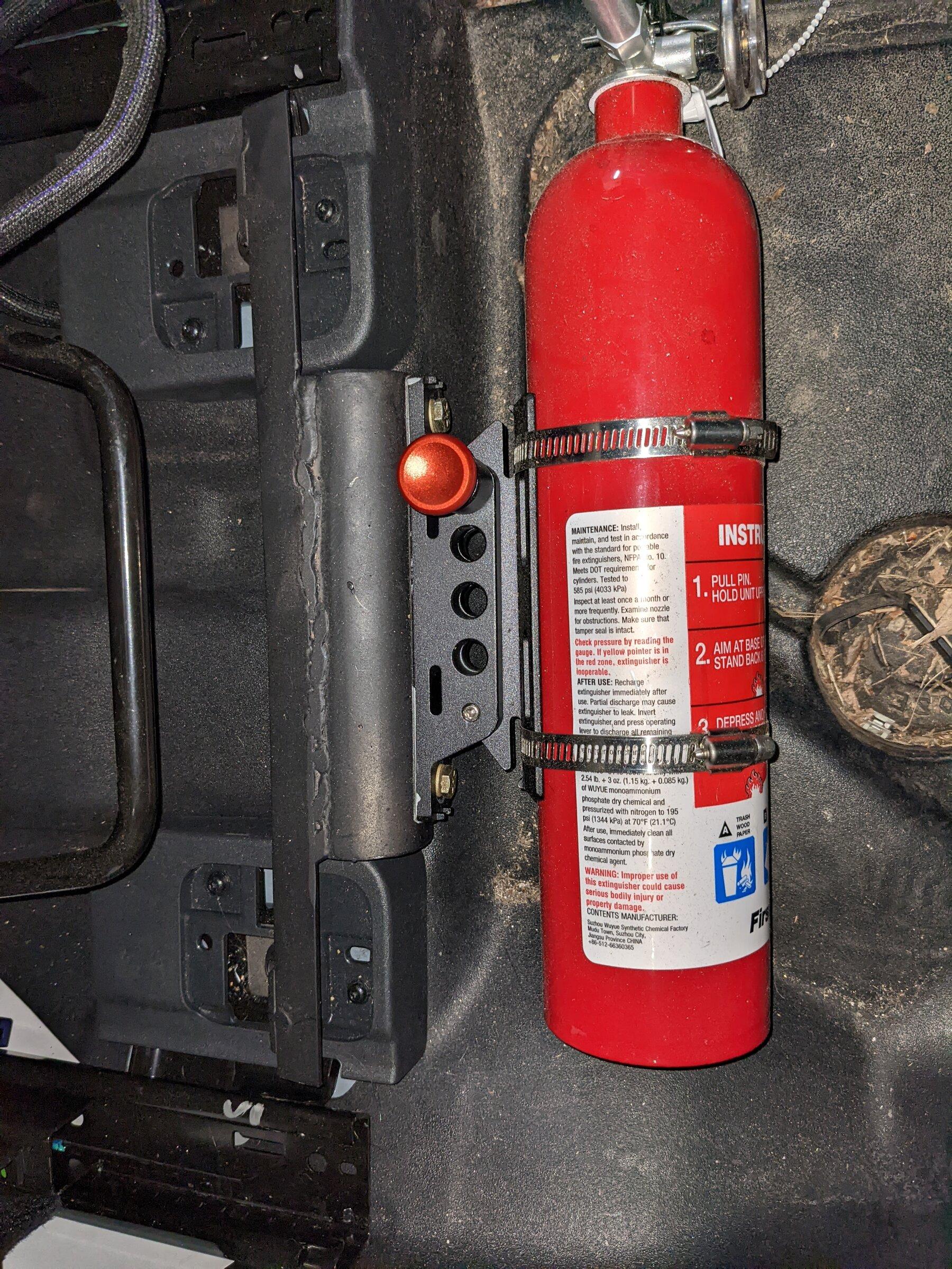

I made a mount that put's mine right in front of the driver's seat, tied to the seat rails, But I don't have pictures of it at work, I'll try to remember to post some this evening...
I'd like to see that. I'm attaching it to the rail release handle myself.

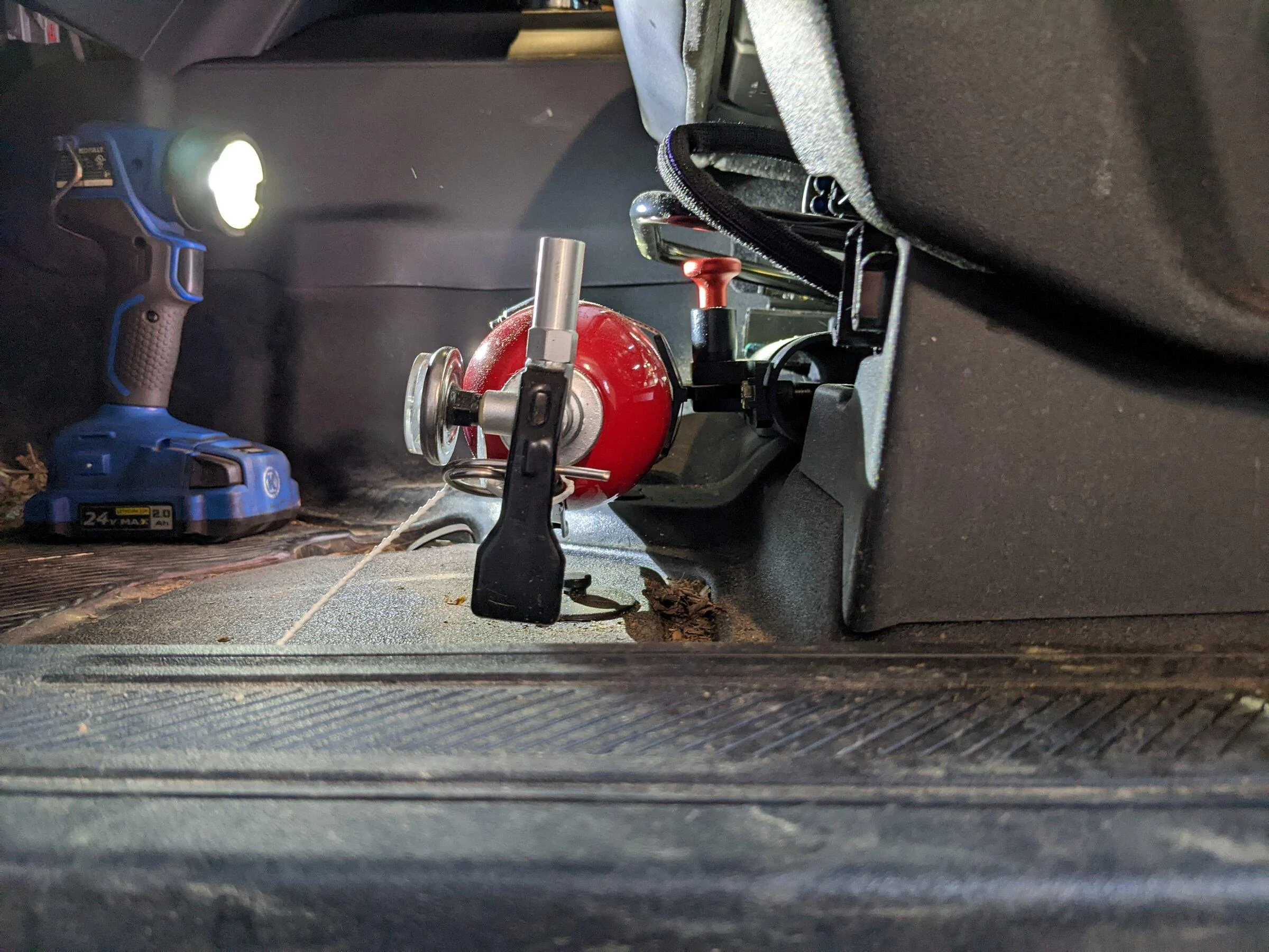

I took a piece of DOM just long enough to fit between the rails, then made some brackets and welded them to it so I could put them under the front bolts of the rails, then I bolted one of these to the DOM;
https://www.amazon.com/gp/product/B082CNTJVV
To make it a quick release.
You have to be mindful of the knob when moving the seat back ward and forward so you don't pinch your hand, but everything clears without issue...

Sorry, really hard to get good pics in that small dark space, Lemme know if there is anything I can clear up..

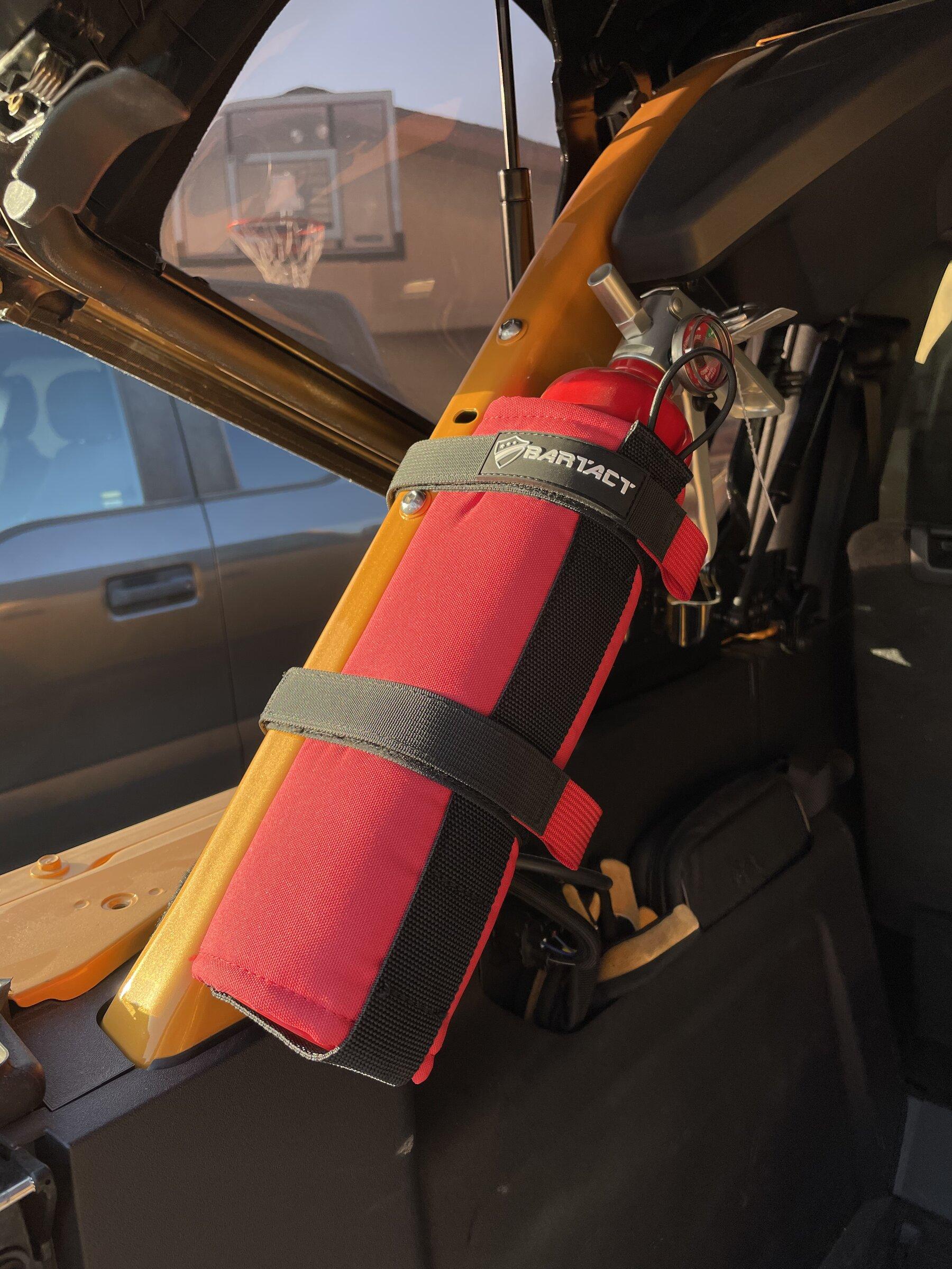

2.5 lb. Amerex ABC and Bartact mount. I like that I can just pop those two red ends of the Velcro straps and the whole thing releases instantly. The bottle can just stay in the bag while you use it.
I'm still going to get an Element to keep up front...
