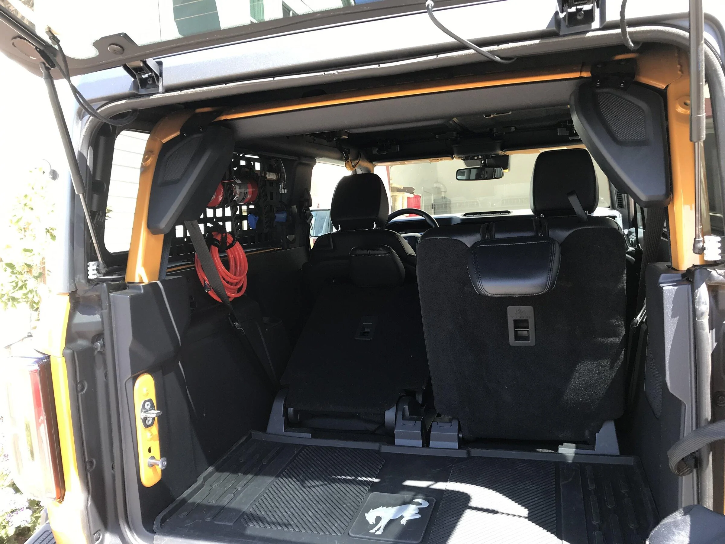

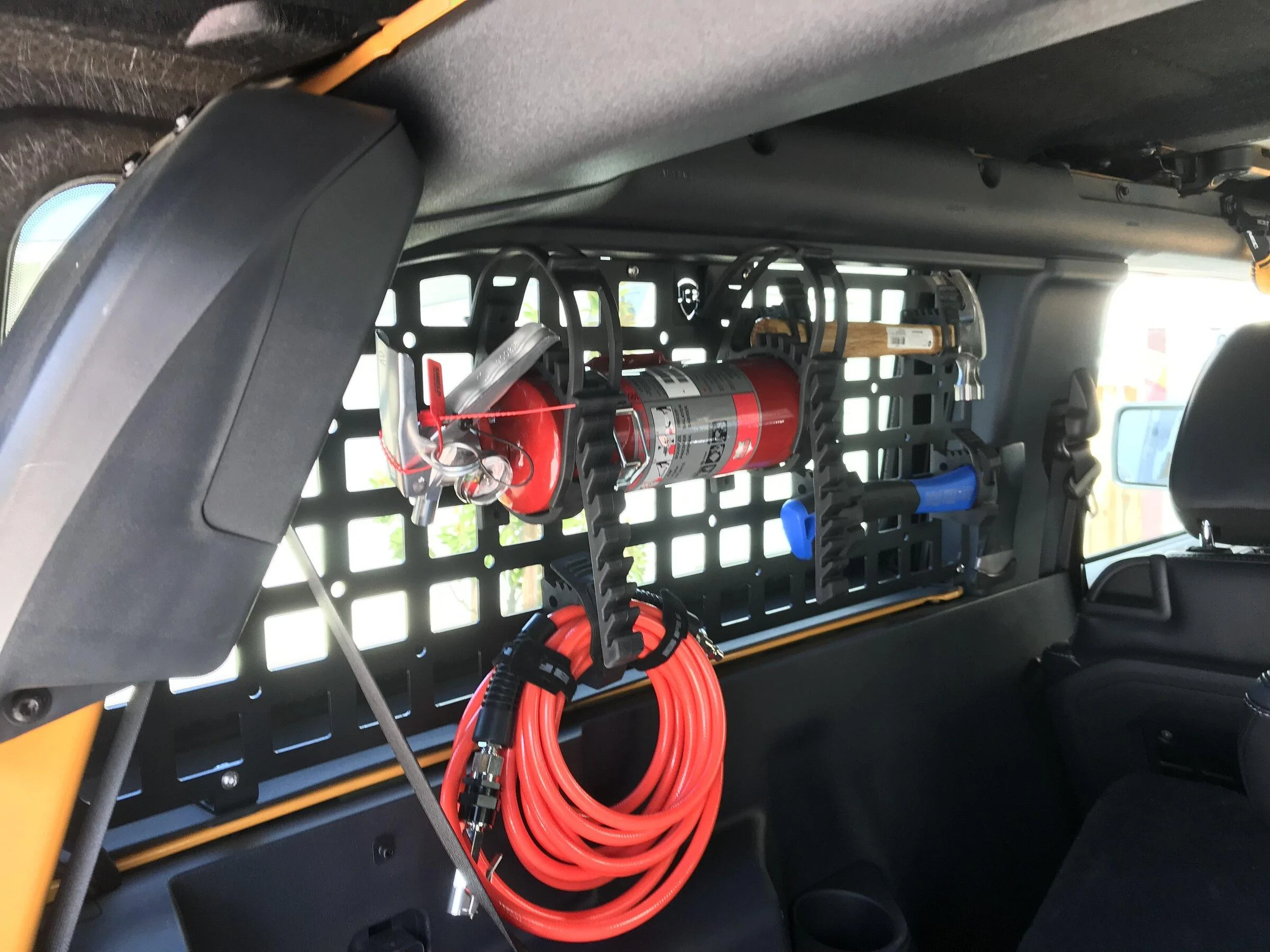

I have a two door, and I attached my fire extinguisher to the JCR rear window molle
panel with a quick fist attachment.
Where did you get that window Molle grid? Thanks in advanced

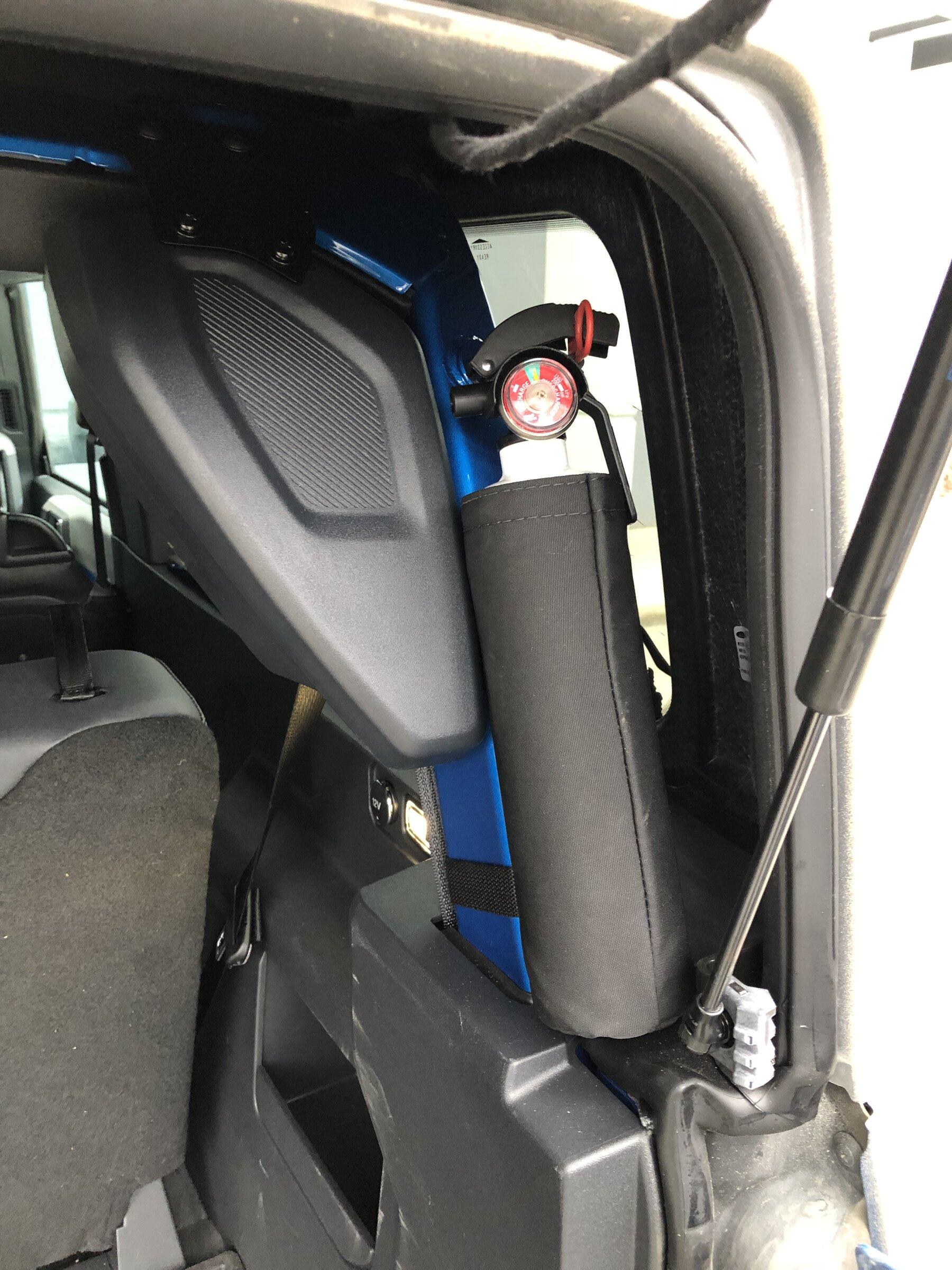

Mounted mine on roll bar, 2 door
Sorry for the strange question, but how quick/easy is it to remove the extinguisher from the bag in this setup?
Cant quite tell but there's probably an upper velcro strap slipped between the speaker and sports bar, and you can't slip the extinguisher up unless the roof is off.

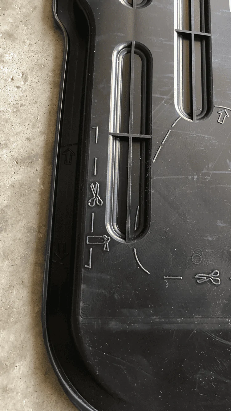

I'm curious if your rear rubber mat has a picture on the passenger rear underside indicating a cutout spot for a fire extinguisher. My same mat for the four door has the dotted outline showing where to cut the mat to accommodate what I assume is a bracket for a fire extinguisher. I haven't seen anything from Ford dealing with a factory mount though.
You are right, I did run the upper strap between the speaker pod. I tested after install though, you can still remove the extinguisher from the holder with the roof on. Just need to angle it slightly as it comes out, the holder isn’t stiff so it allows for some movement
Just a heads up, that looks like a recalled Kidde extinguisher. Here’s a link to see if yours is affected: https://www.kidde.com/home-safety/en/us/support/product-alerts/recall-kidde-fire-extinguisher/
Thanks, I’ll look into that

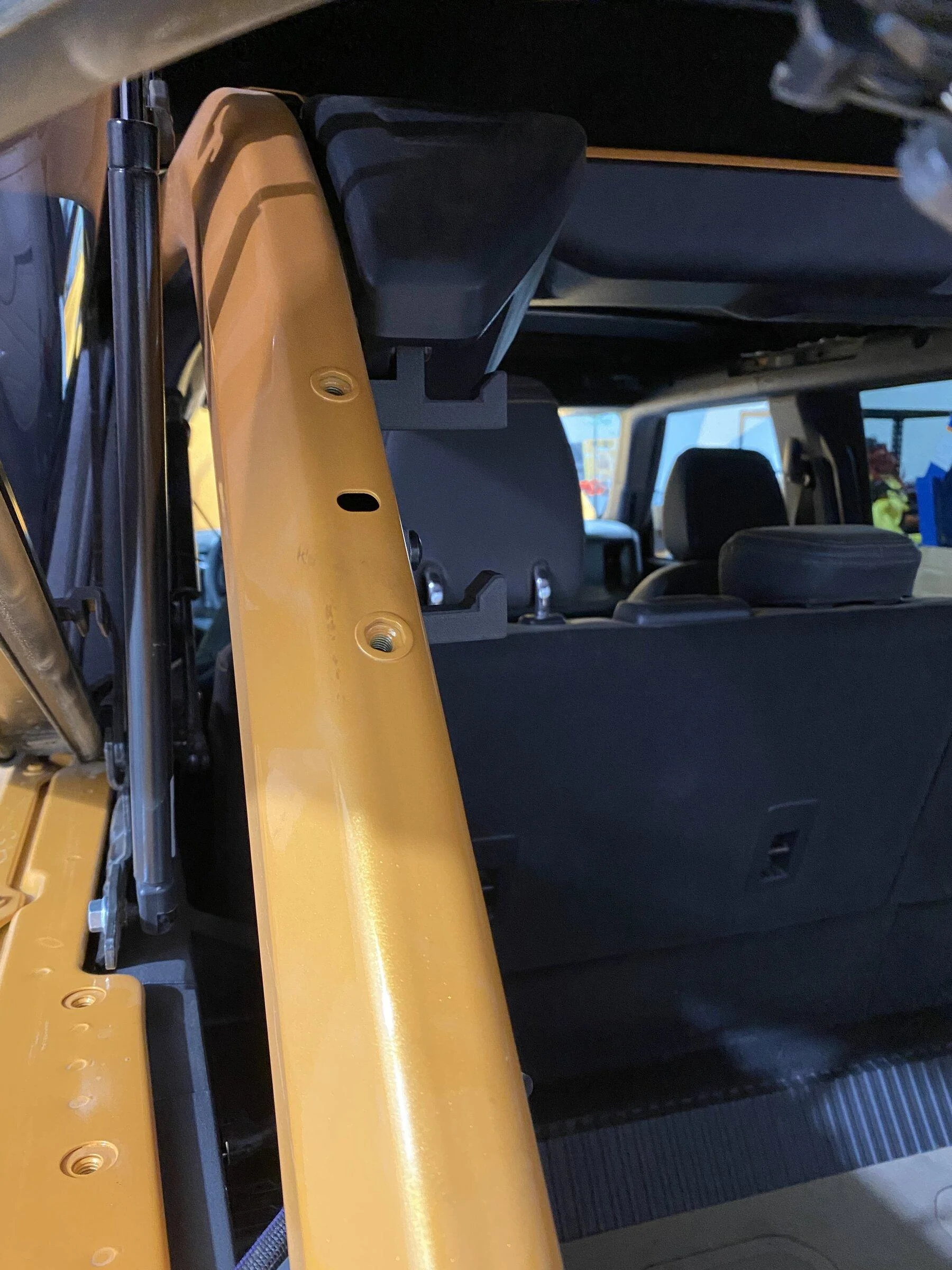

I’m curious if anyones bolted anything to the rear roll bar, where those two exposed holes are. Seems like a logical spot.
We were looking at making a mount for these threaded holes. We stopped when we noticed our Badlands didn’t have those provisions but our wildtrak did.
My BL has those threaded holes. Believe it's a 2022+ thing.

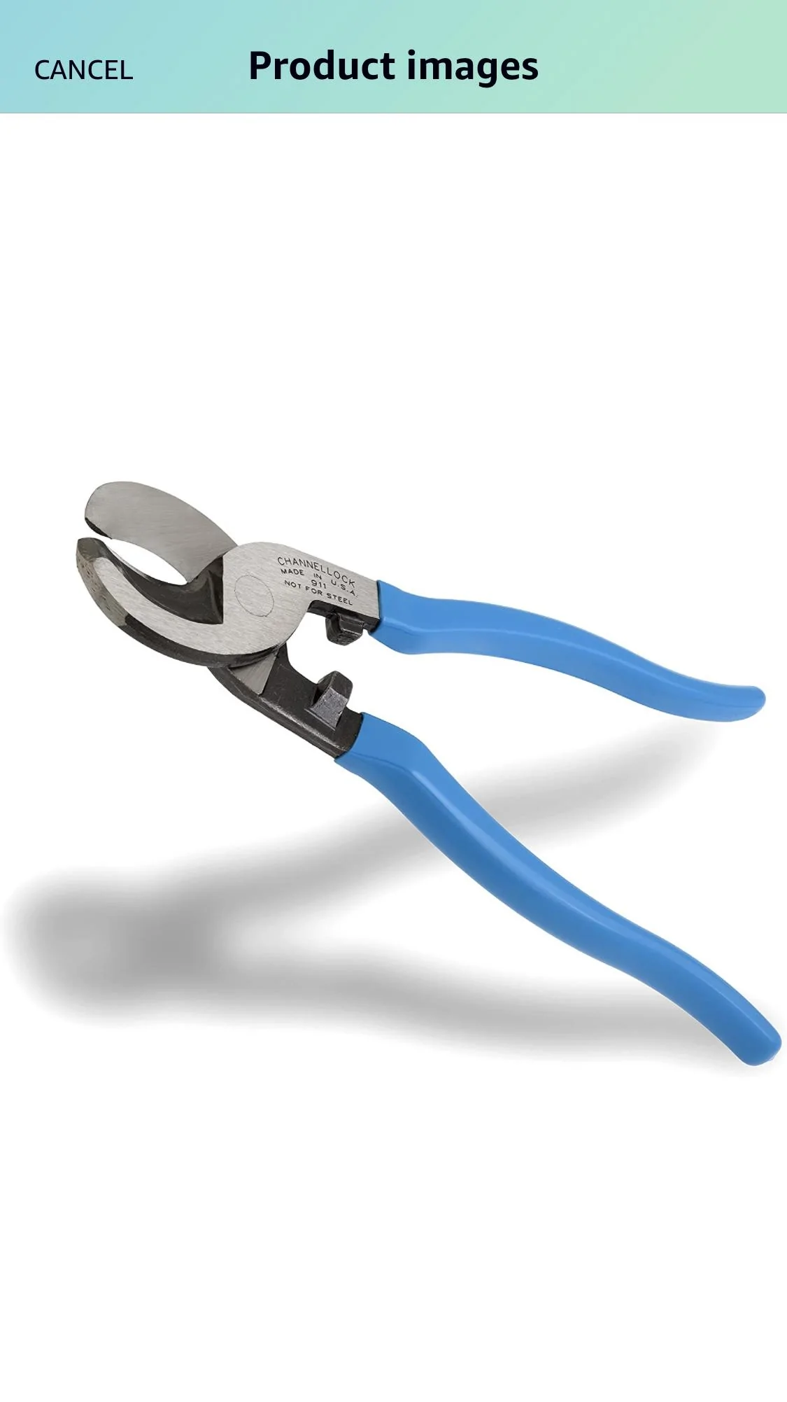

I helped out a Wrangler that caught on fire in front of my shop once. I think it was a yj or tj. It took something like 3 5 pounders and one 10 pounder. Then the fire department put an oversized garden hose on it for 5 minutes. Keep that in mind when you’re looking at these 2 lb bottles.
They’re better than nothing, but a pair of cable pliers to cut the battery terminal is quicker in an electrical fire and sand or oil absorbent can sometimes do it too.
Just my $0.02
edit: I’d get a pair of these.

My late 2021 Badlands has them (11/12/21 blend date), so it isn’t just a 2022+ thing. Maybe it was one of the undocumented Job 2 changes implemented in late 2021, when the factory rolled in the Hard Top Prep Kit for the people changing their orders from hard tops to soft tops to get quicker deliveries? 🤷‍♂️
