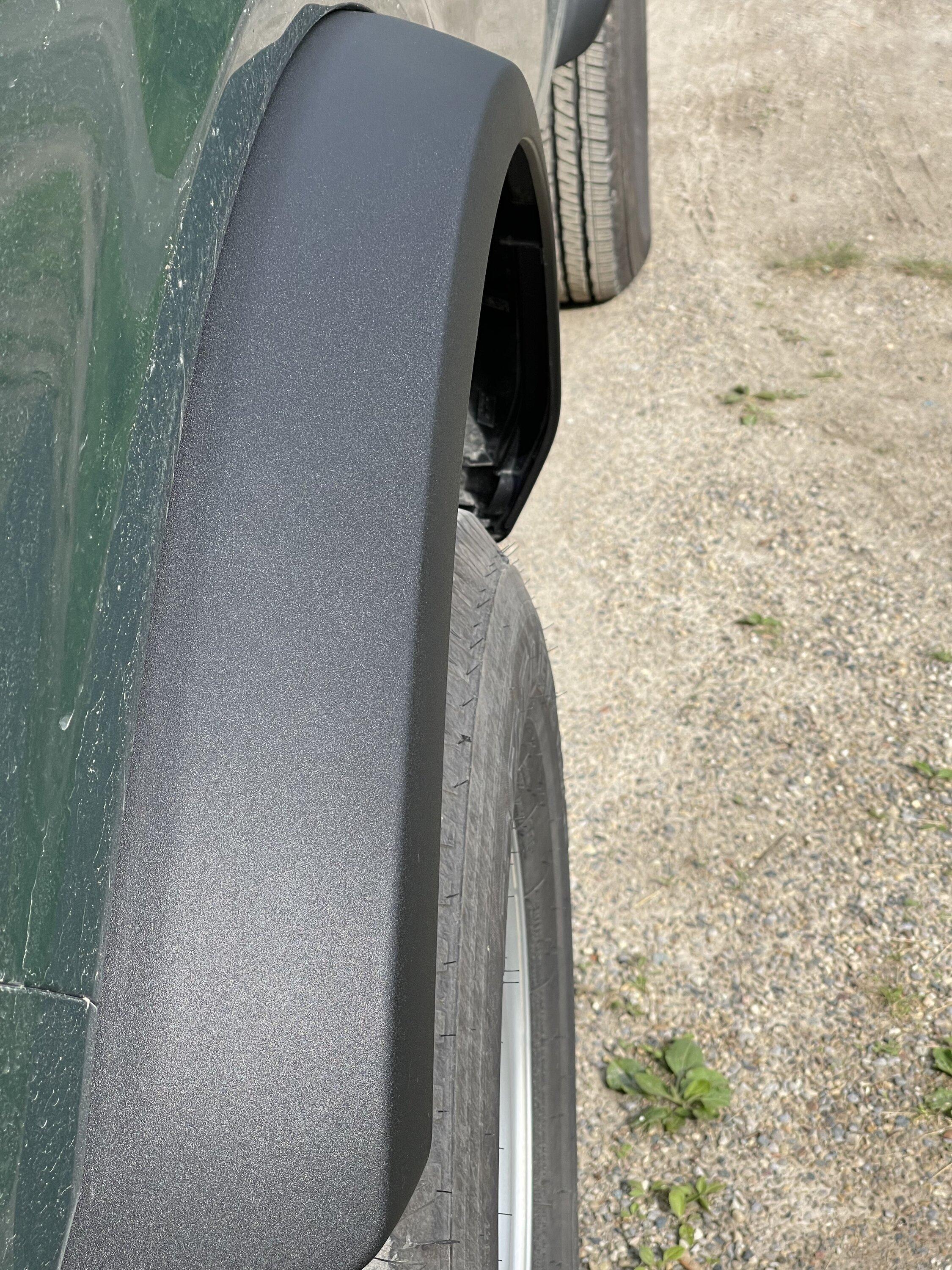

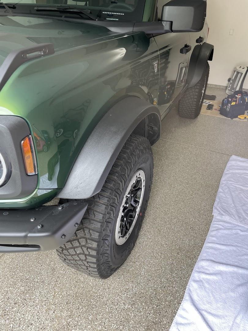

Hey guys, I just got done both cleaning and ceramic coating my fender flares because, well, they looked pretty terrible even right after washes with tons of chemical stains. I unfortunately didn’t take any close ups of just how bad they were but they came out fantastic considering!
I’ve heard you can use Scrubbing Bubbles however I just used Dawn dish soap and a sponge and scrubbed them off really well. Then I prepped them and applied Adam’s Polishes Ceramic Graphene coating. I’ve had great luck with Adam’s products in the past so I’m sure they will look good for a long time now.
I was surprised how many little rock chips there were already in only 6,000 miles. I think the rest of the Bronco is screaming for some ceramic next!

Did you remove the fenders to clean and coat?

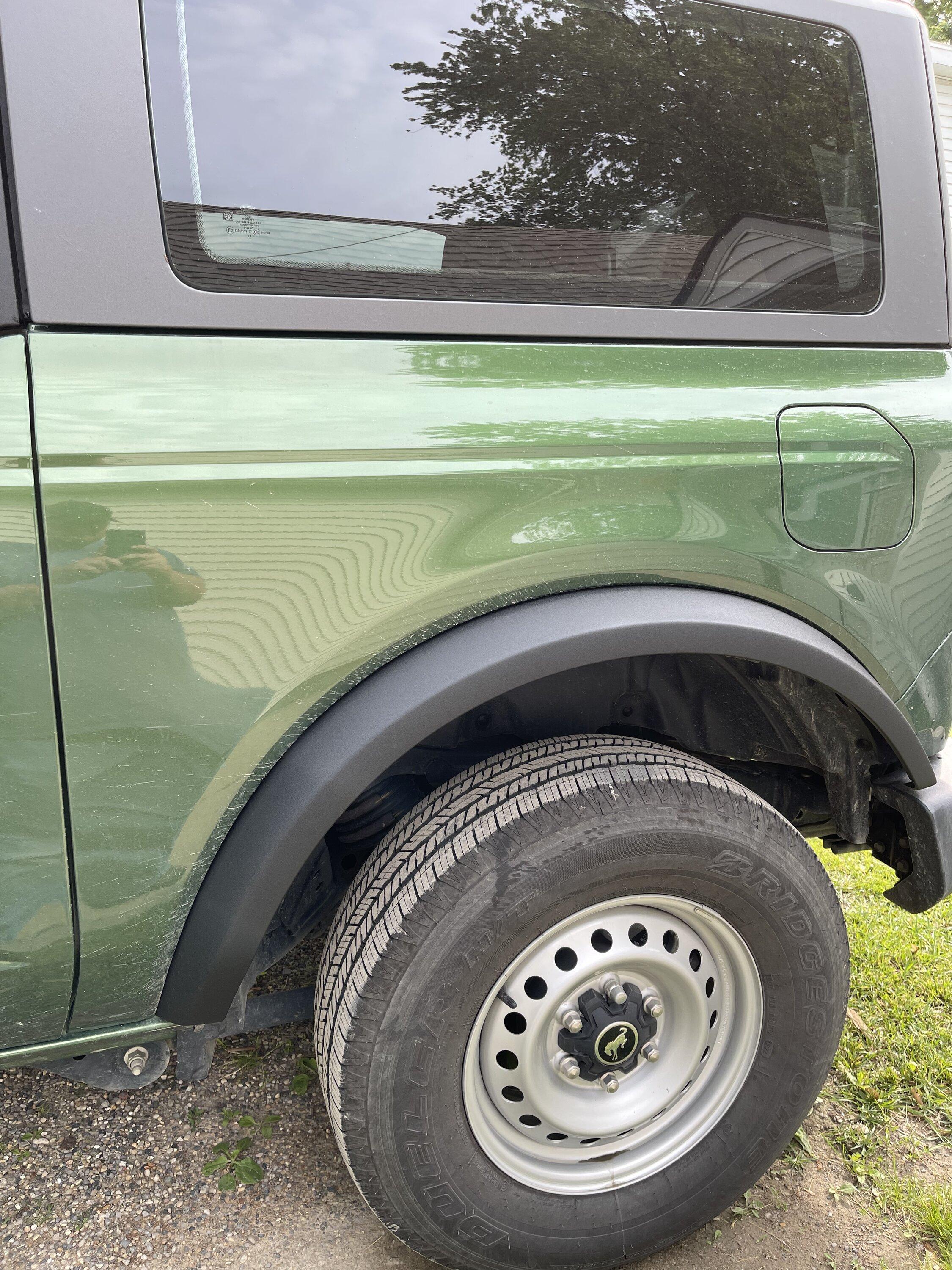

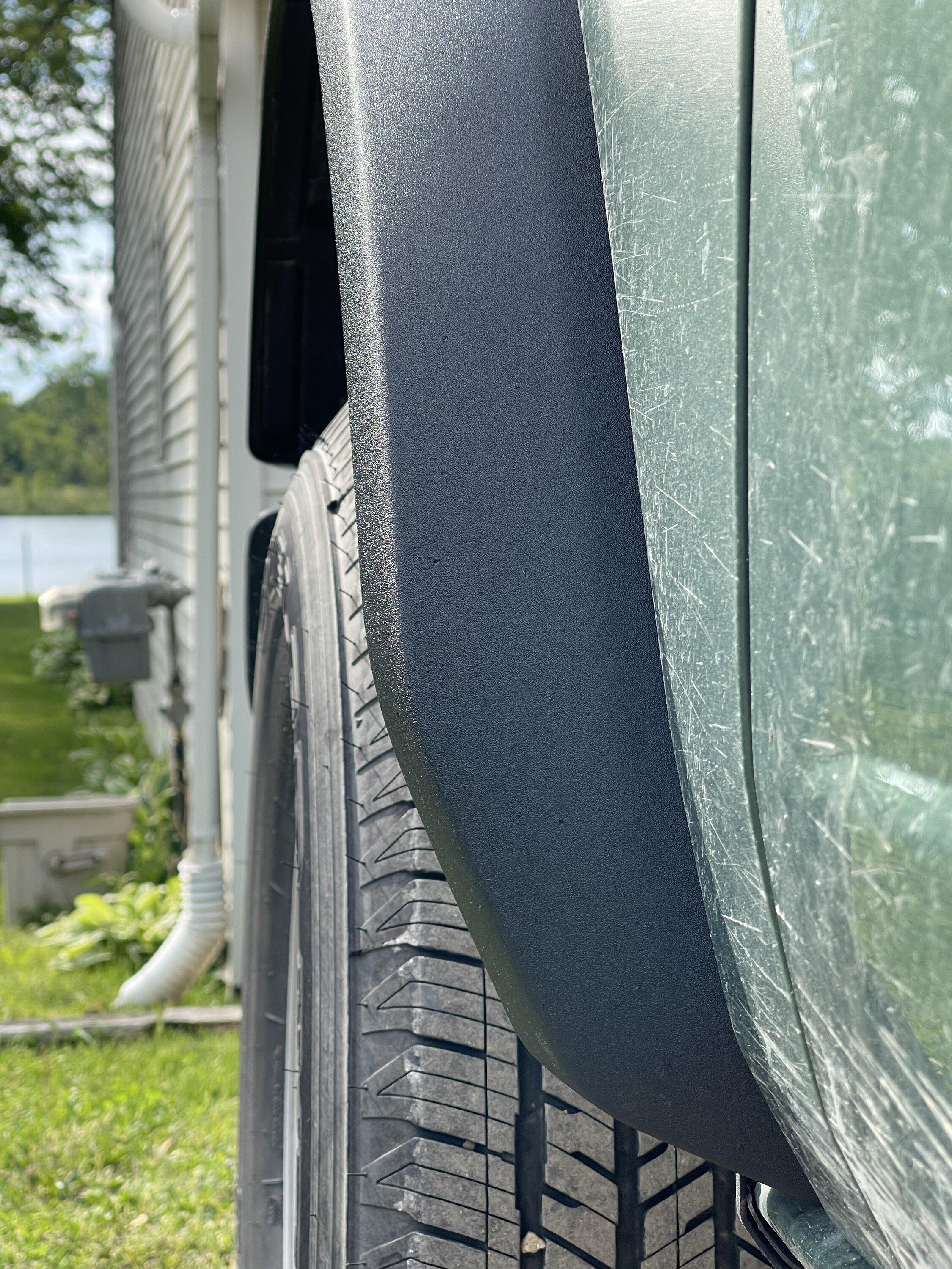

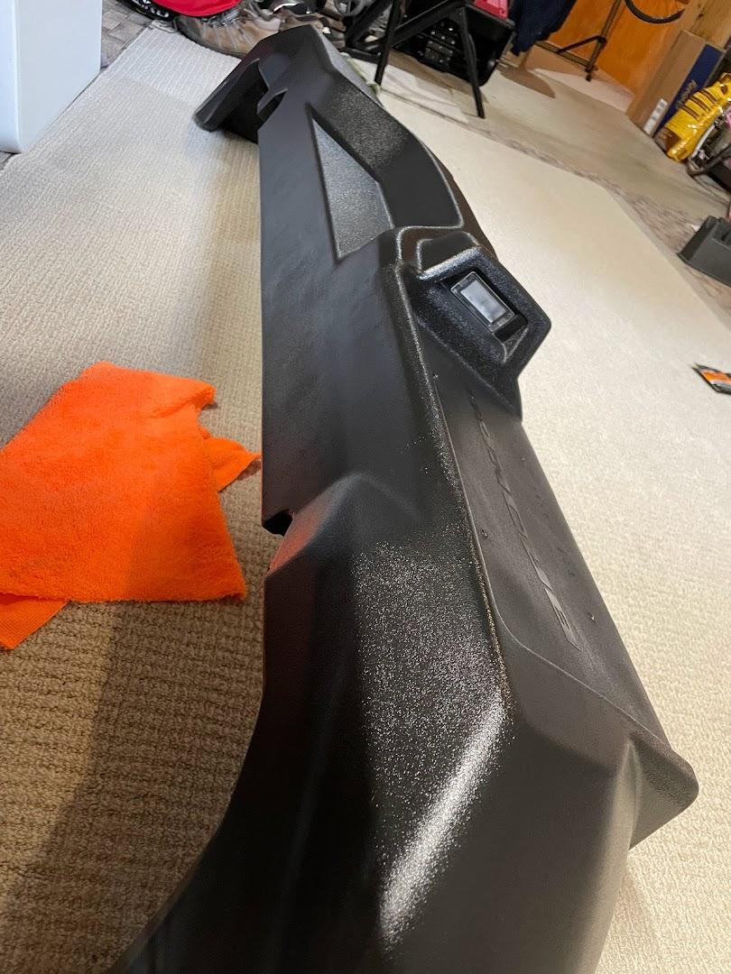

Looks great! I did something similar with my fender flares and rear bumper using Cerakote (ceramic coating very similar to Adams). I'd recommend that owners Cerakote or ceramic coat (with a product of their choice) all of the black mic pastic on the exterior.
EDIT: Don't touch your MIC top with anything......because, well.....
Two tips/notes:

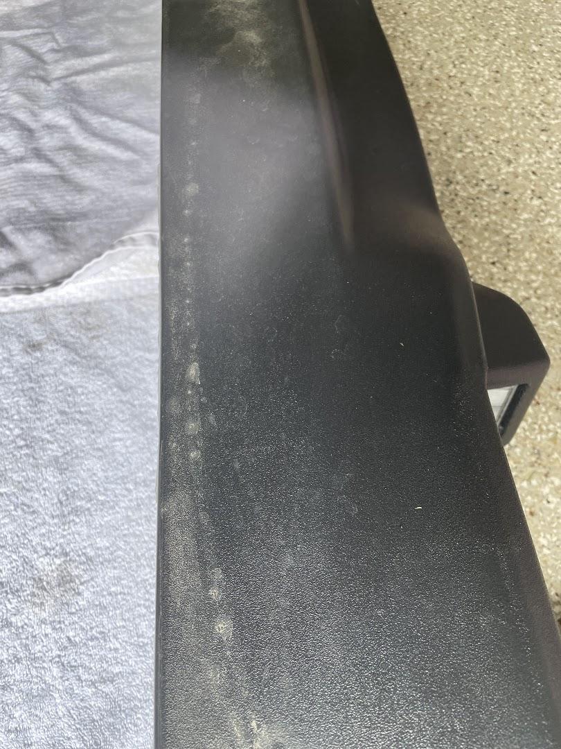

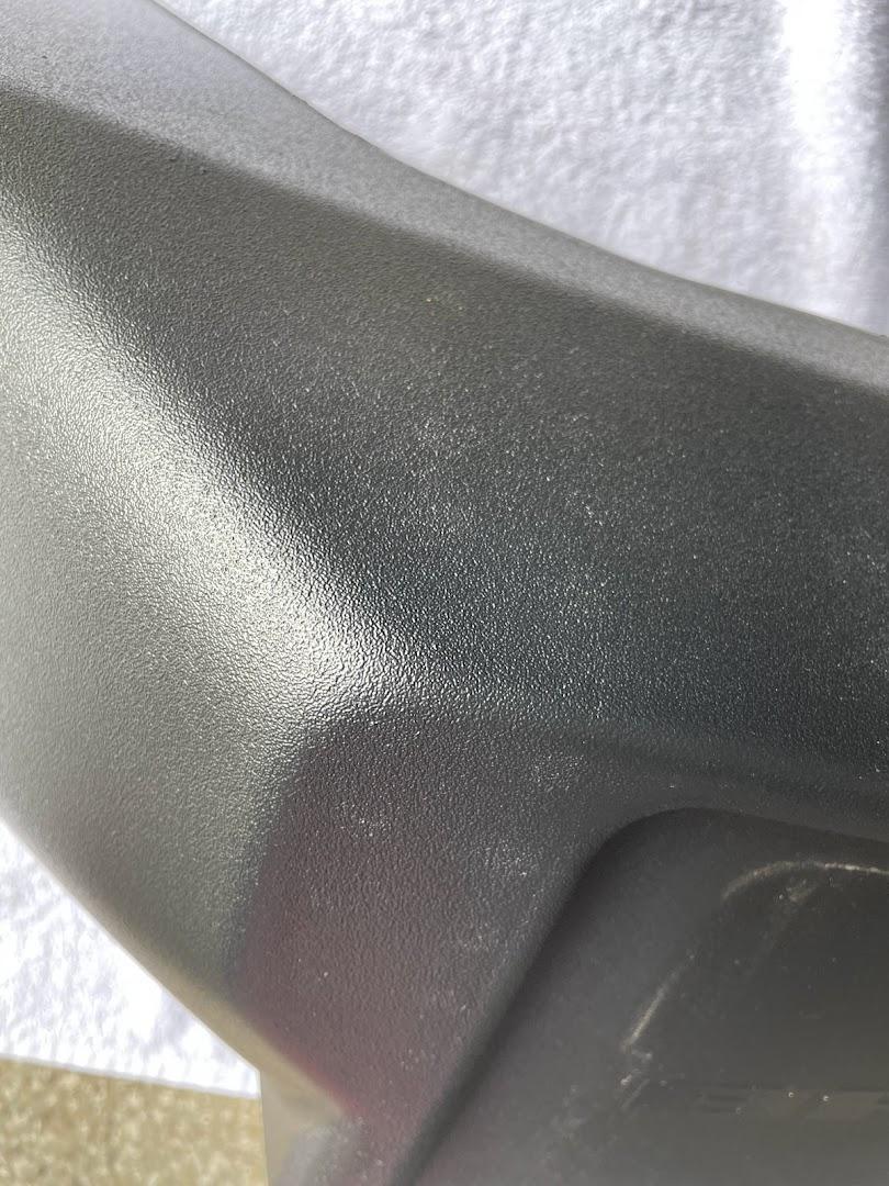

1. When washing your fenders, bumper, or plastic be sure to not just apply the dawn soap directly to the plastic and start scrubbing. The "power" of Dawn is activated with suds (hence their power wash formula). So either Dawn in a bucket and fill it with a hose on jet to generate the suds OR buy a foam soap dispenser (or save one from your hand wash) and fill it with 50% dawn and 50% water - boom - powerwash.
2. Once done washing the parts make sure they are absolutely dry.
Ceramic coating does not adhere well to dirty surfaces and it ABSOLUTELY DOES NOT mix with water. The presence of water will leave you with white spots or streaks that will be even more difficult to remove.

Yes I did, it was a piece of cake! There is 5 locking pins on each flare that you turn until you feel a small detent letting you know they’re square with the holes, then you just pull strait out. Putting them back on is the same only in reverse.

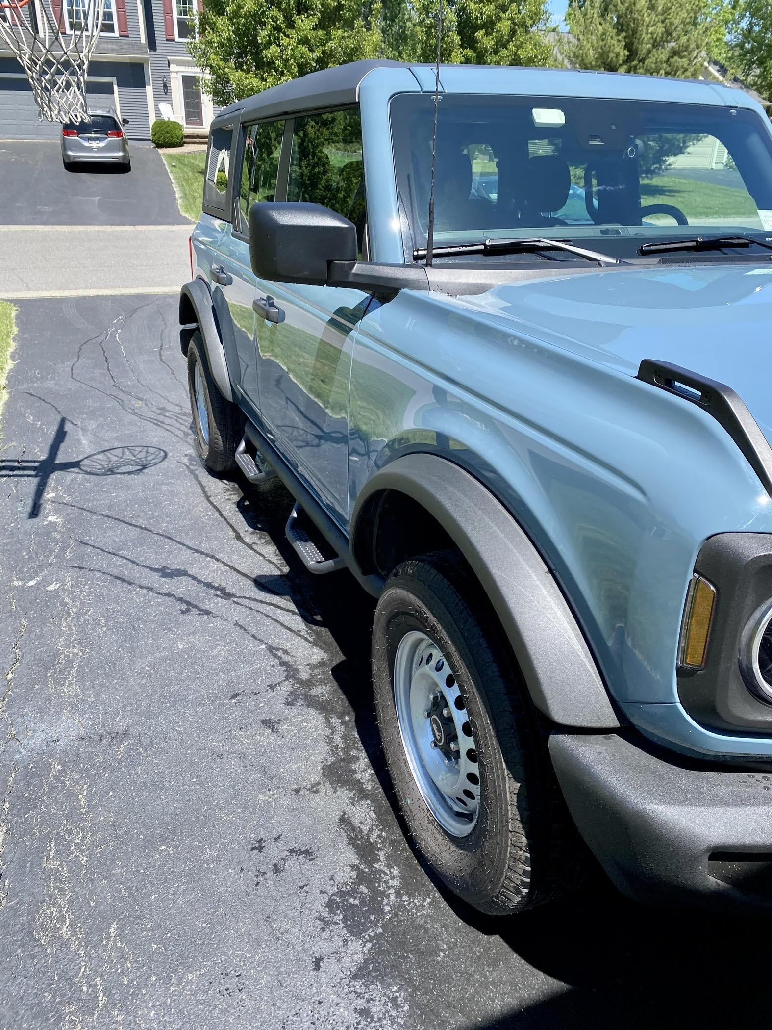

Ceramic coating looks like a good option. I took delivery of my bronco during pollen season and Day 2 I had to do something about the pollen streaking and mud stains after Day 1.
I have been through a fair number of rubber / vinyl cleaners and protectors... I haven't used any of Adam's products. So far, I can only recommend Turtle Wax 50655 Inside & Out Protectant, 23 Fluid Ounces of the ones I've tried.
It goes on easy with a micro-fiber towel for the fenders, mirrors, interior... and I've used it on the MIC. Just apply without washing and it keeps the pollen stains away. Reapply as needed (like every 3 weeks, or less if you're parked under a flowering tree). Bugs wipe off with a towel. There is a lot of rubber/vinyl on the base, including the grille, so this has helped me a bit. I've been using this product since April '22 on MIC and seems fine.
