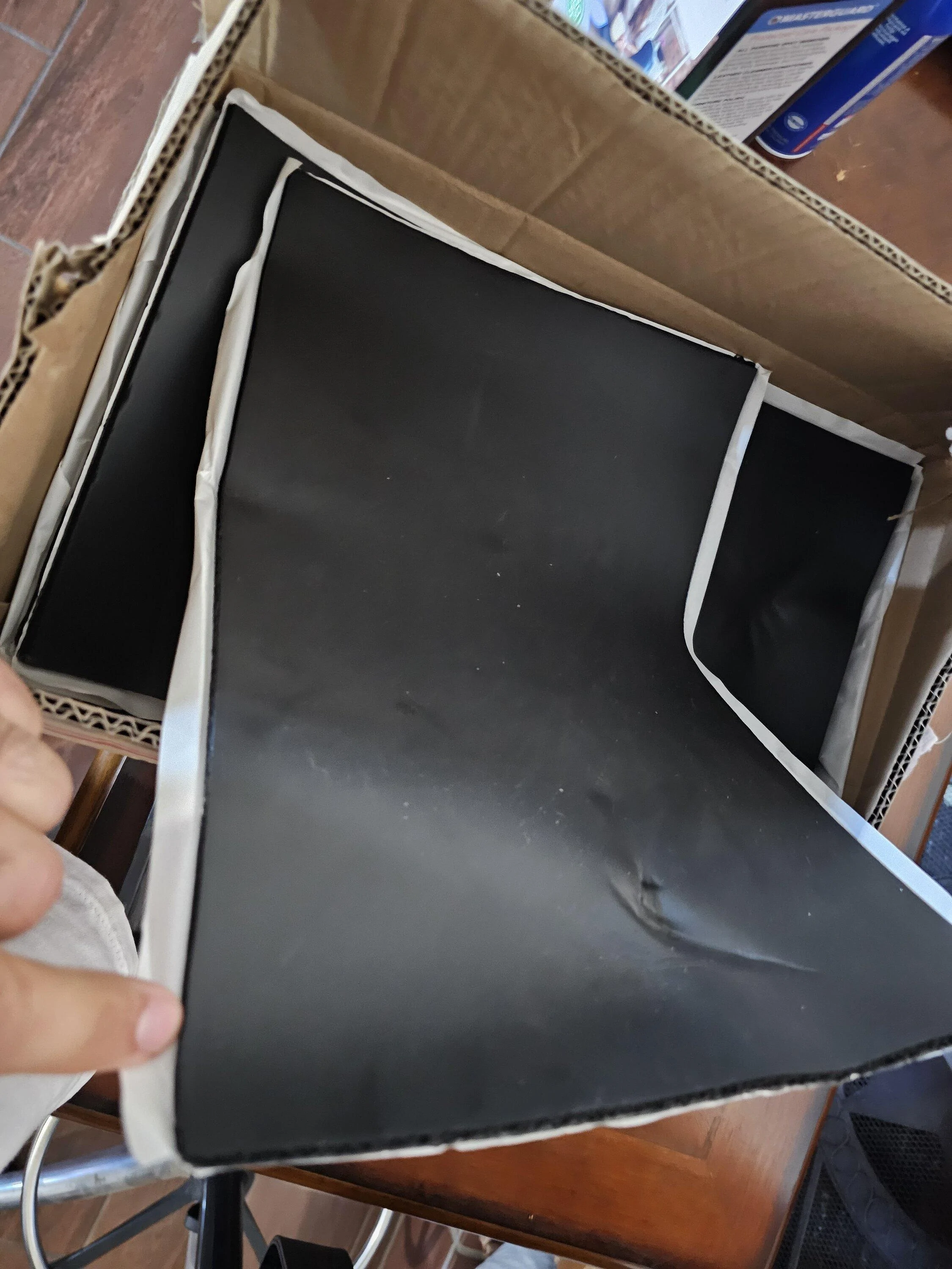

I bought this sound deadening mats off Amazon to cover the back area of the hard top that did not have the factory sound deadening, I was going to do the cargo floor while I had the plastic out..I will do the back side of the trim panel and fender as well.
Not sure how good this stuff is but I guess its better than nothing.
