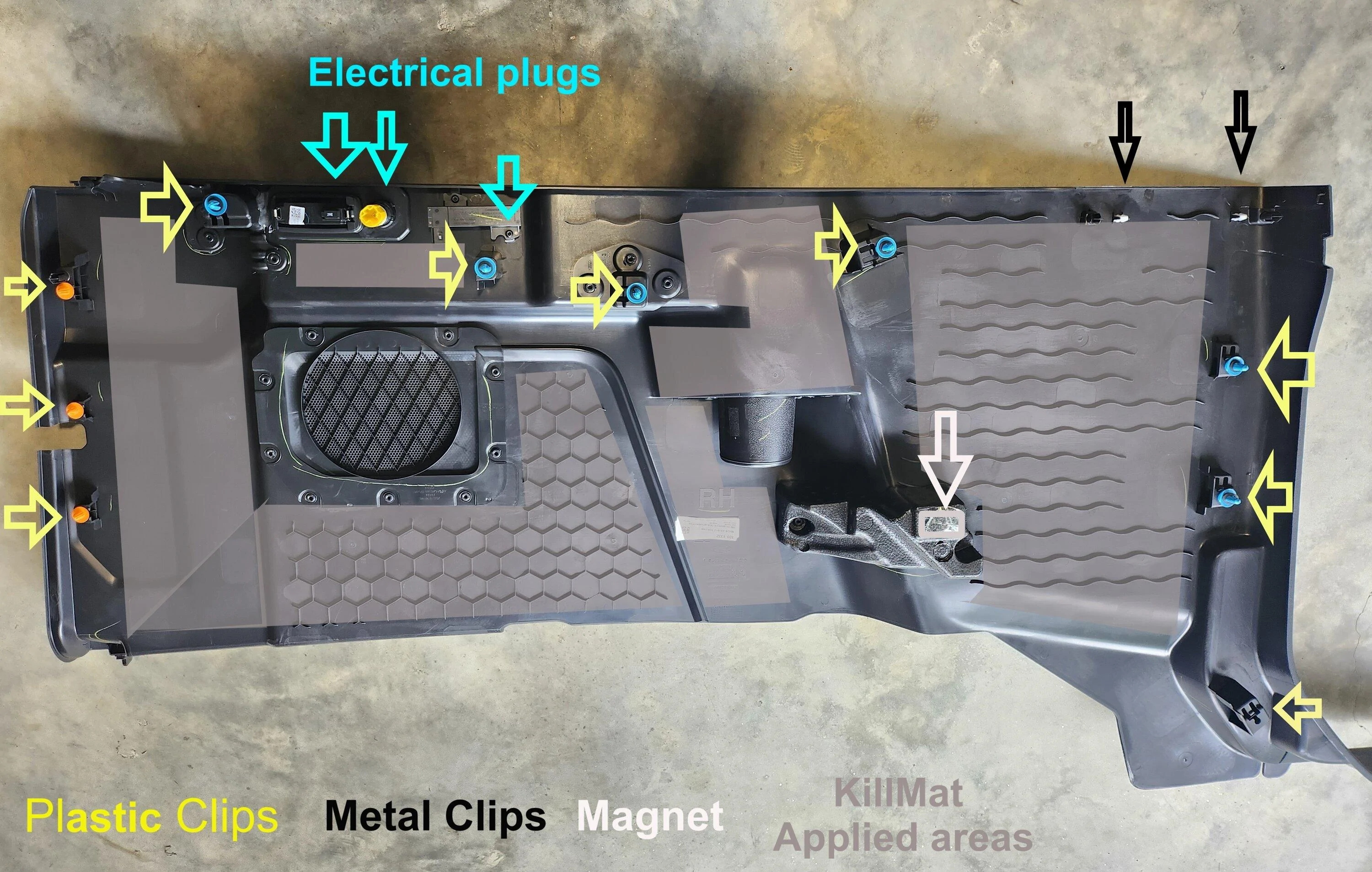

Basically clean area with alcohol , peel and stick with firm pressure .
This is the areas I did with KillMat and the greyed out area of the trim panel since I did not get a pic of that . Prevents any rattles from the subwoofer and deadens the outside noise from the inner fender area.
