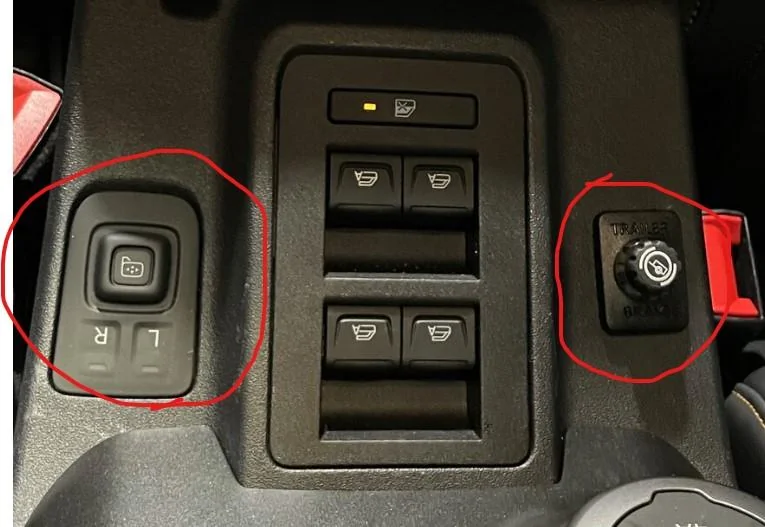

Did you realize you mounted the switch upside down? Not oriented the same as the other switches.
🤣 I wondered if anyone would say anything. I like to think all the others are upside down and mine is correct.
