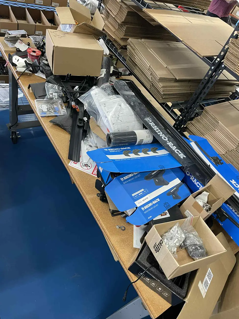

You should see our warehouse sometimes. We have "Adam Shelves" and "Adam benches" which is full of stuff i've hoarded over the years. Wiring harnesses galore, lights, rack accessories, rubber isolation boots, more brackets, more harnesses, more lights, nuts and bolts beyond belief. It's a complete mess of stuff :)

Extra points if you're organizing them in old baby food jars. That's a dad hack right up there with hoarding stuff for the "you might need later" moments.

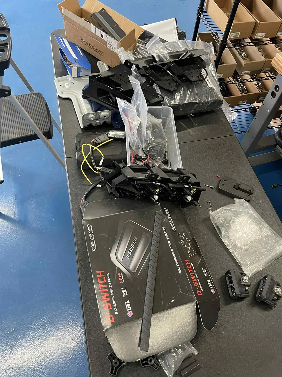

So yeah that pigtail you sent me is probably SOMEWHERE burried in here. This is just 2 of a few spots my "projects" land on. ONE day I swear I will go through it all.
But we DO keep hardware pretty organized. Here is our hardware cart which we use for all of our KR Off-Road kits. Everything is color coordinated (there are cheat sheets on the bottom shelf you can see) and we also list the quantity and part # from our suppliers. So the stuff we sell is organized but when it comes to my R&D stuff... YEAHHHHHHH that's all over the place :)
If I had to organize that, I'd just set it on fire! 🤣

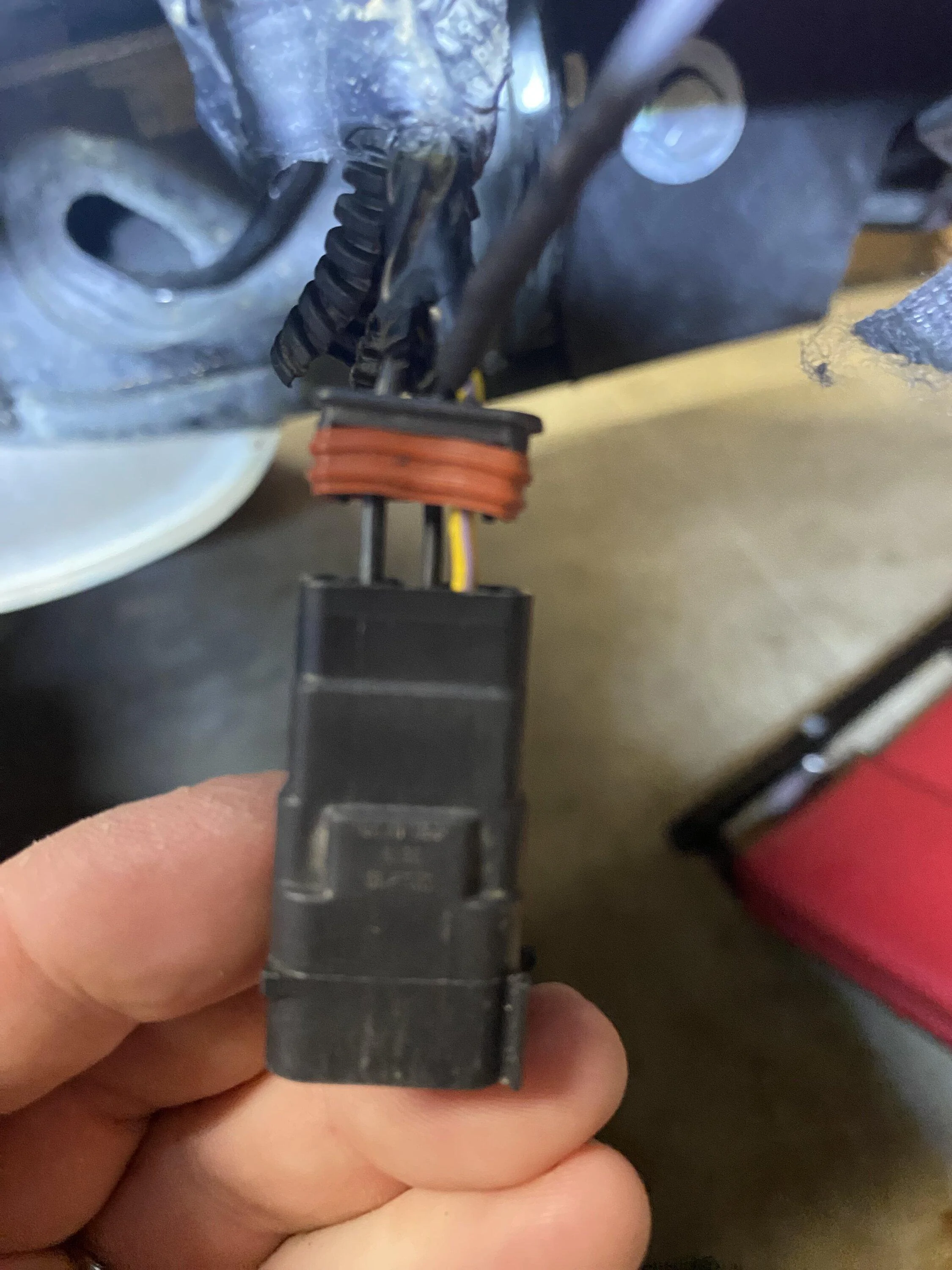

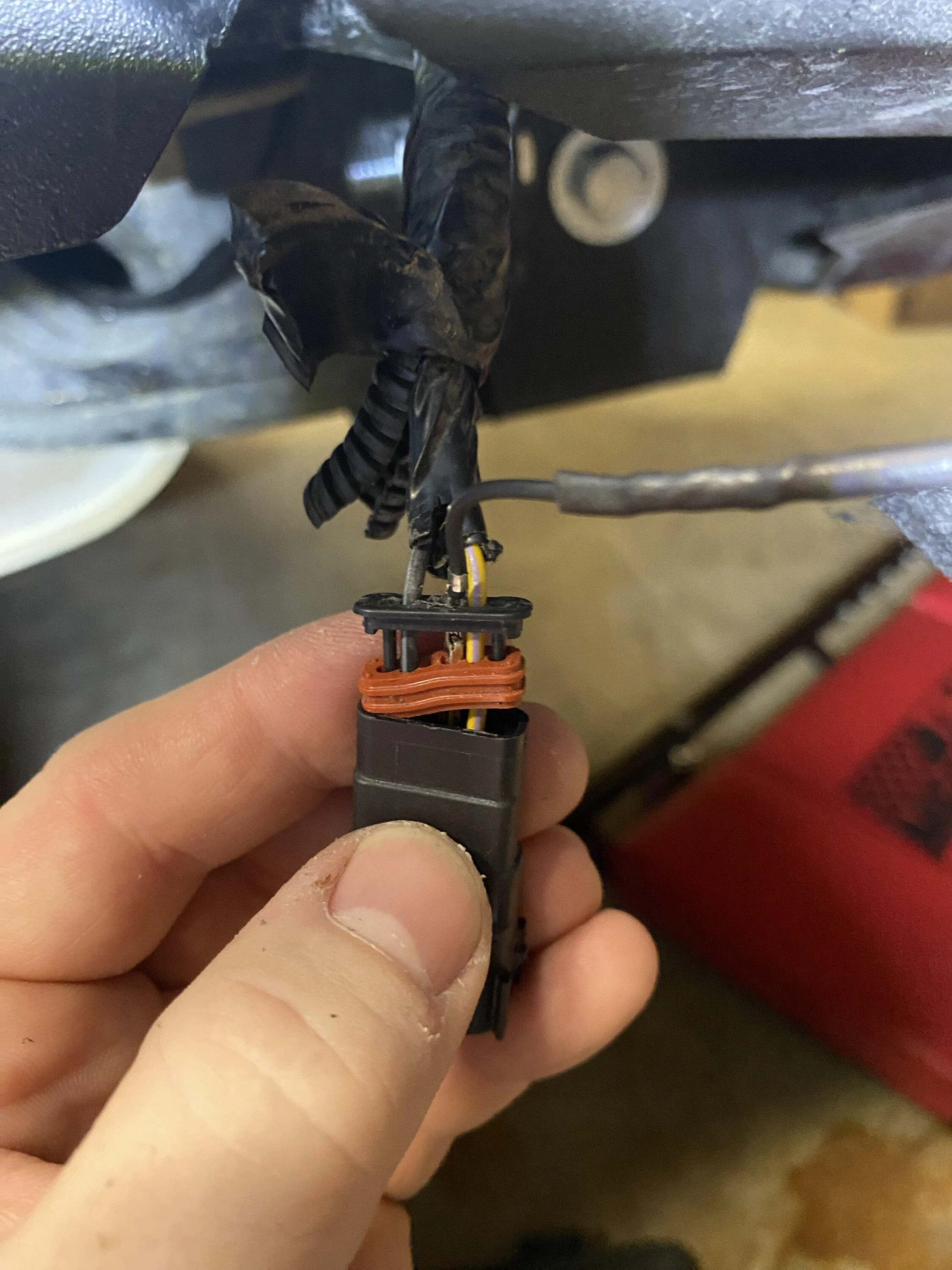

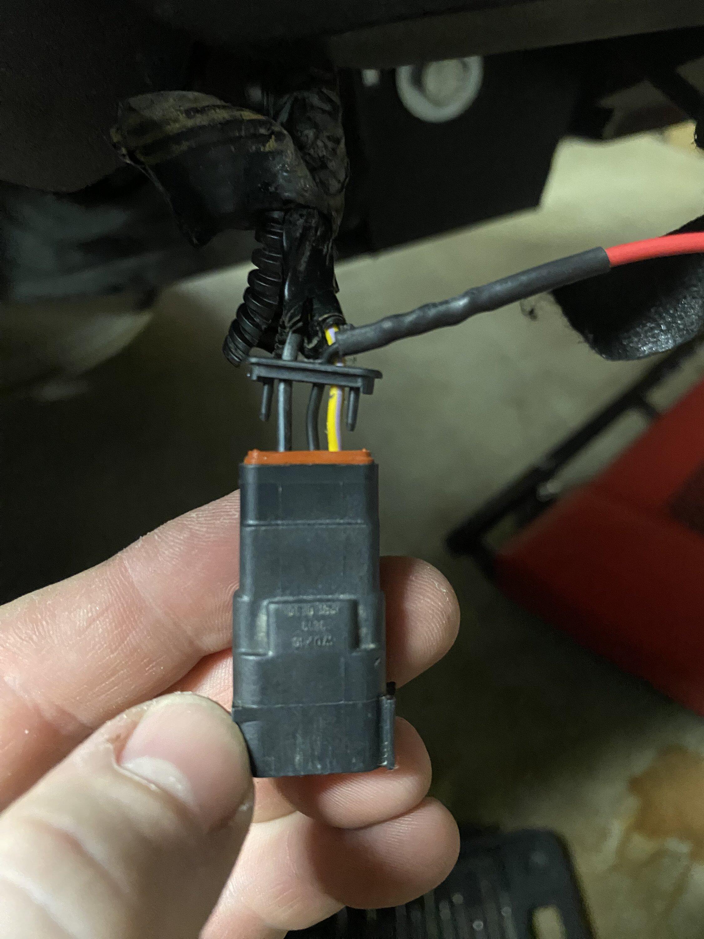

I would recommend cutting the G harness connector off and using some DT connectors and get the crimp tool, not the premade pigtails, we aren’t hobos here, we’re buying euro marker harnesses and rigging up auxiliary lights.
I only needed the power wire, not the ground, to trigger the Diode Dynamics C1R reverse light upfitter switch circuit since it already has a ground on that harness and by my basic engineering circuits knowledge told me “a grounds a ground!”

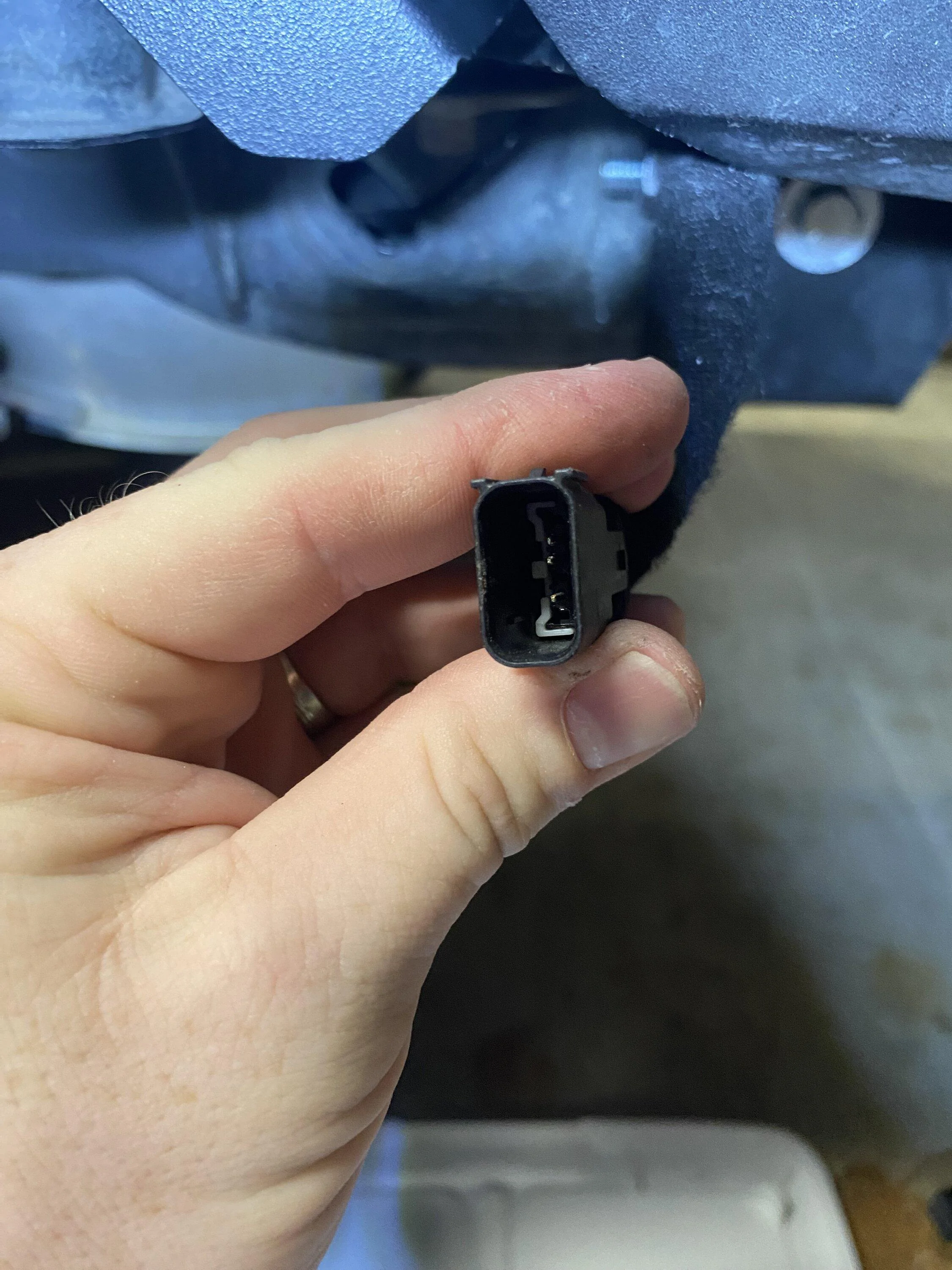

I have a 2024 2Dr manual Badlands with the Mid Package
I couldn’t find any connectors in the modular bumper
I also don’t see any parking sensors although the truck beeps when closing in on something front and rear
This photo is of the male connector from above the front right wheel well
After reading this long thread I believe my options are
1: Add pins to this connector and opening the loom
2: Wire the lights to my auxiliary switches.
My hope is to independently control the 3 lights separately
a fog light, an off road spot light and on road driving light to help spot deer
I would appreciate any guidance and opinions

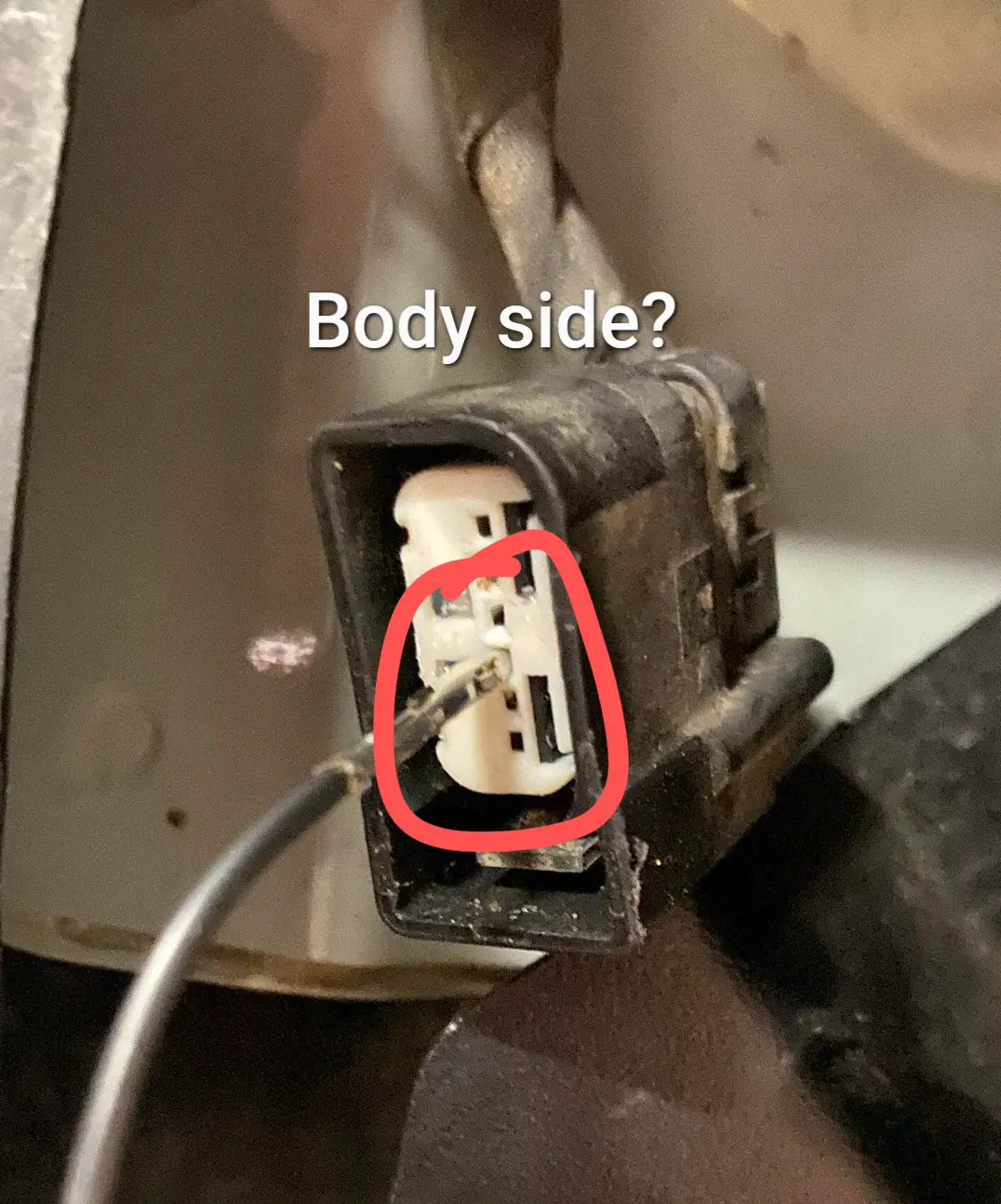

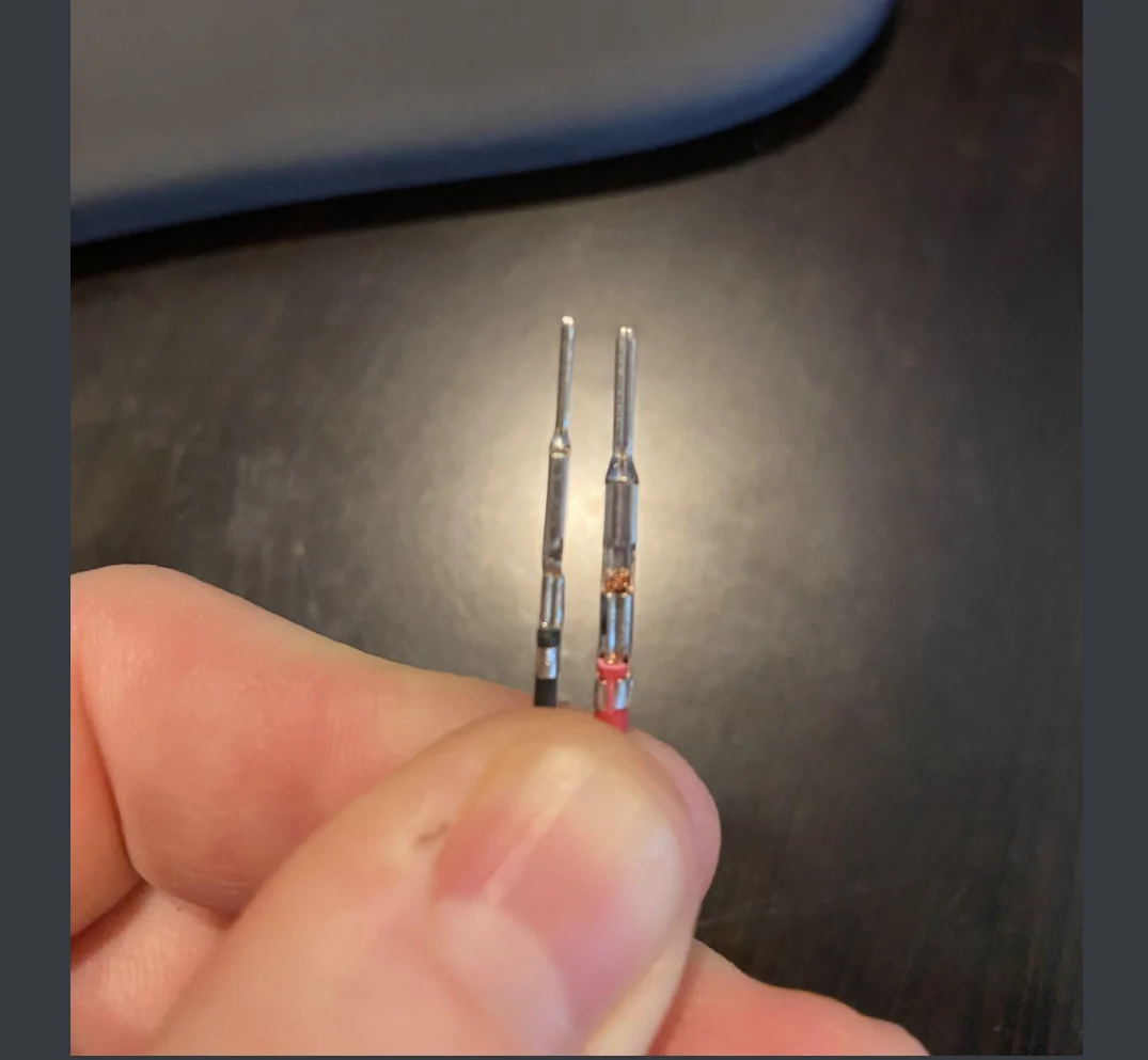

Can you please clarify a few things....? This 'wrong pin' you mention...this is for your custom pigtail? The 5X terminal pack from Ford are the right pins for the body connector?
Ford Bronco Factory Fog Light Switch 2325

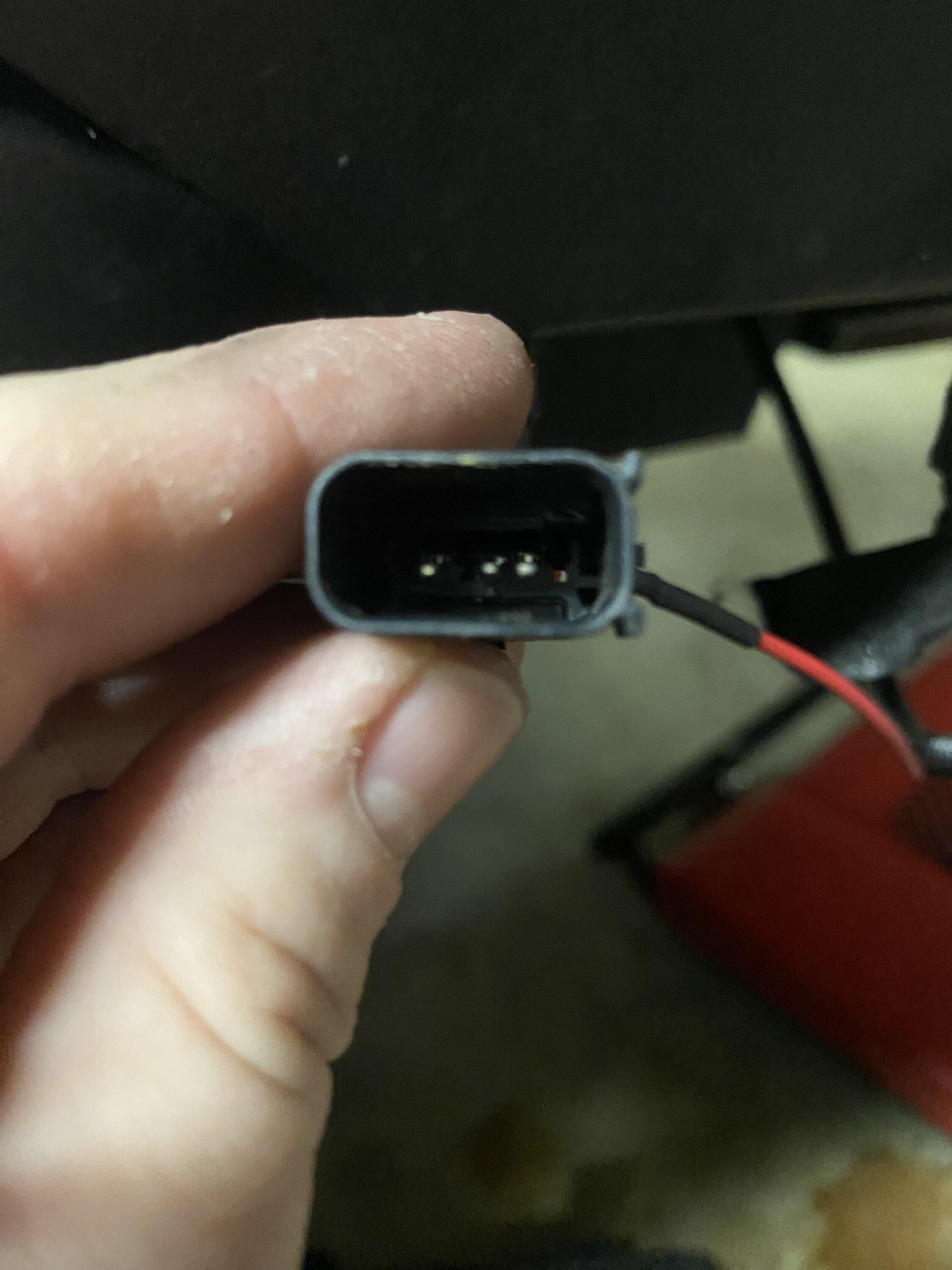

This is the body side of the connector? The 3rd pin hole doesn't exist and needs to be drilled? I assume the copper of the female socket is fully intact behind this, so extra care needs to be taken?
Ford Bronco Factory Fog Light Switch 2324

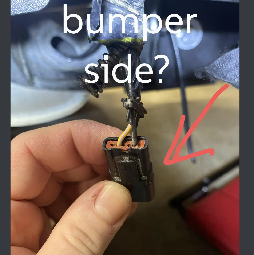

And this is the bumper side of the connector? Basically just insert the new pin pigtail to this and solder it to the rear fog light?
Ford Bronco Factory Fog Light Switch 2323
Thanks for the help!
