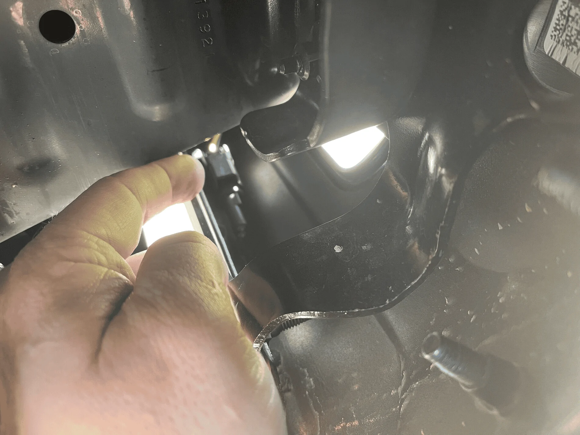

Wait - isn't that harness what's in this picture (at his index finger tip)? With the null male end plugged into it (closer to his thumb knuckle)? Am I mistaken? Wouldn't that mean we need the male end to attach the fog wiring to?

Apologies if what I said may have been confusing. Yes they provide a blind plug (male end) to seal off what would otherwise be the open end to the female side (factory wiring). You can remove those green weather plugs, get the pins and crimp them to new wires and make that blind male end and actual male end harness to be soldered or otherwise attached to your lights.
Hopefully that's clear but very simplified, unplug the blank connector and use it to wire up whatever you're trying to power with the fog light button and then plug it into the factory supplied female end. Then you have a very factory fit and finish solution. You wouldn't need to order a plug as one is already provided and ready to accept two wired pins
