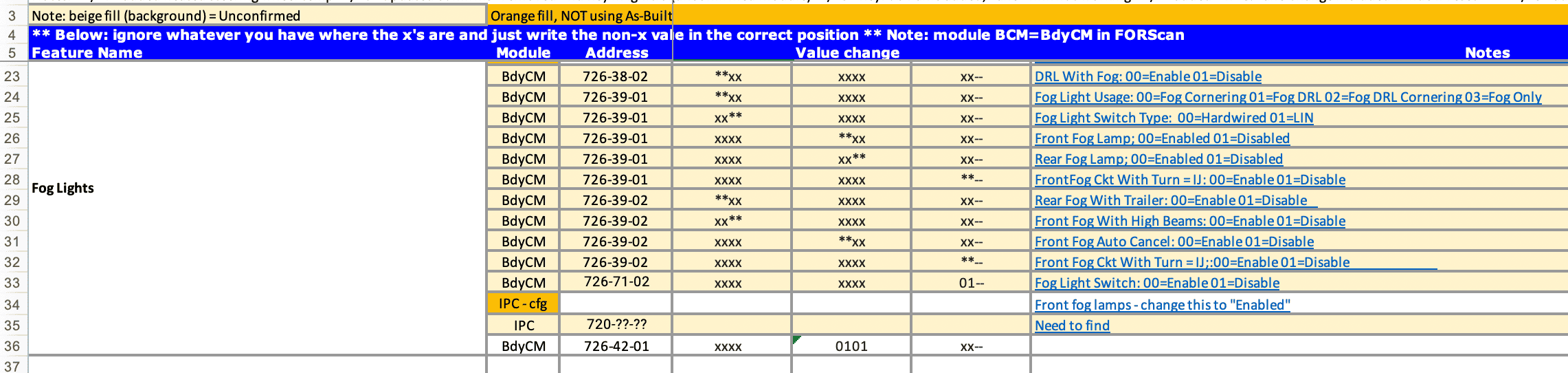

I followed this post and the settings worked beautifully.
https://www.bronco6g.com/connecting-fog-lights-to-factory-wiring-harness-plug/
BdyCM Configuration
  • Front fog lamps - change this to "Enabled".
  • Fog Lamp Switch - change this to "Enabled"
  • Using Front Fog With High Beam - "Allowed"
IPC
BdyCM (As-Built Configuration)
  • 726-42-01-xxxx-xxxx-xxxx - Change the green value to 0101

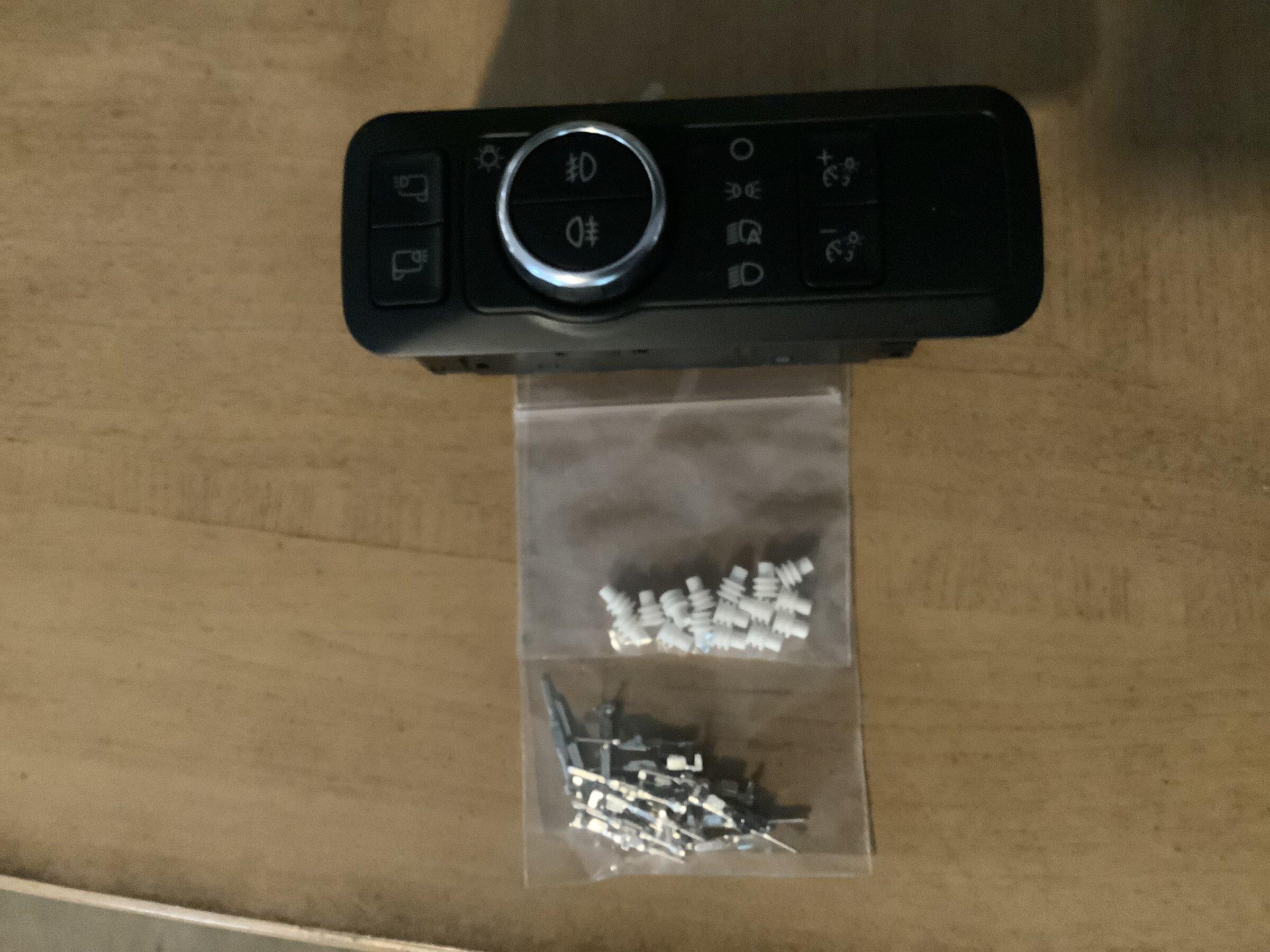

I have the PN somewhere in all my order confirmation emails. I will try to find for you. If you want this switch , IT is yours for 75 dollars plus the actual ride cost. I don't know if it will work for your Bronco. DO YOU HAVE THE FACTORY HARNESS ? That's the big deal. smile
I was finally able to gain access to the necessary fog light wires off of connector C203. If you still have the M2DZ-11654-BA switch and want to sell it I will take it.

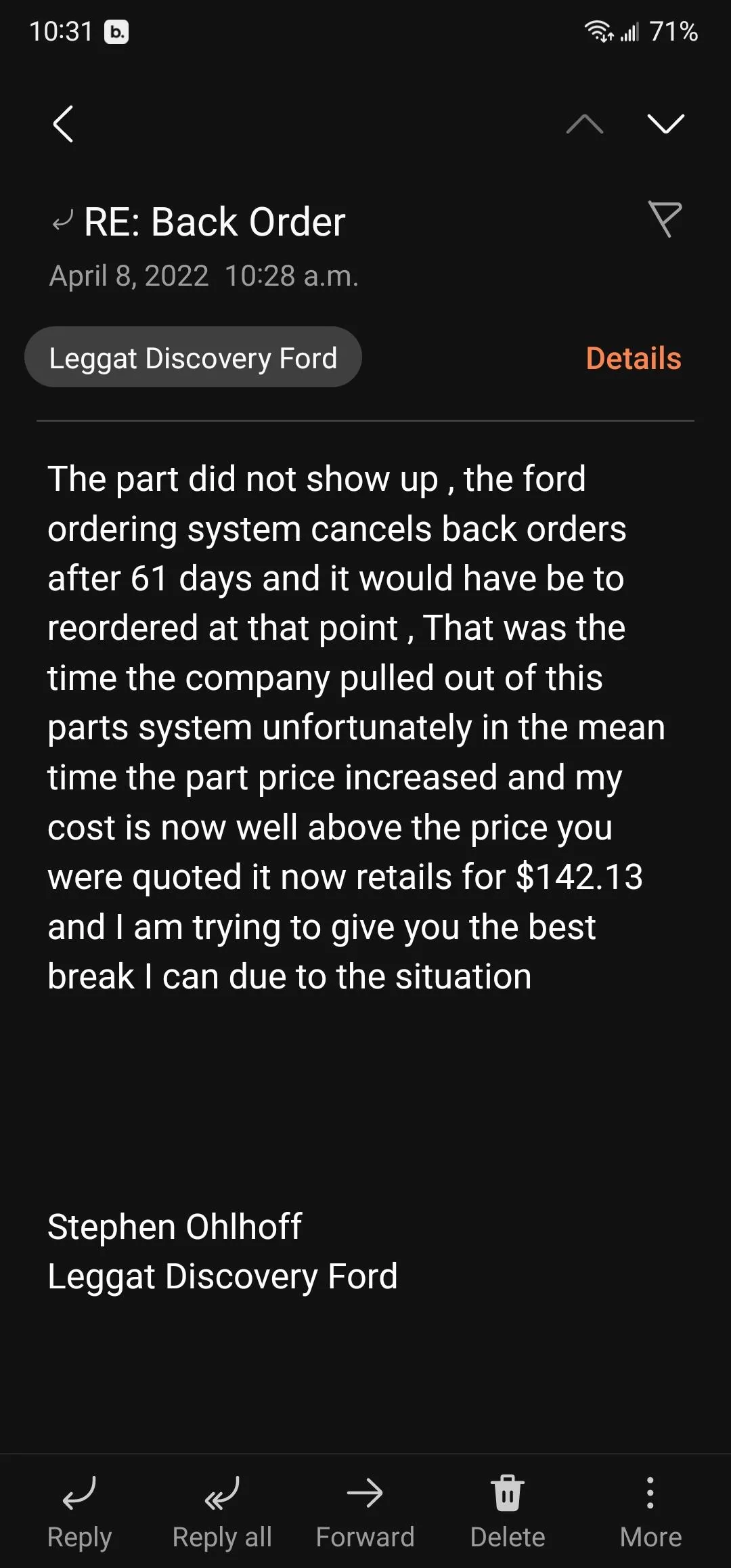

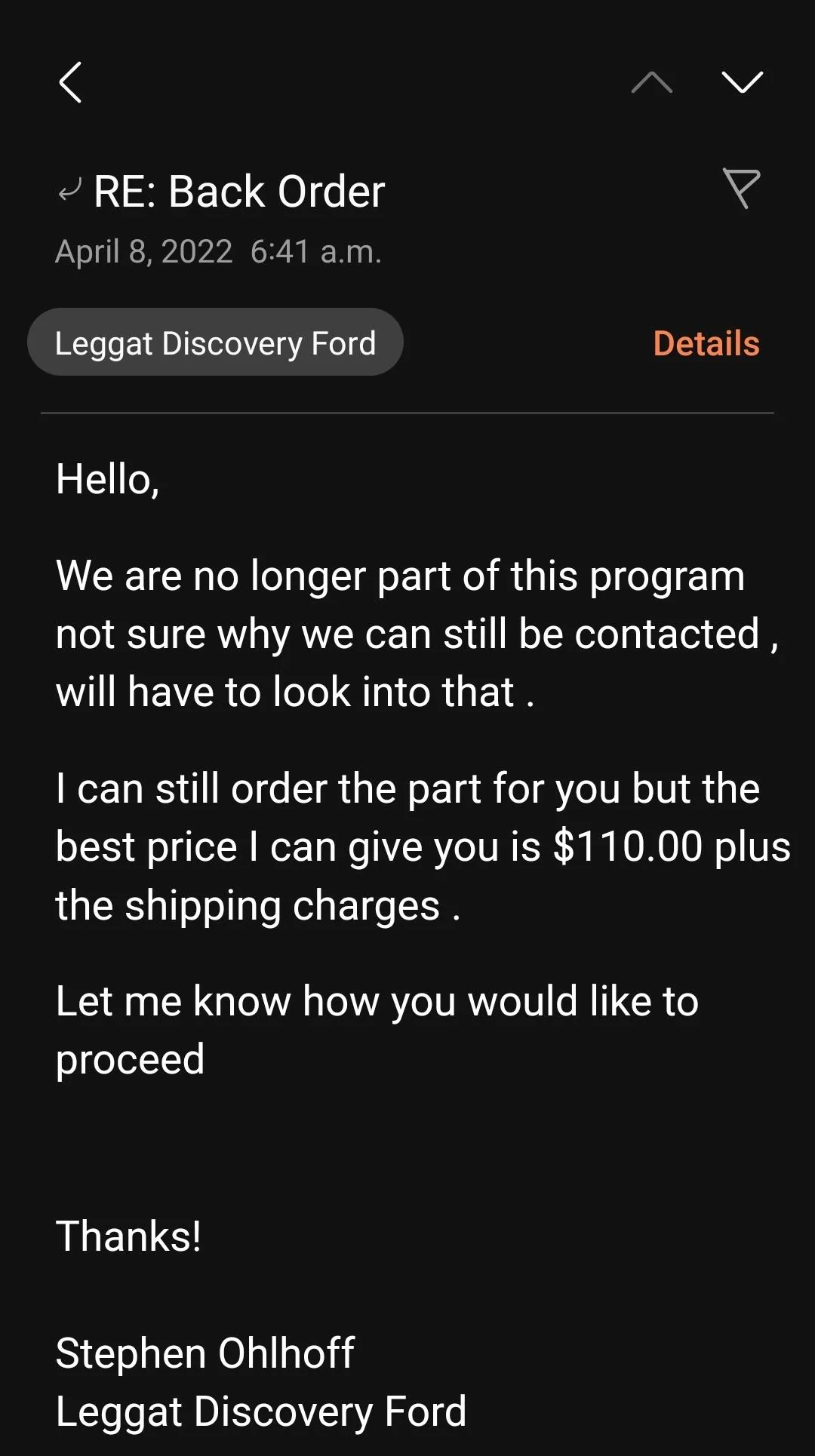

Can't believe this bullshit...
Just emailed these guys to get a status update on my switch. Not only did they tell me it WASN'T even ordered, even though I paid for it in advance, but to Re-order it, they wanna charge me $110 plus $24 for shipping!
WTF
(this order was placed December 9th!)

Just brutal.... Was not made aware of the cancellation of the price increase. The whole time in sitting here waiting for them to get the part and ship it to me. ..
That has to be beyond frustrating. Hopefully you can source it from the supplier used by @Cfield90 or @Kjbeggs or @FairPlayInc since it looks like they received it pretty quickly and that supplier will ship it to CAN.

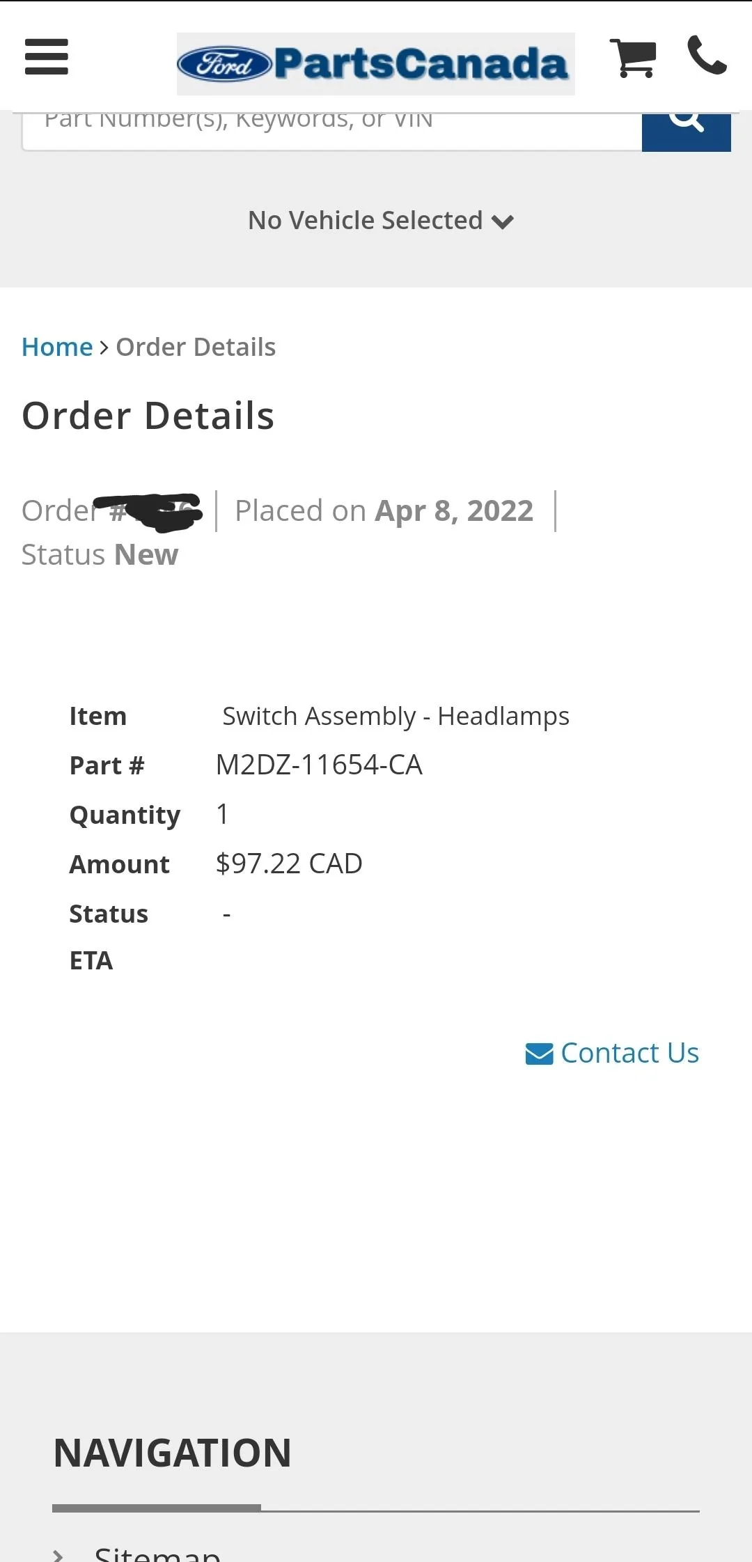

Thanks.... I dropped them guys and went with a different source...
$130 delivered....
Waiting on confirmation and updates
