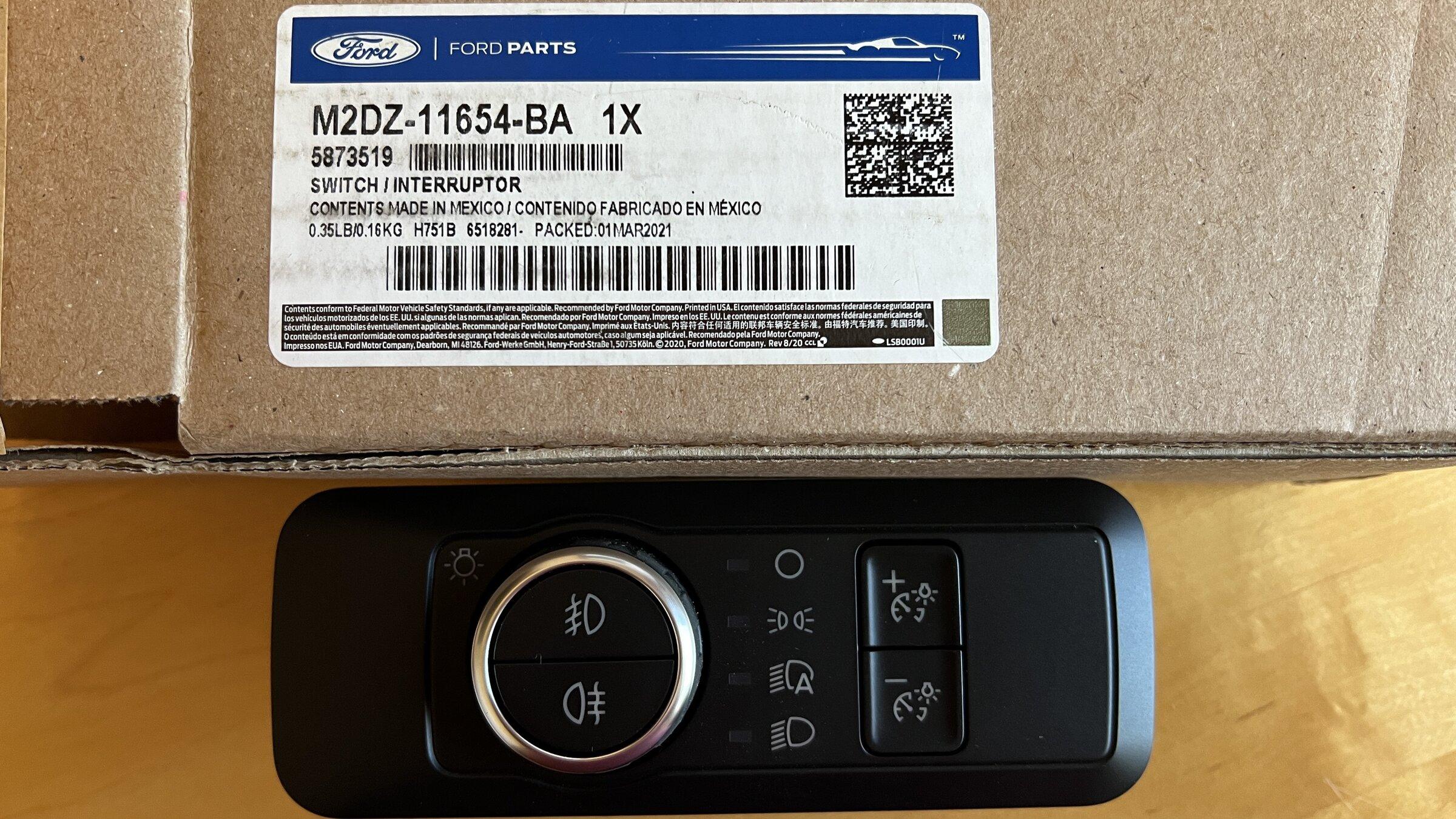

M2DZ-11654-BA. single fog no puddle lamps
So I ordered the part number you specified and received it yesterday. As you can see it is not the single fog no puddle lamps as shown in your picture.
