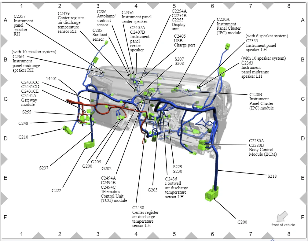

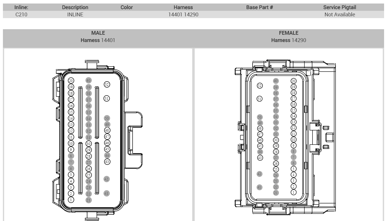

Did i miss it or have people actually found the rear fog light plug for those with the High trims and steel bumpers?
It comes to the uphill side and is located behind left rear tire . You need to tie in there by adding a pin and wire or just purchase the rear harness. If you prefer easy over $. There is a pin out up above in the thread.

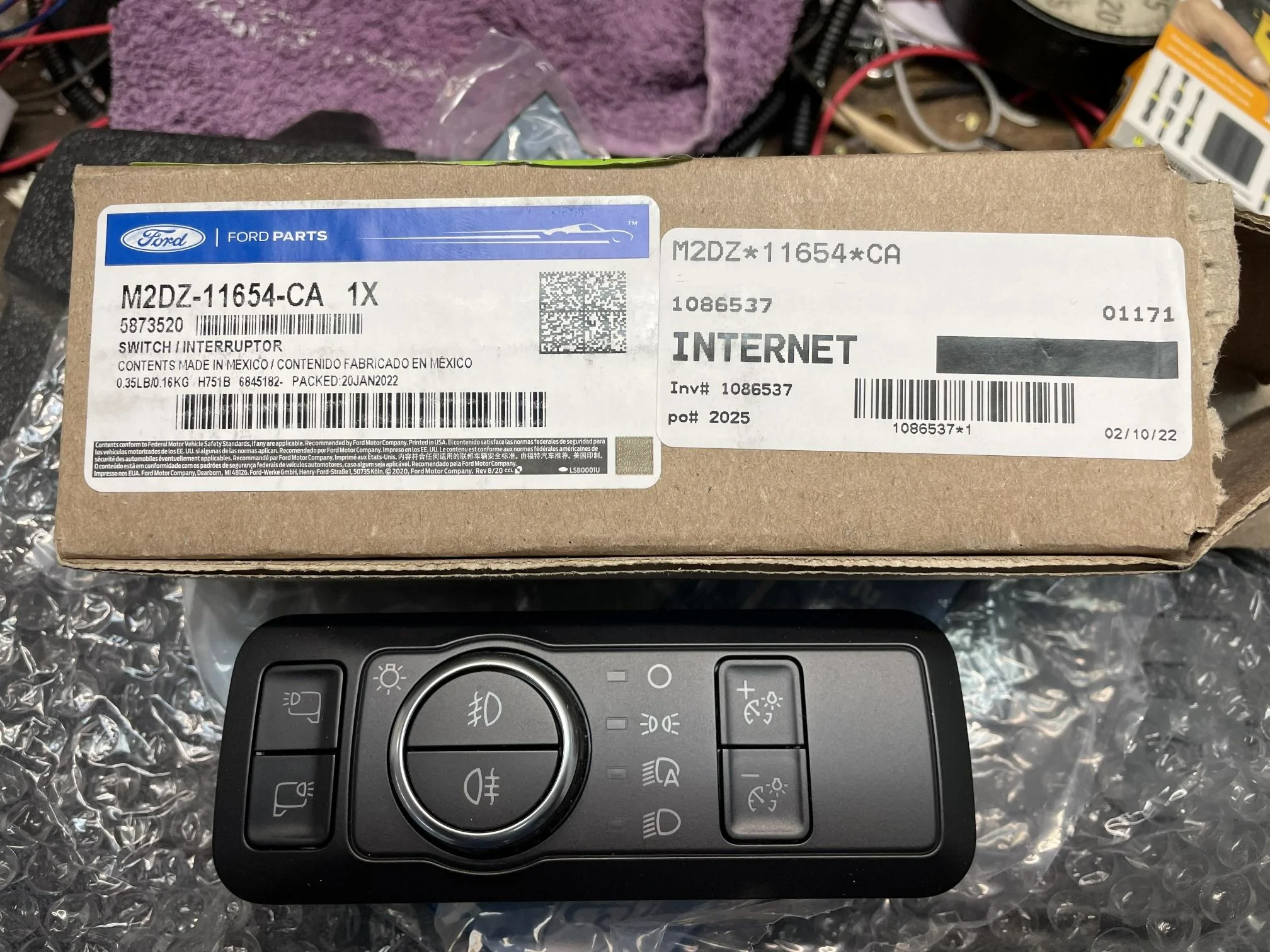

Received switch today, just under 30 days!! Have a stick on rear fog light coming from UK. 30 X 60mm long. Going to stick it on the rear bumper just under the spare tire.
Ford Bronco Factory Fog Light Switch Switch

Damn! Been 2 months since I ordered mine (identical)
Did you order it from the UK as well?

I use a Ford Parts Distributor in Franklin, WI. Price good as anyone on line and the best freight charges .https://www.fordpartsdistributor.com/

There wasn't s'pose to be any US national inventory of these... Back ordered and waiting for re-stock.
Congrats dude!
