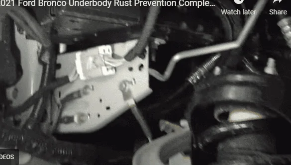

I believe I found the location of the connector C192. I was watching the video on the rust proofing, and they had removed the wheel well linings.

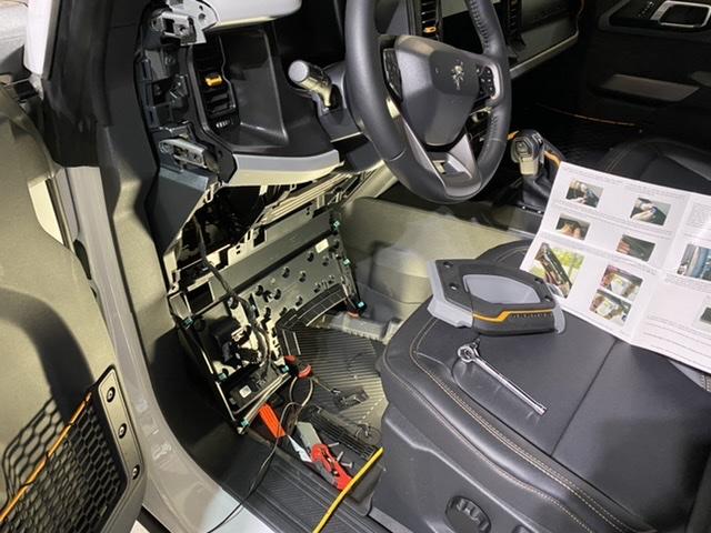

What is the best way/procedure to get out the existing headlight switch module in order to replace it with a new one having the fog button?
P.S. This a great thread; so much information but long. Thank you to all who contributed and shared.
Panel opens via about a half dozen clips (green in pic) then you can easily remove/swap the switch

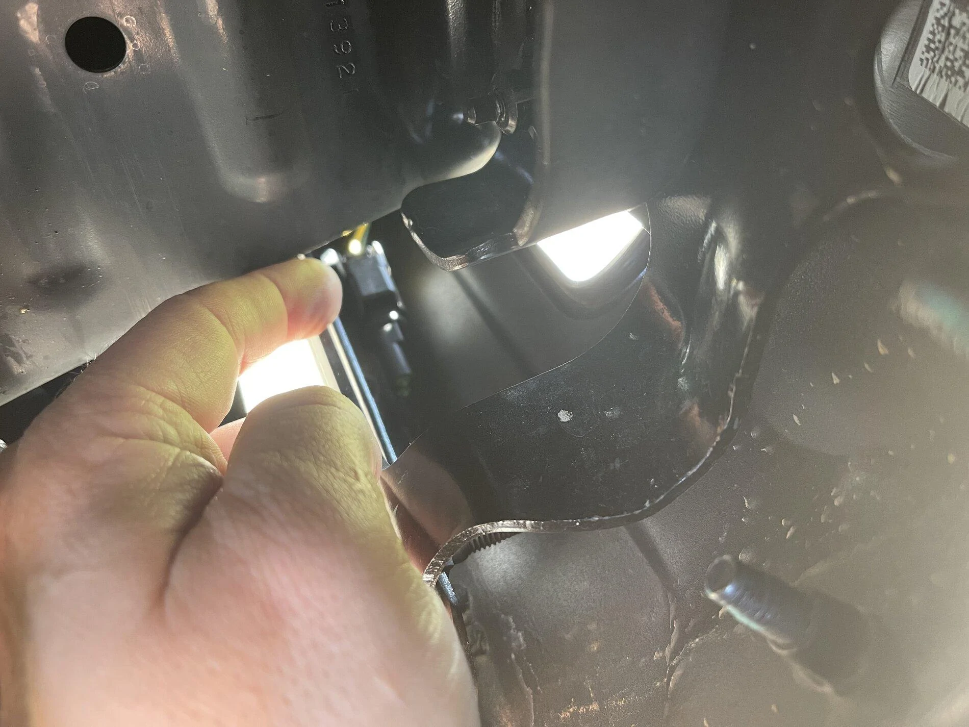

Anyone have a good picture showing where the front fog light factory wire plug (unused) is located? I know it's near the shackle connection point but did readily see it under there and didn't want to go pulling on things yet.
It’s tucked right underneath the shackle, if you have one. Sorry, no pic from me, but I’ve seen them.
Ford Bronco Factory Fog Light Switch CCD994EB-99A0-4BBF-83AA-34A50CFCEB52
It’s NOT there if you have modular bumper without sensors. Take off the cap in front of the tow hooks and it makes it easier to access.
