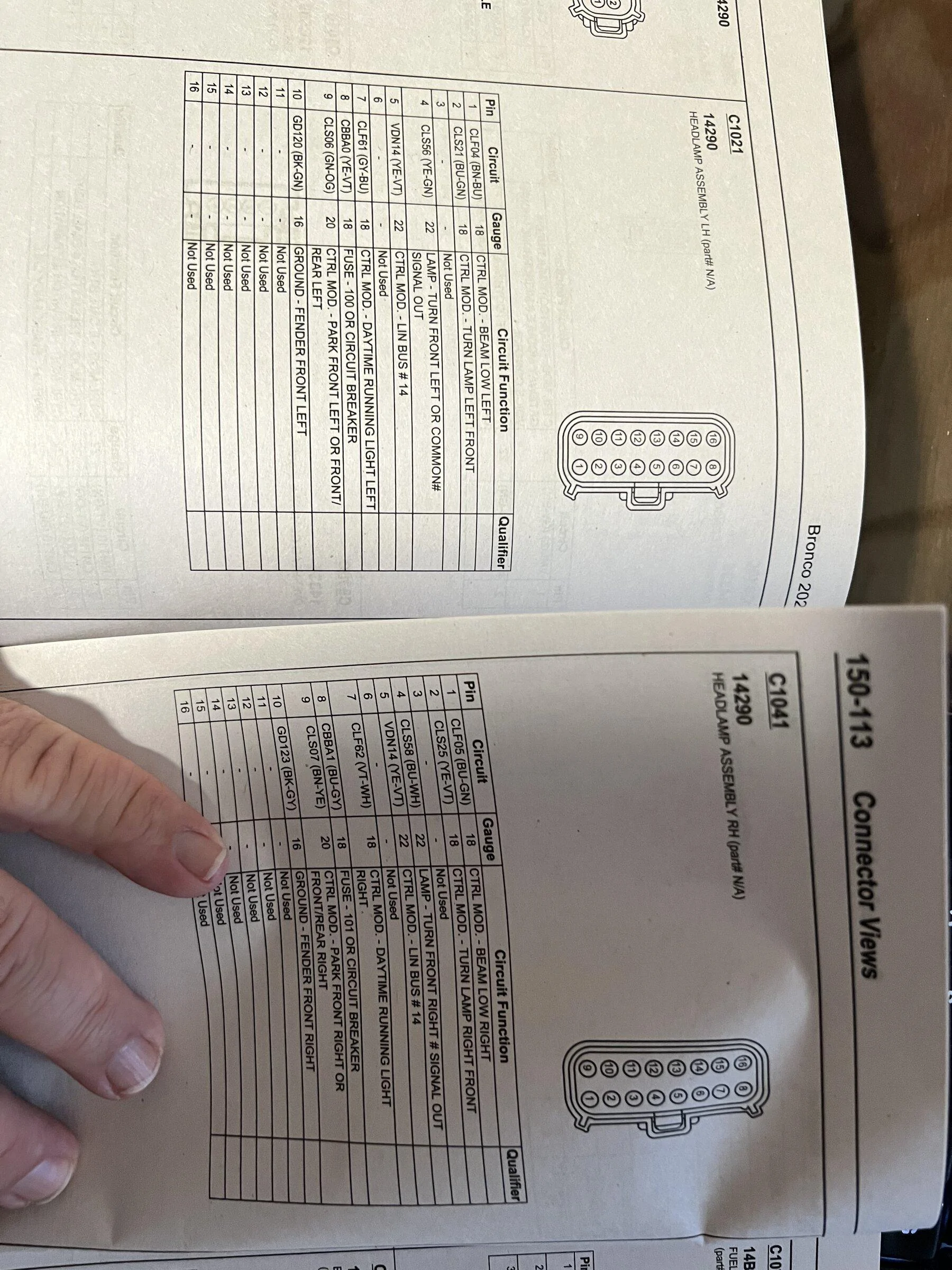

Just an update from a Black Diamond - that wire/harness is NOT in the front bumper. So, likely everyone with a 2022 will be better off…as of now it looks like the wiring is at the switch and potentially goes to C203. From there - we’ll have to see. Thanks to @flip for helping me sort this out. Bummed it’s not going to be as easy as I hoped to upgrade the headlight switch and save an AUX.
Dk you know which wire from the headlight the DRLs use?

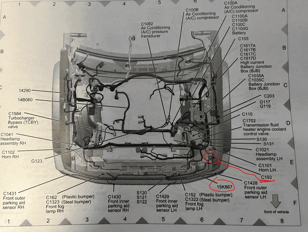

@redone17 Loo and see if you have the connector I circled in red. It should be located in the drivers fender below the headlight. If you have that the all you need is one of the variants of harness 15K867.

Unfortunately, that’s not there. It would be visible from under - just behind where the fog lights sit. Unless it’s tucked back because it’s not in use - it’s not there.
I’m planning on taking the wheel and shield off in the next week or so to install catch can and block heater. I’ll have a better view then.

Looks like that connector only exists on the 2.7L Harnesses. You would more than likely have to purchase the entire front harness that runs from the BJB and rewire the front of your Bronco, if it is a 2.3L. I had to do that when I added Factory foglights to a 2006 Mustang V6 I owned.

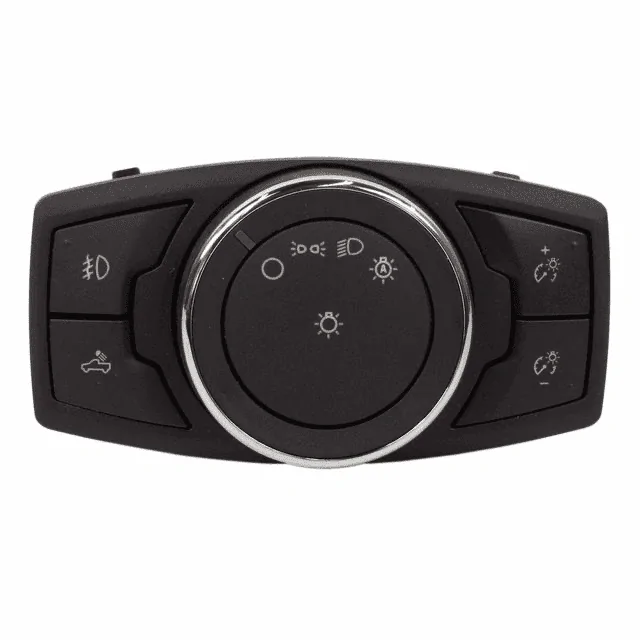

Has anyone purchased a ML3Z -11654-BA and can verify it has the two switches we can swap for our puddle lamps? thank you , George
EDIT 1: corrected part. number
EDIT 2 : I just looked up ML3Z-11654-BA and shows for a 2021 F150 and it''s a no go!
Ford Bronco Factory Fog Light Switch 1641264166227
EDIT #3: the "AA" does not work either

I have only been able to find the single front fog that enables the swap as originally posted by bee bop. That part number is ML3Z-11654-DA .
I ordered it and received and it works awesome for front fogs ONLY.
So….thinking I was smart, I also ordered
ML3Z-11654-CA . Crash and burn 🔥.
Not even close.
The first 4 alpha numerical set is the vehicle - 11654 is head light switch / interrupter and the -XX is the configuration. I have not found any ML3Z -11654-?? To allow us too go to a dual fog. . If you go to Tasca auto parts on line and searchM2DZ -11654-CAyou will find the only pictorial ( that I have found) of what you and 14 others are trying to purchase. 2 each of the January Backlog orders I know are mine. The Ford inventory system has put the demand in place for these. I recommend you ask @Phil to place one on order and just be patient for the supply chain to catch up. When it does, we can all customize with our personal preferences for updates to rear lighting.

Here's my source ...a copy from my invoice : smile. -DA single fog works
-CA does not have the gas and bed lamp switch to pull for puddle lamp switch swap
