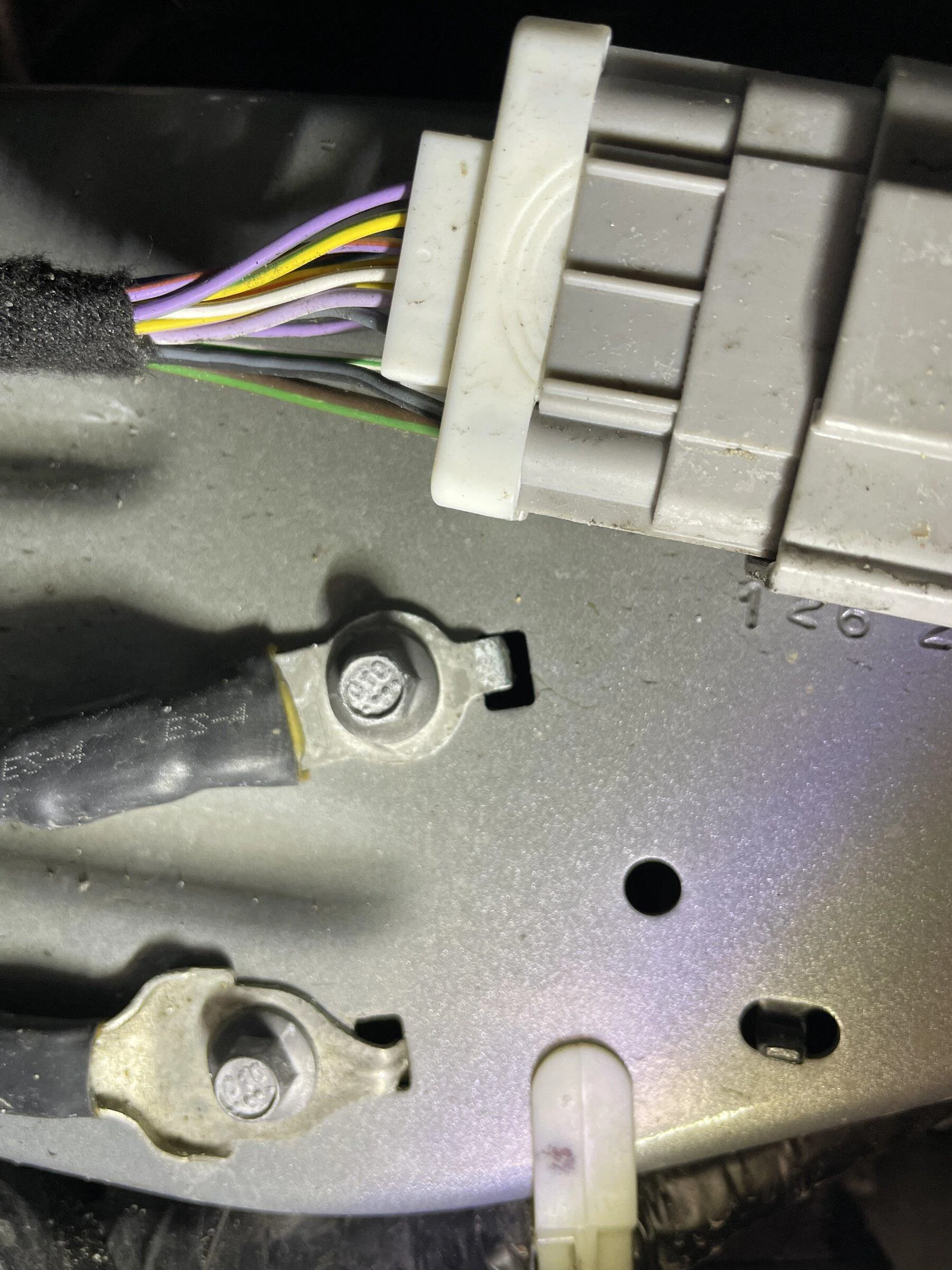

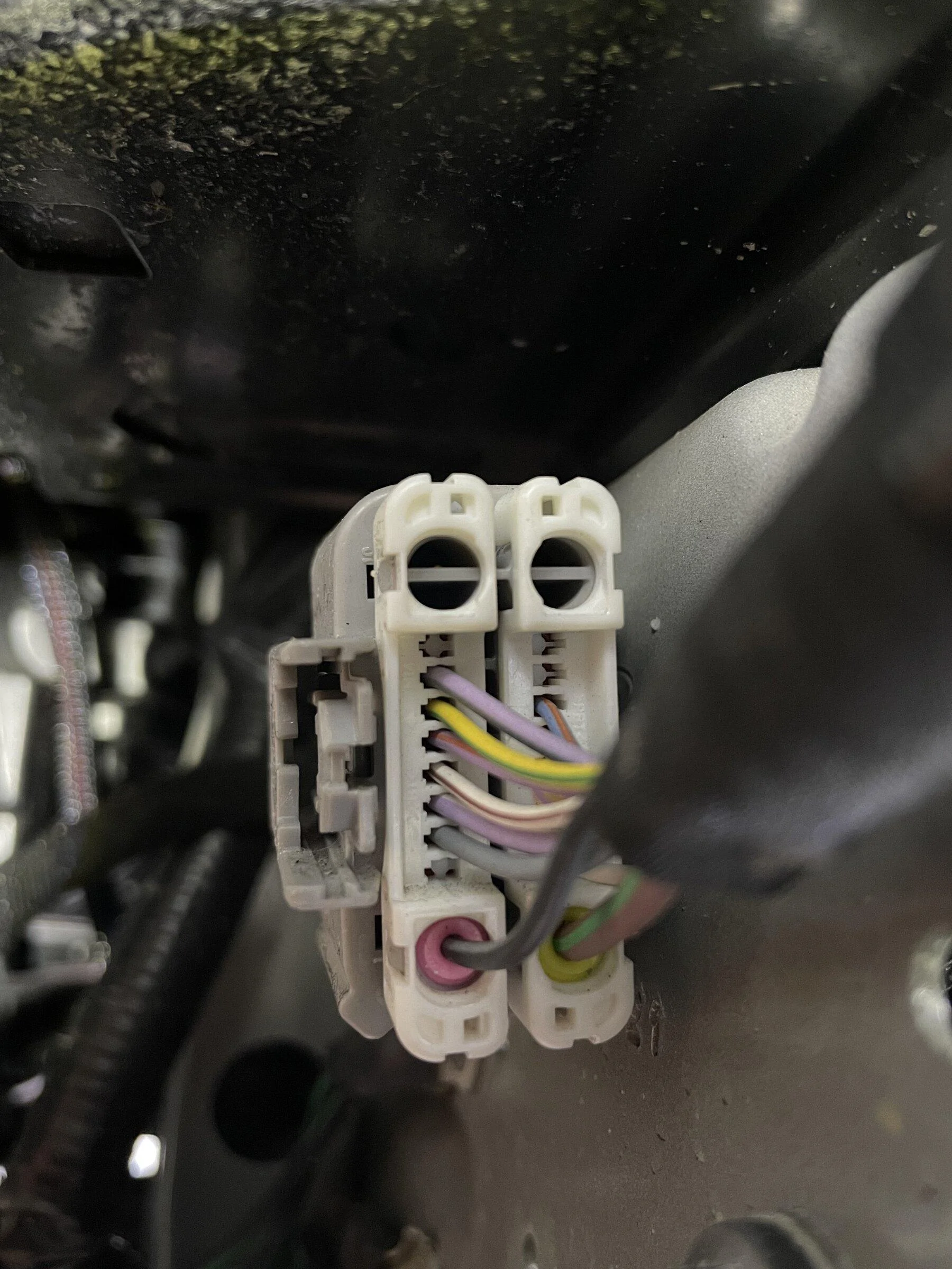

That connector was in the wheel well under the battery. This is the out:
Ford Bronco Factory Fog Light Switch F848C8B6-4E31-4CA8-88ED-8F39F30D4B85
I thought I took more (better) pics…

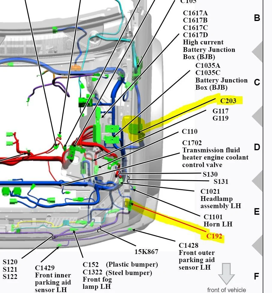

Yes the connector you're showing me is C110, the big brown with green stripe wire is for the starter relay.
C203 has 52 pinouts and I am guessing would be connected to the battery junction box (fuse box) or it's a junctional harness and meets at that point and then feeds outward.
Unfortunately the diagrams are very overpopulated.

Ah yes. Now that I have revisited that diagram - that makes sense.
Just as over populated as the damn engine bay. I wish there was a diagram from the side to show what vertical plane these things are on.
Now that I have a visual where C110 is in conjunction to that diagram - C203 must be inside the fender well perhaps mounted to the side of fuse box as you mentioned.

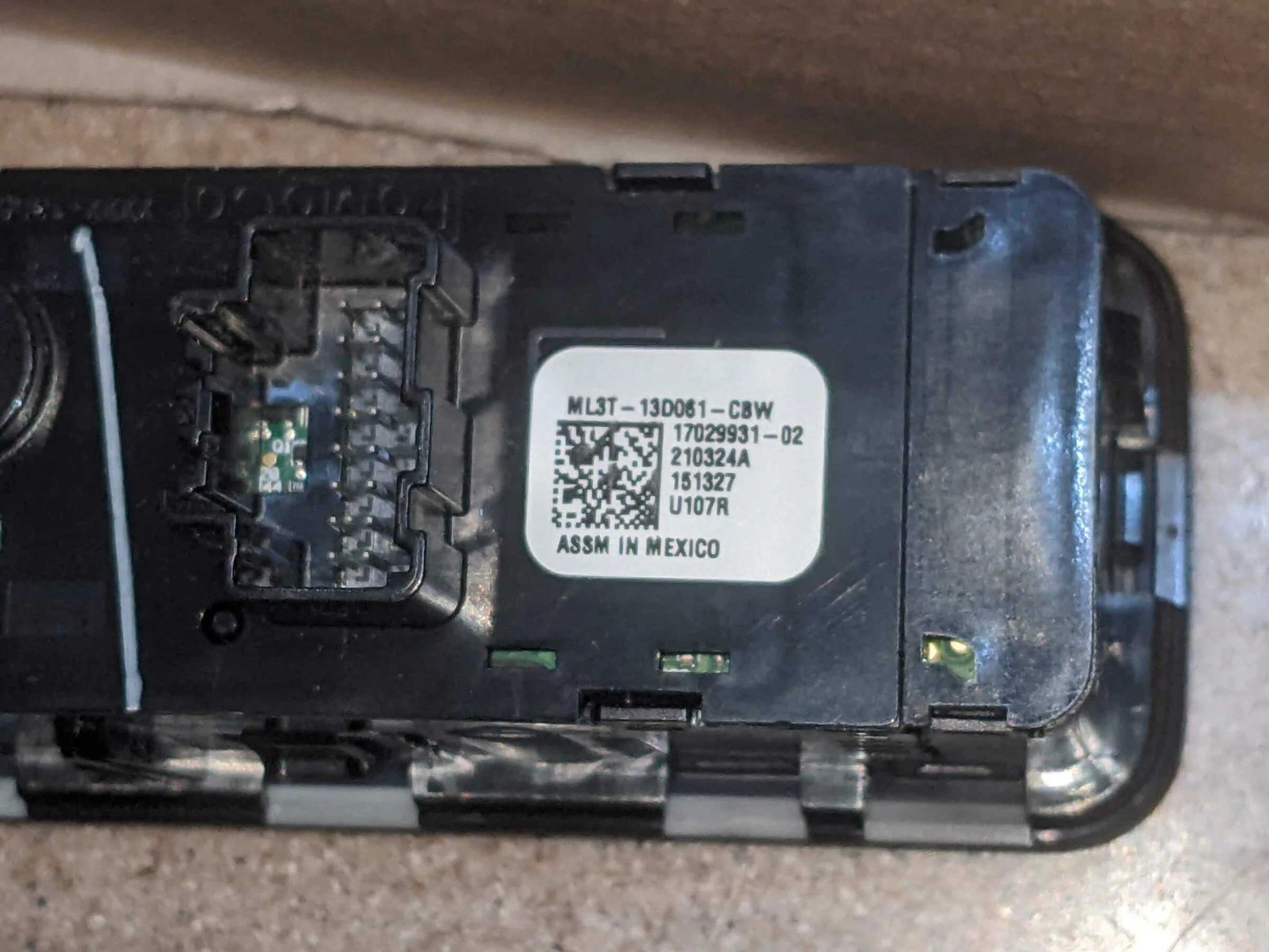

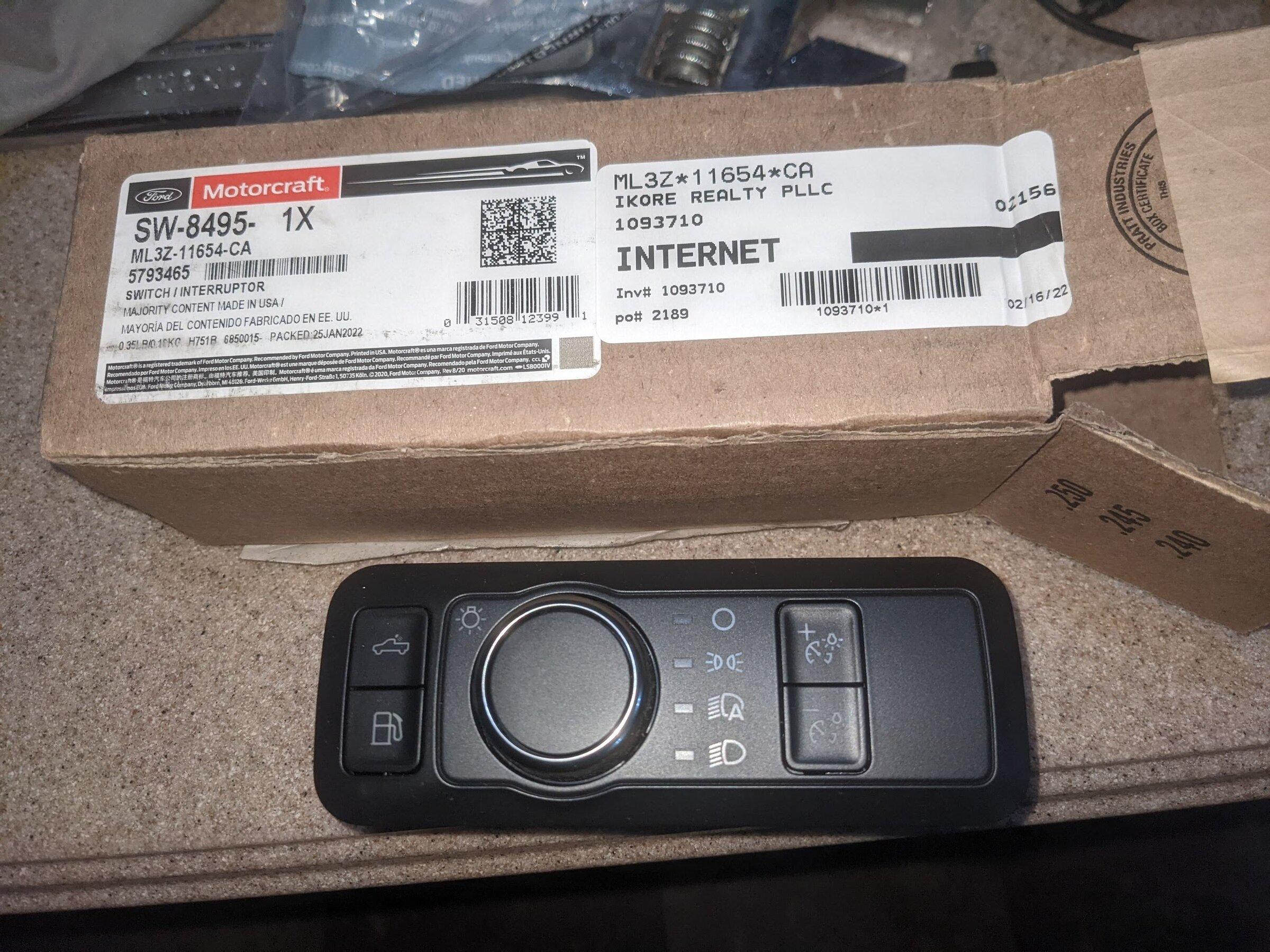

Wrong part in the box? I think was sent the wrong one. :poop:😭
This is suppose to be the truck version with front and rear fog. ML3Z-11654-CA but the back says ML3T-13D061-CBW
