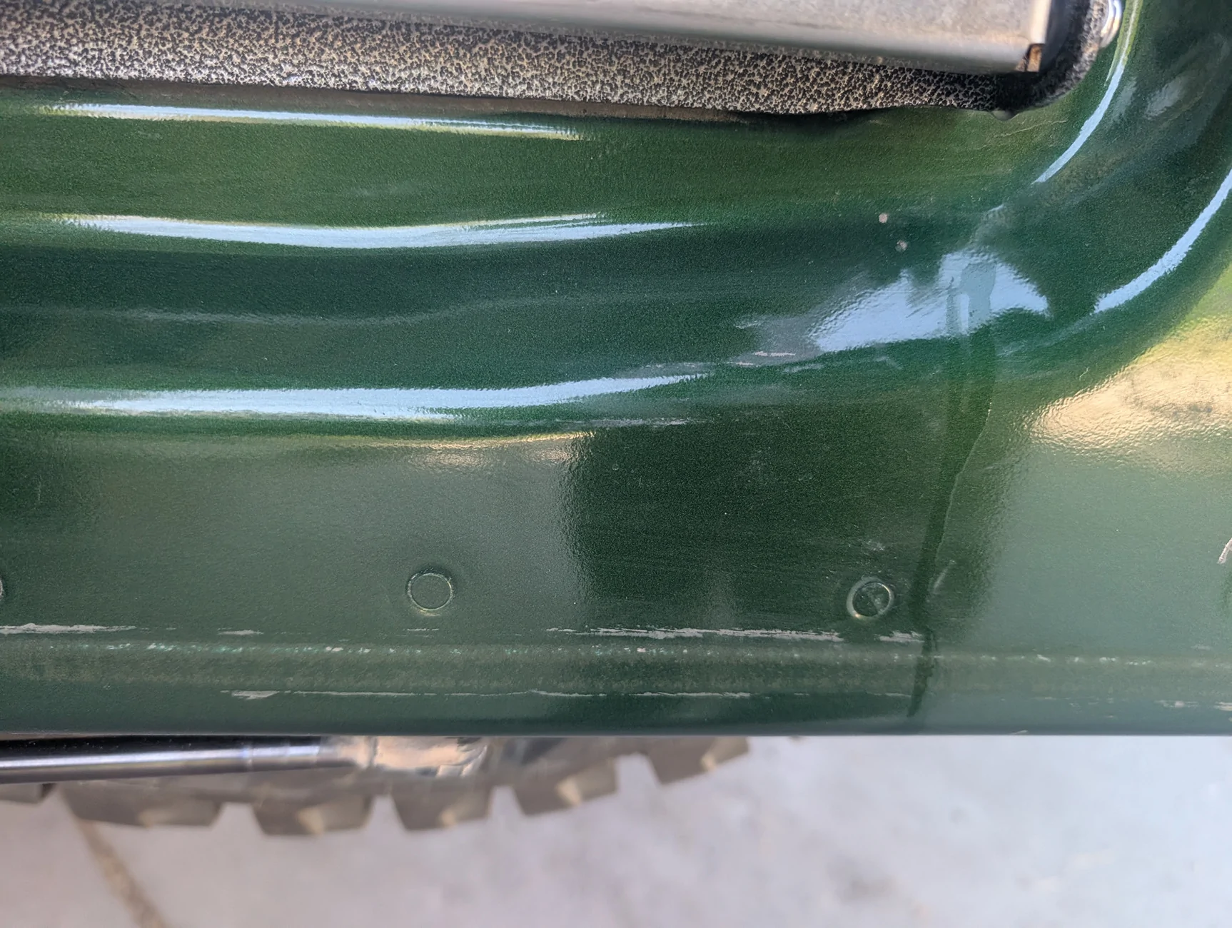

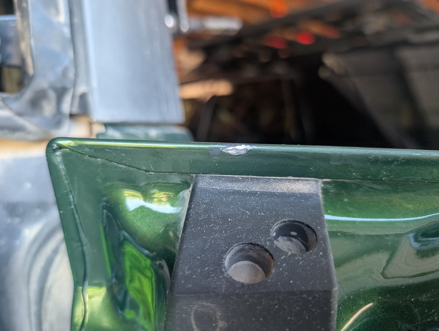

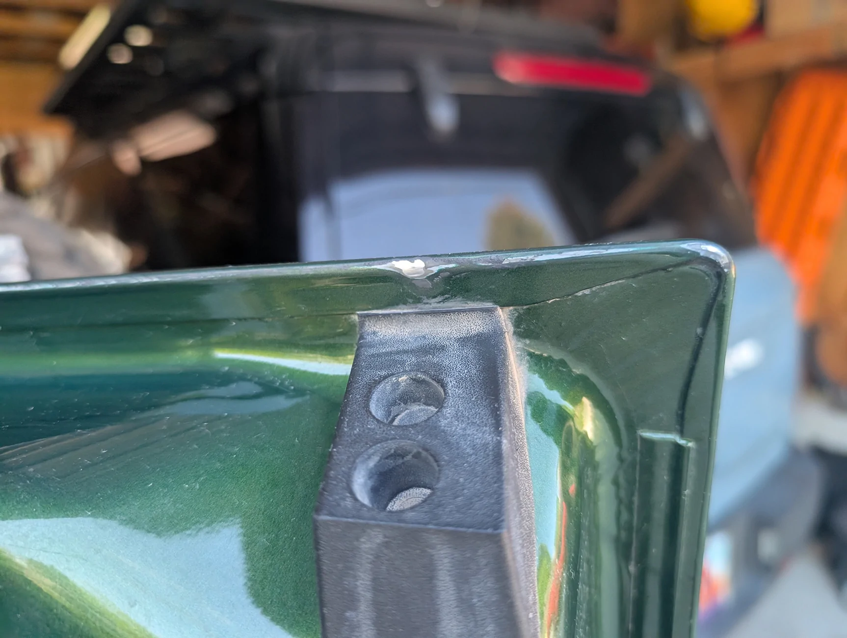

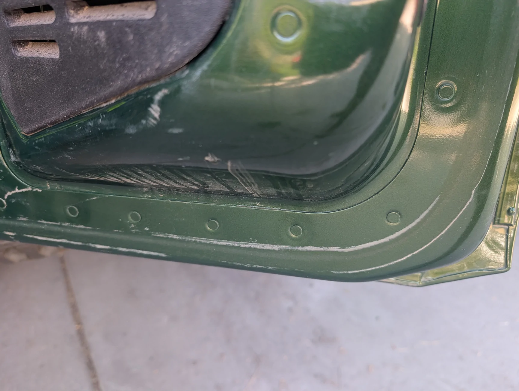

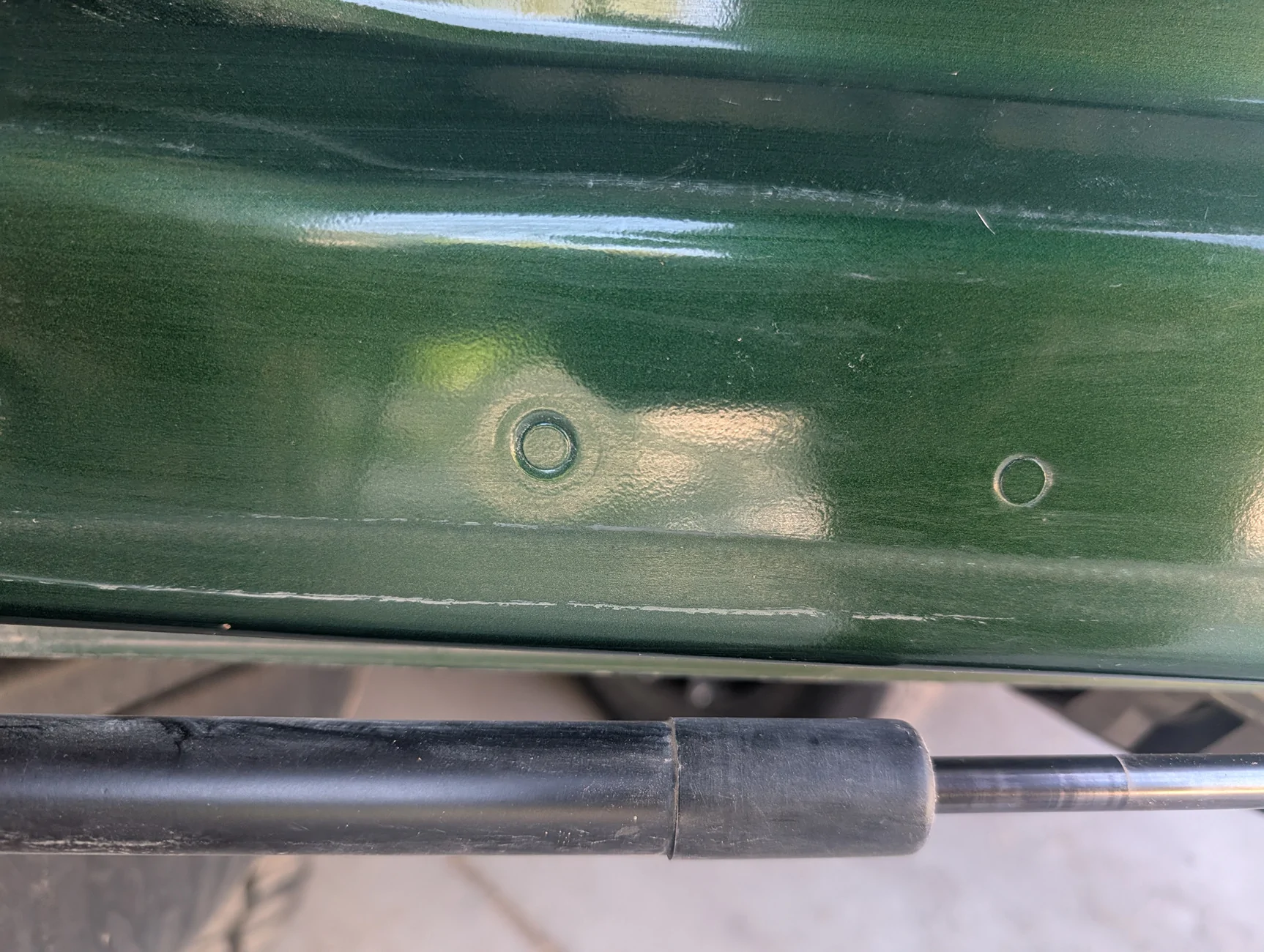

Has anyone else had issues with significant paint wear on the tailgate where the seals contact? I haven't heard that many squeaks and rattles, but I'm noticing paint rubbed completely off in a lot of places (photos in a sec). I'm running stock size tires, albeit heavier than the OEM Goodyears. There's nothing else on the tailgate other than a table (which is pretty light).
Some of the scratches are on me (cargo/etc). But the rub patterns that exactly match where the seals contact seem suspicious....
I'm still under 30k (barely) and have an extended warranty regardless. Is this worth asking about?

There’s a TSB for the paint wear on the top edge. It’s due to an accumulation of dirt between the rear window seal and tailgate.

Ah, thanks! That's super helpful to know!

I had this happen on my badlands. I just touched up the paint then added a clear xpel strip over the top lip of the tailgate to take the wear off the paint.

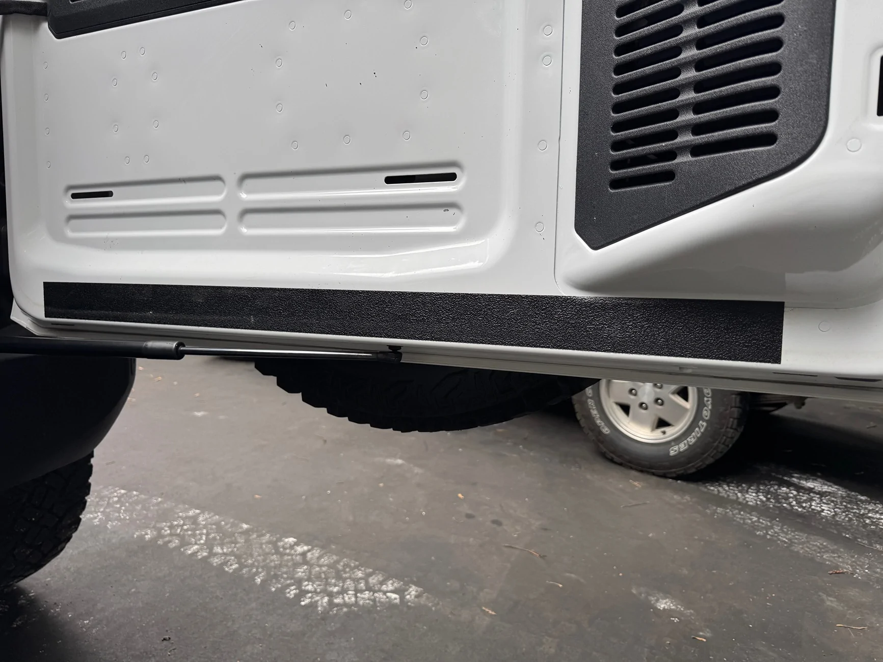

I touched it up with paint and got some adhesive rubber door edge molding and problem solved.

had the same issue because of the rubber matt. Tuffskinz on Etsy made a custom protector for our Bronco, it’s nice has been holding up really well. If you contact them they will make it how you want. I didn’t like the Xpel, too thin and they only have it in clear.

Basically just a strip of clear mylar tape on the top edge of the tailgate
I was going to suggest stickers, but this looks better. Mine has been scrapped up from cargo, but not enough to bother me to start a sticker collection yet 🤠
