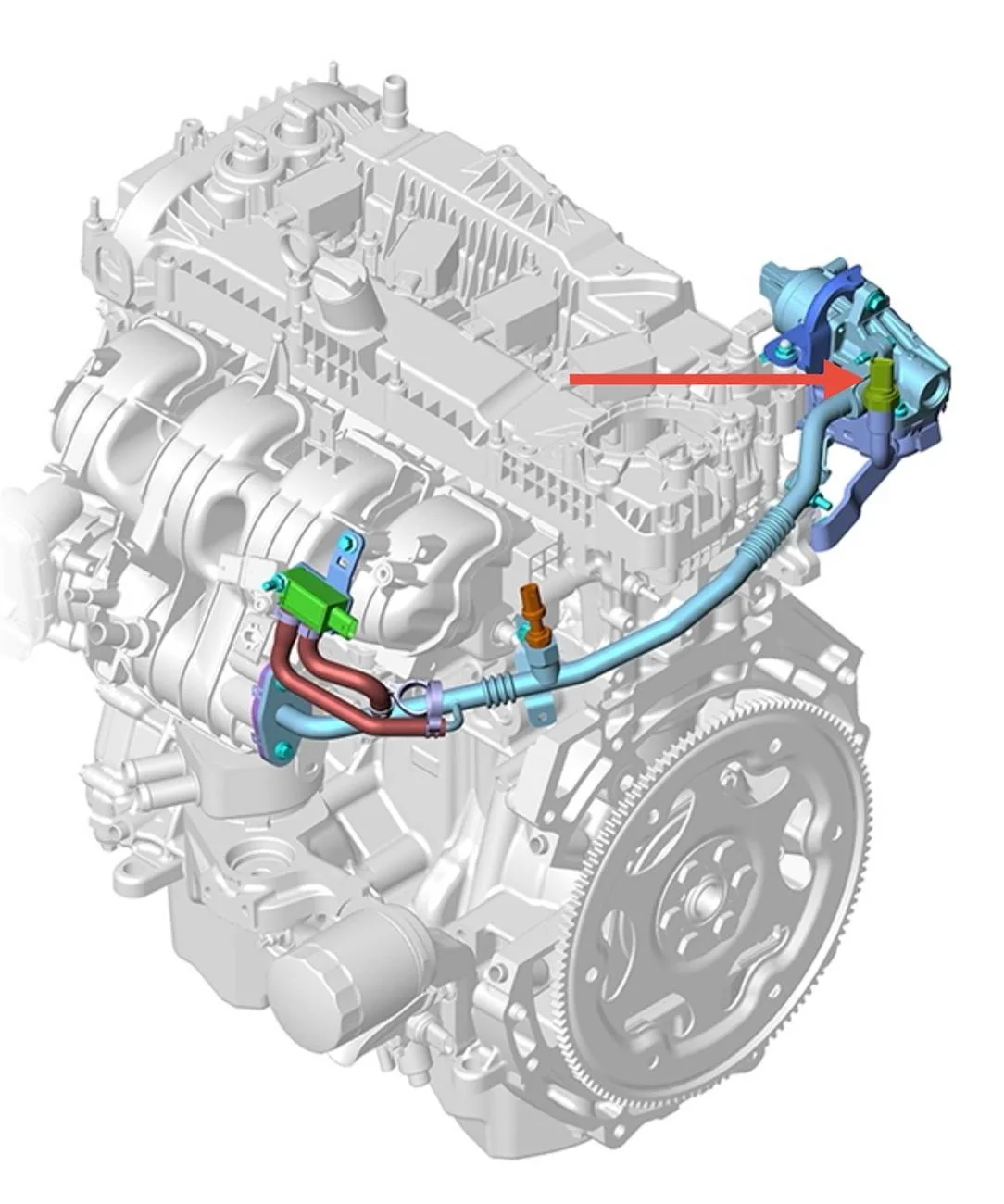

Yeah it is.
So probably either going to the sensor itself, or some type of wiring issue to the sensor.

Thank you very much for that diagram! As far as I can tell, the wires are ok. Only a couple inches from the sensor to a larger bundle... I reset the code and plan to have her drive it for her trip later today. If it's back when she returns, I'll probably try replacing the sensor (cheap enough) and see what happens. More on that later...
