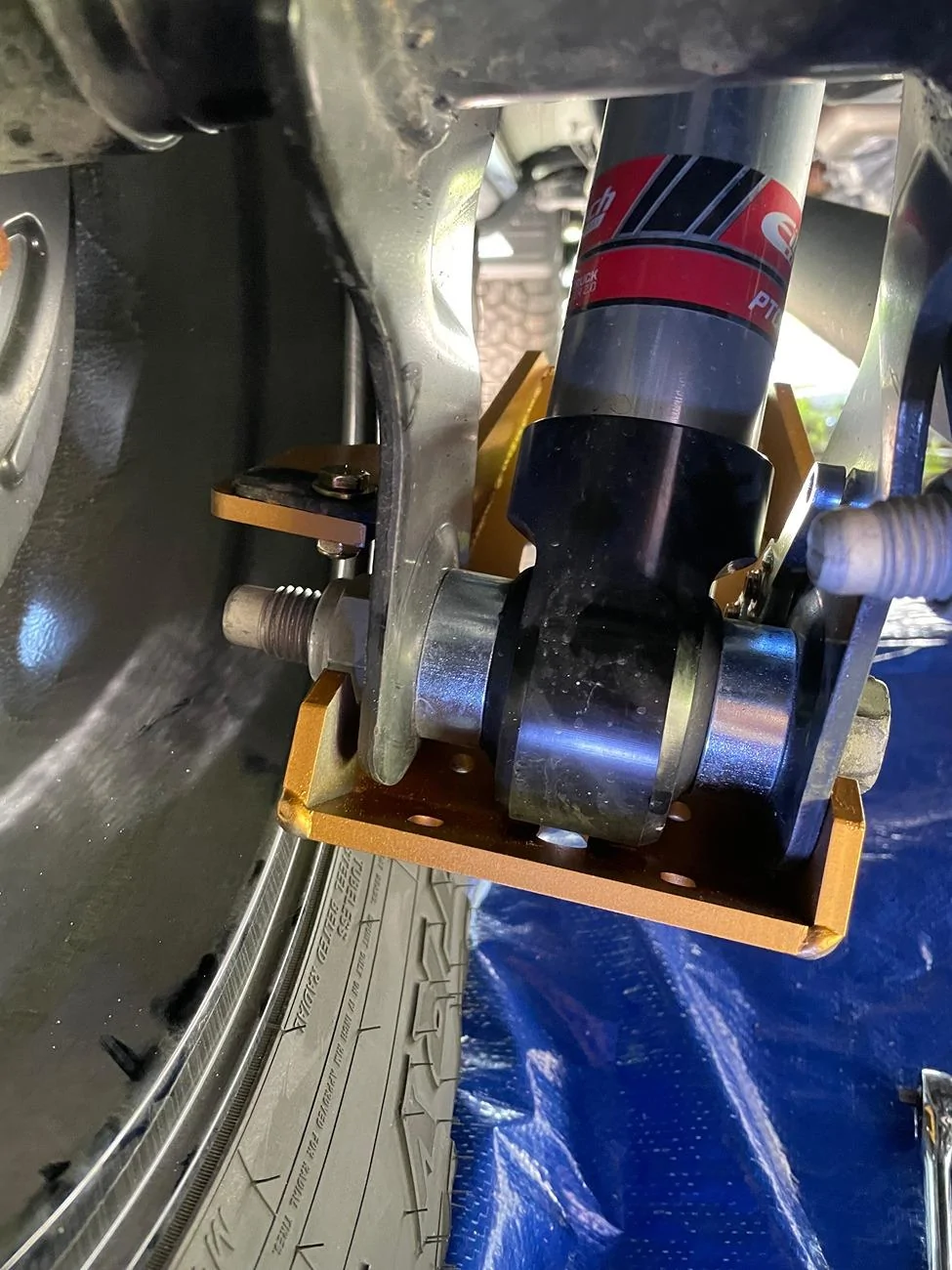

Picture of Next Venture skids and Eibach shocks...

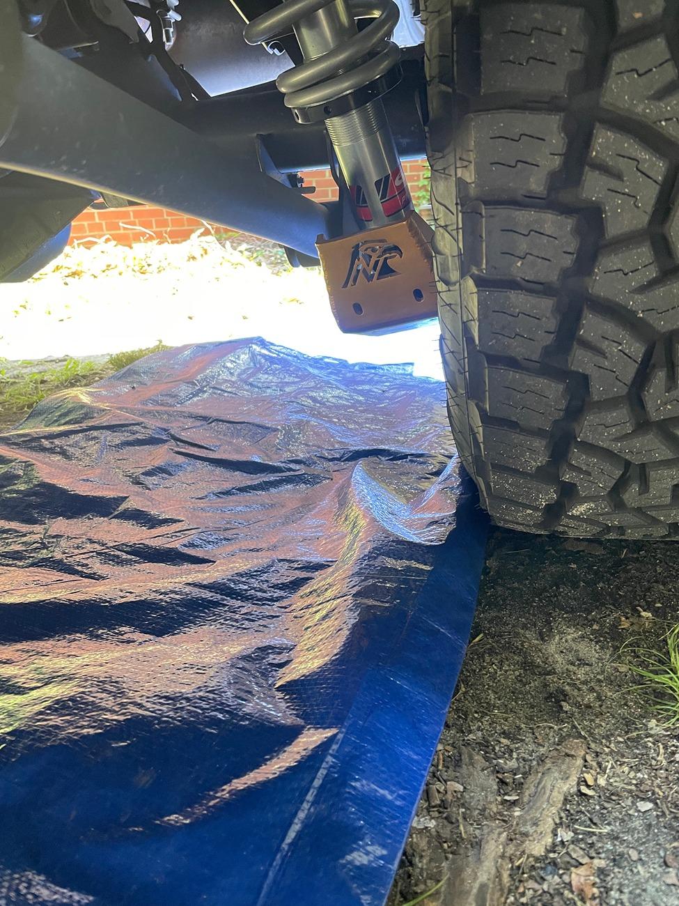

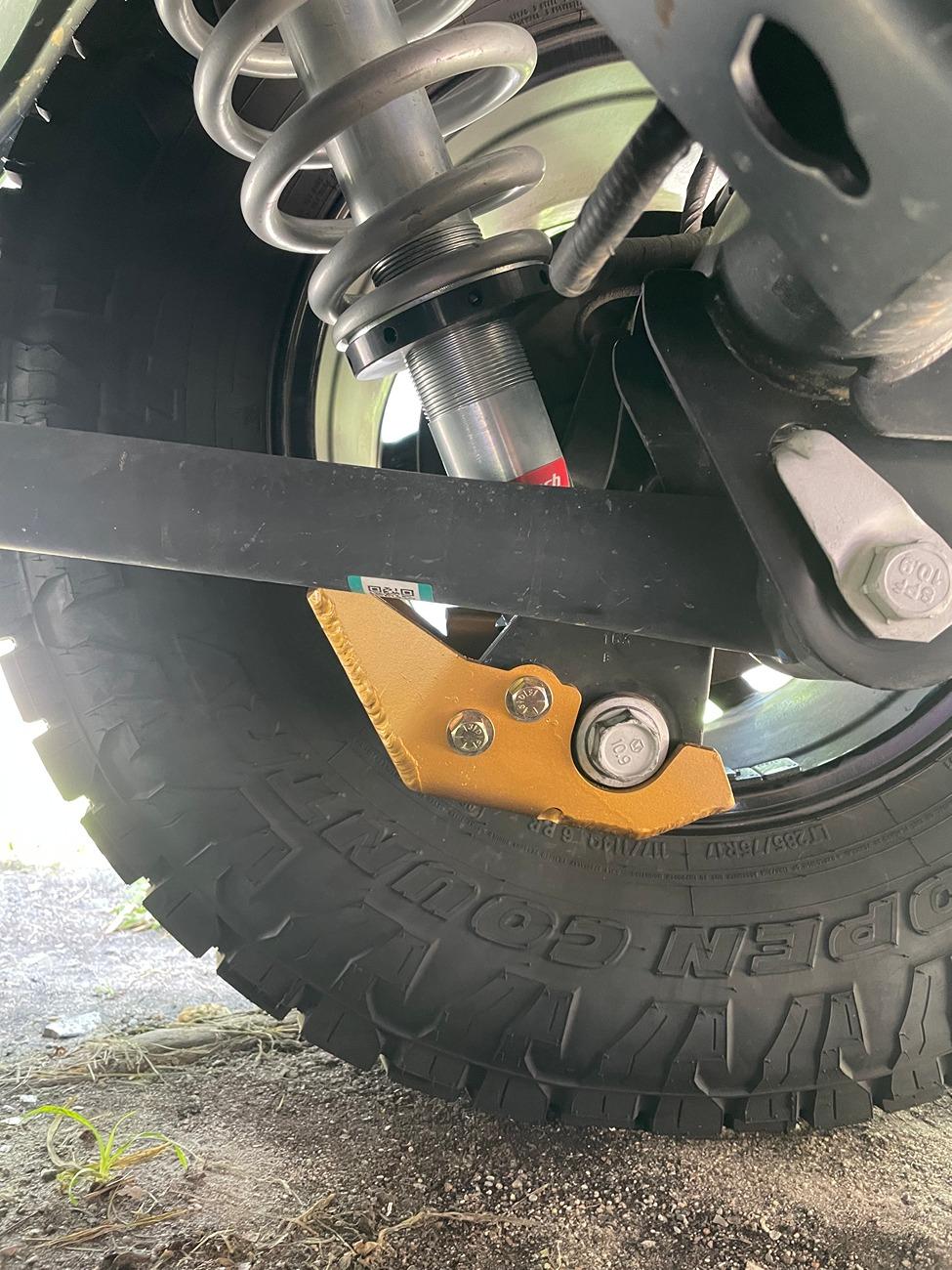

I just added the Next Venture Motorsport shock skids this afternoon. I first sprayed them gold to match some accent stuff I've done (yes, I know they're going to get scuffed). The fitting was tight as the item description said it would be. I was following the video instructions on how to rotate the skid to get it on, and it helped a lot. The only thing that would have made this installation easier would have been if it were 20 degrees cooler outside.
