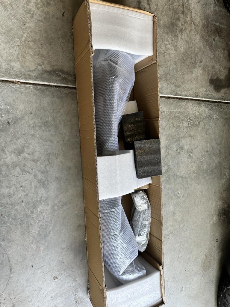

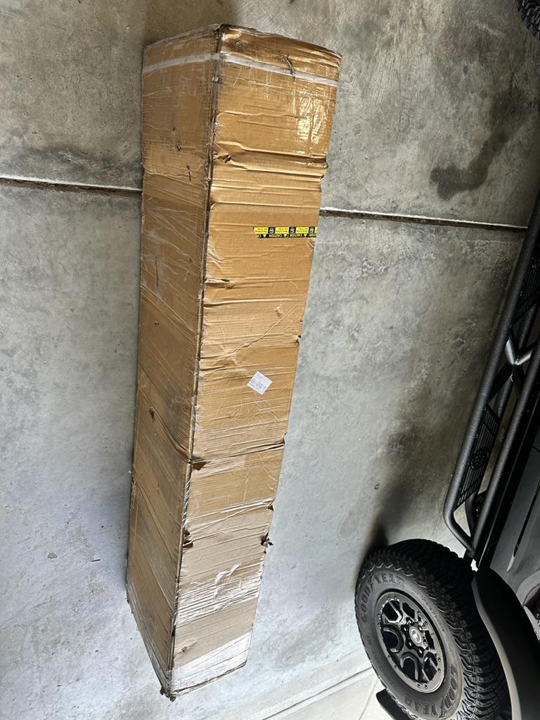

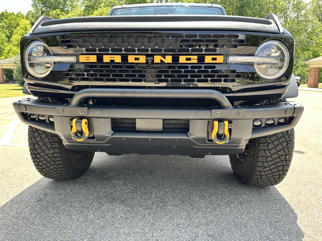

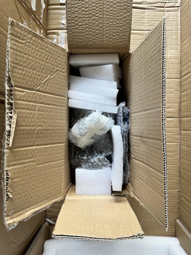

I took the plunge and bought one off eBay since I wasn't sniffing any locally. The trick is don't pay what they are asking, all the sellers have a "make offer", first vendor rejected my offer but the second took $650 with free shipping. Can't complain, quality seems to be decent as the OP pointed out. Packaging was good and the bumper arrived the same day as the estimated delivery on eBay. I had a mod bumper on my 2dr BL, took the bull bar and Oracle fog lights off when I sold it. Both of these bolted right up no problem on the eBay bumper. And yes the end caps come off. I'll be curious to see the bumper side by side with a Ford mod bumper but man it looks really close. The one big difference is the bolts, they don't say "Bronco" on them. 😁
For installation I followed a video some guy posted on installing a mod bumper. I followed all the steps and everything with the Ford mod bumper corresponded with the eBay bumper so the internals were same. It does come with the plastic plug mounts for the sensors so I didn't have to remove them from the old bumper. It replaced my capable bumper which I guess I'll need to sell now. It's amazing how light the capable bumper is compared to the mod. I could easily handle the capable by myself but I needed the wife to help me lift and position the mod. It actually feels like steel.
