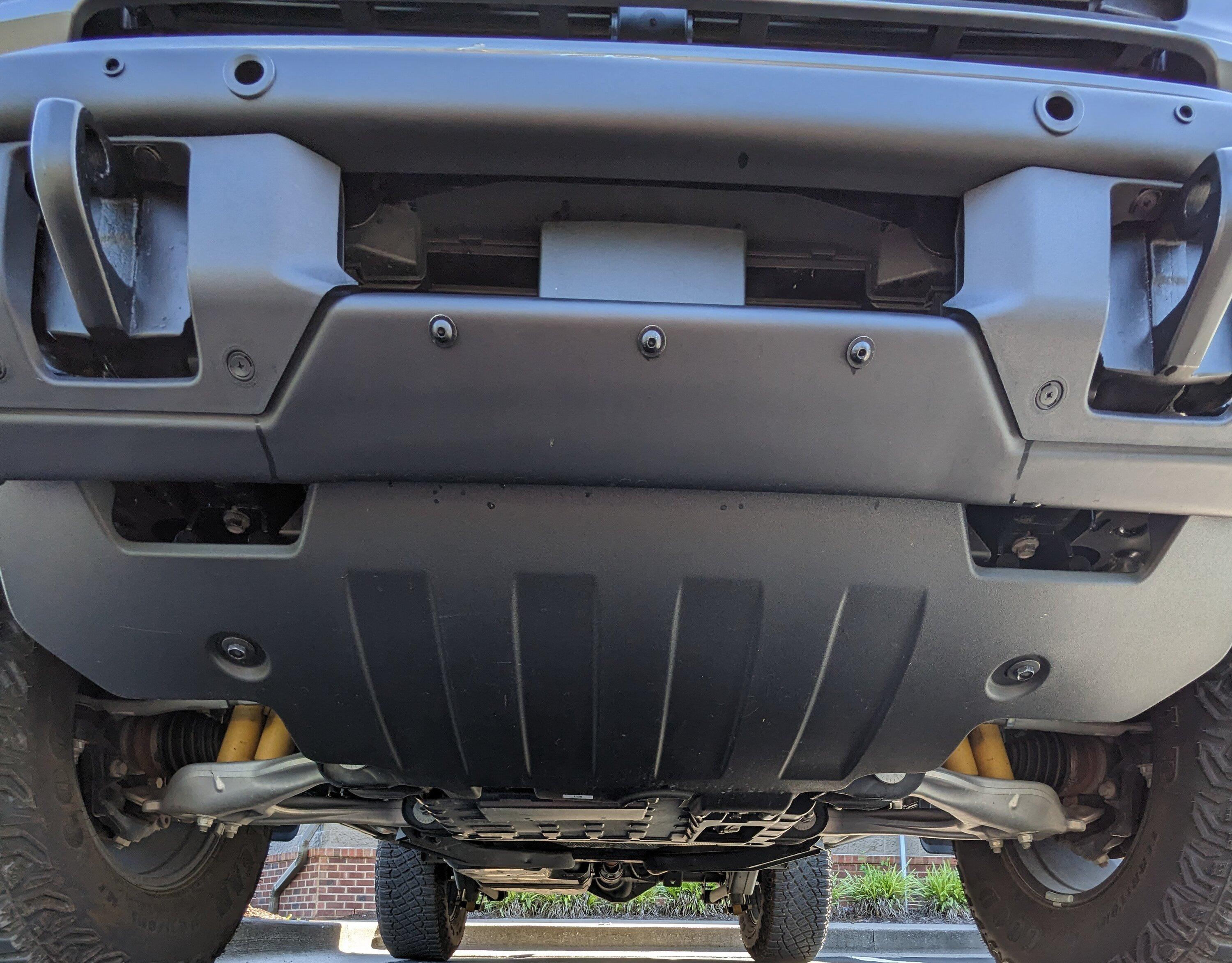

It's a very simple swap. Remove the plastic covers, remove four bumper bolts, remove wire loom and fogs, reinstall wire loom and bolt new bumper to frame. In terms of install time, probably took me longer to trim and reinstall the plastic skid plate but I'm anal about that kind of stuff.
Thinking about going this route if I can't find a take off. How much trimming of the plastic skid plate did you have to do? I'd be good with not spending money on a steel one. And I assume you had to cut or replace the base hooks?
Correct, cut hooks off with your tool of choice. You will need to trim about 8-9" off the skid, then bend/tuck up under the bumper and reinstall fasteners.
Thanks! If I can't find a takeoff by the time I get my new tires then I'll probably go this route.
