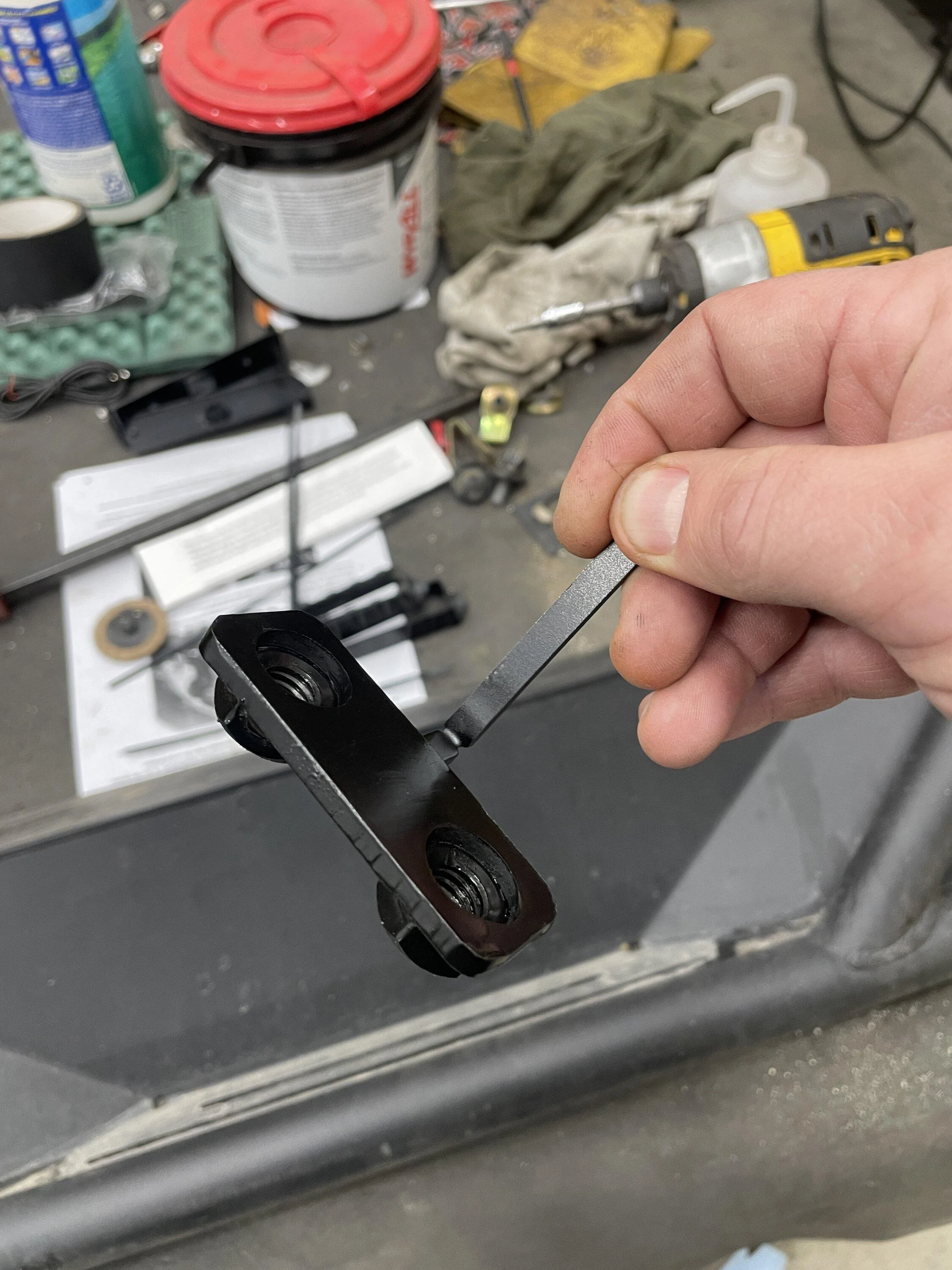

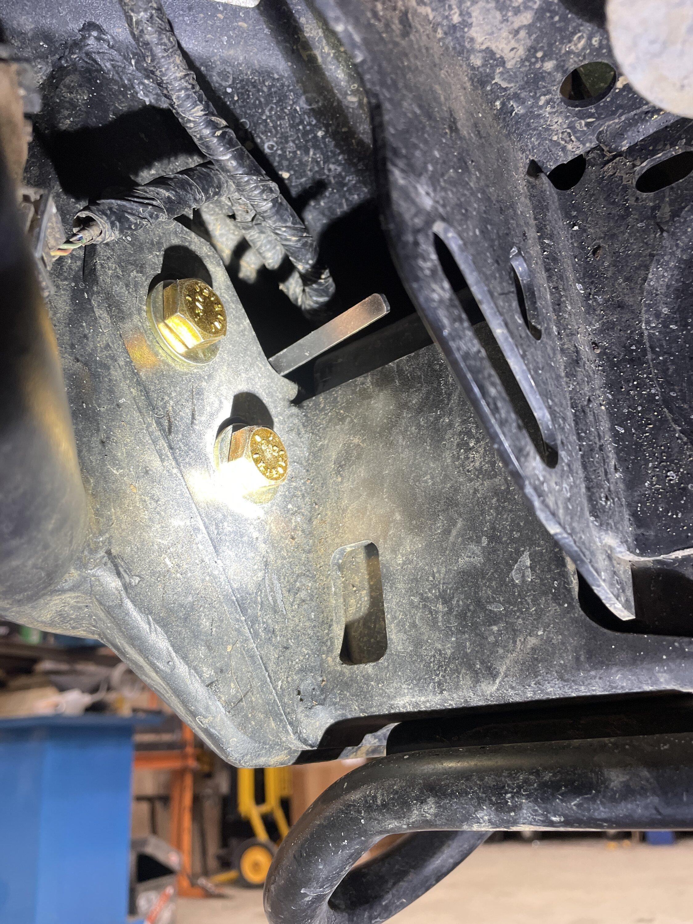

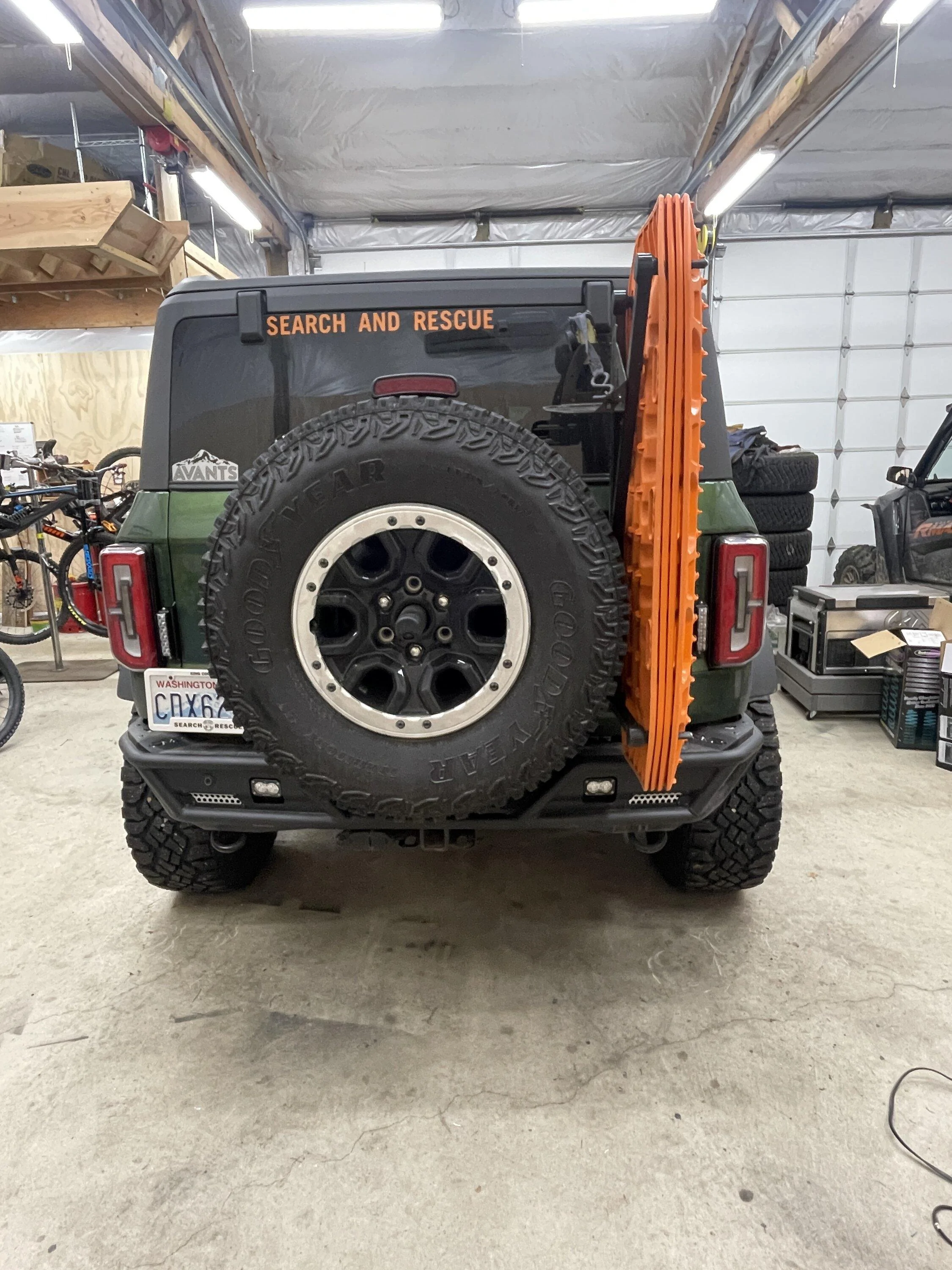

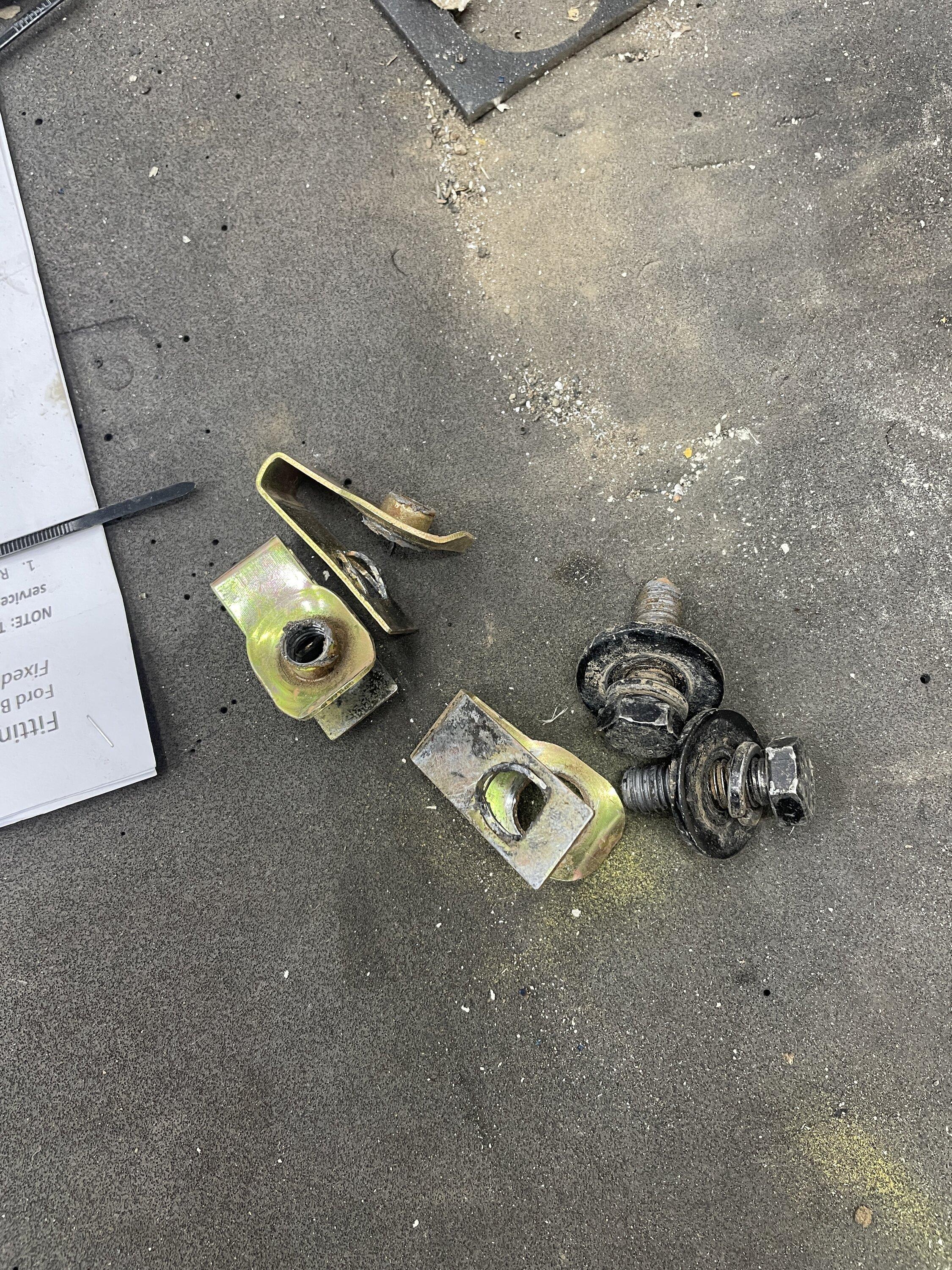

I have a DV8 competition rear bumper that has worked well for me except for the mounting hardware from the frame bracket to the bumper it self.

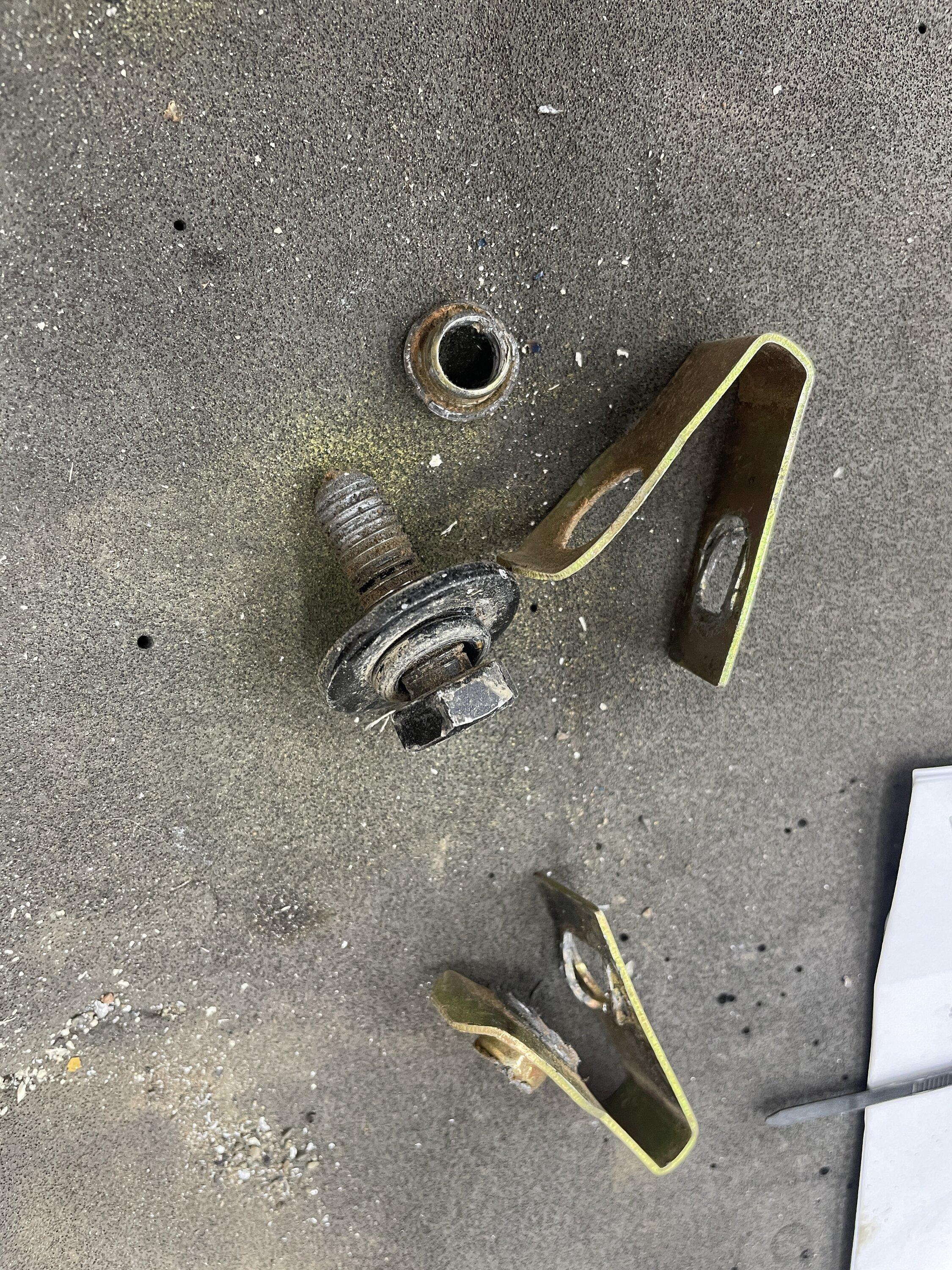

the stock hardware is ~8mm and uses speed nuts into the bumper to mount. The speed nuts appear undersized for the holes in the bumper and start to pull through.
Ford Bronco DV8 Rear bumper hardware improvement IMG_5184
Ford Bronco DV8 Rear bumper hardware improvement IMG_5182

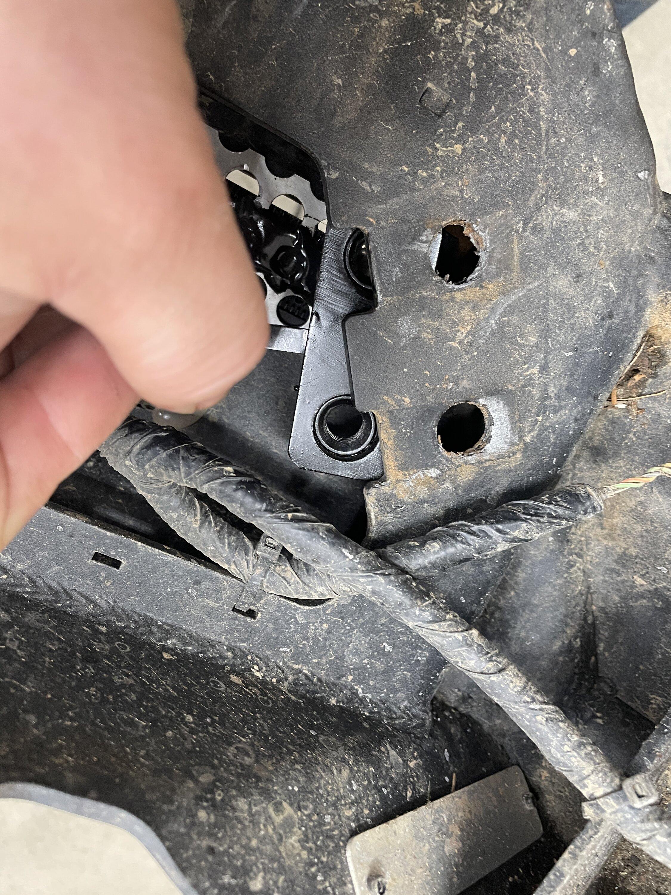

The holes are about 14mm in the bumper and bracket so I went with 1/2” hardware. Made up some nut plates I could drop in and fasten the bumper more securely. Hoping this keeps the bumper in place better when it encounters a trail obstacle.
Overall I love the bumper and it’s worked out well for me aside from the hardware issue.

Which bumper?
redone17
Mar 6, 2021
61
3,898
4,412
Cold Spring, NY
2021 Bronco, 2020 Ranger
Ah. Yeah. I didn’t recognize that from the FS-15.

So the bumper is held on with 4 8mm bolts from DV8?
correct. Keep in mind it has no recovery points on it (uses the stock ones)
